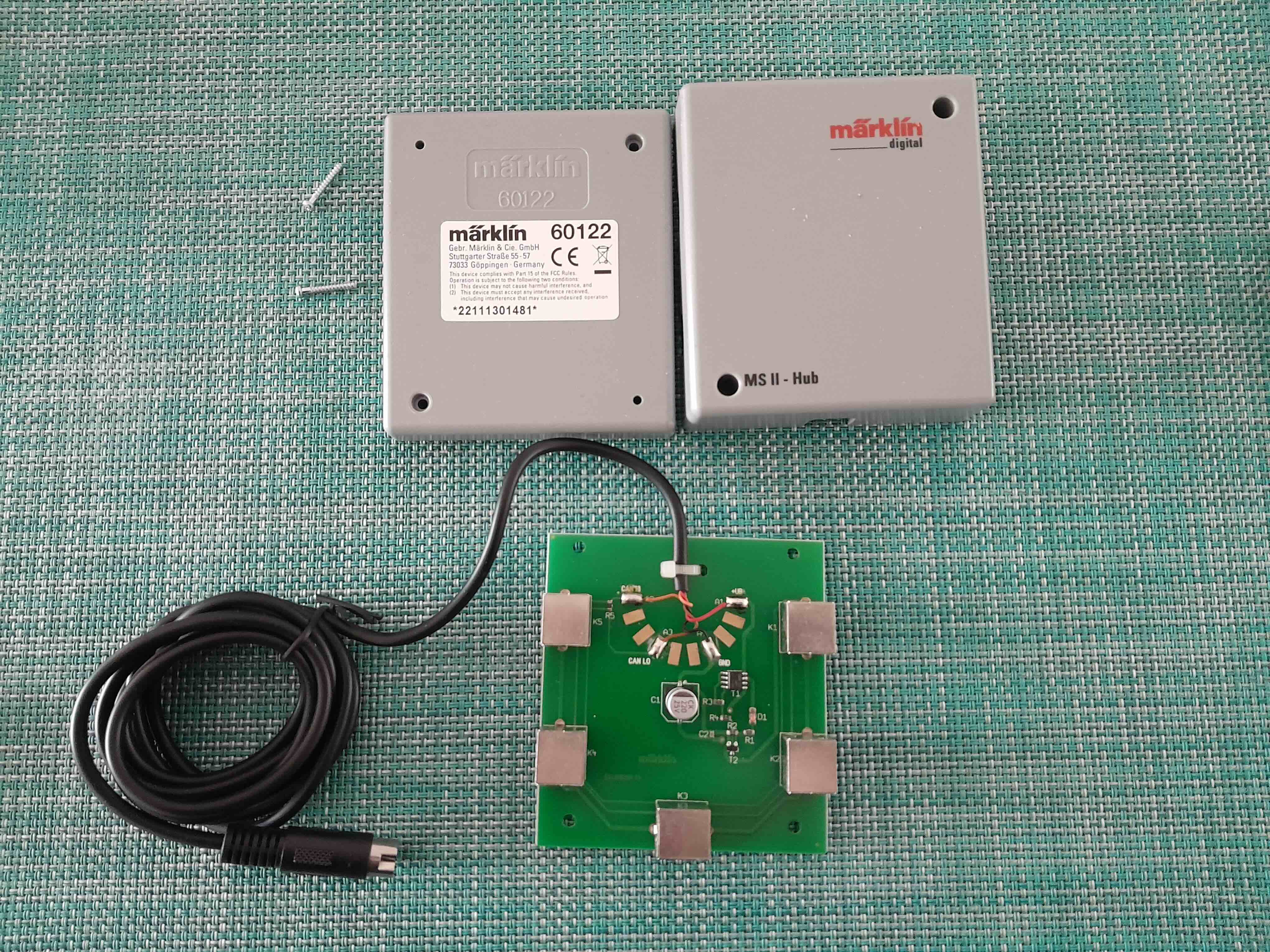

Dear All -
FYI, here are the guts of a 60122 used to connect up to 5 MS2s to one gleisbox DIN9 outlet. Not much inside except for connectors. It is a CAN bus expander, essentially.
Osoraku
