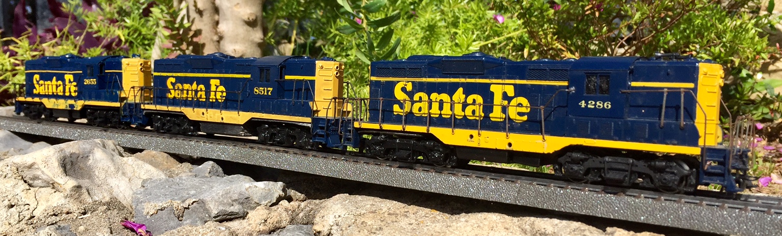

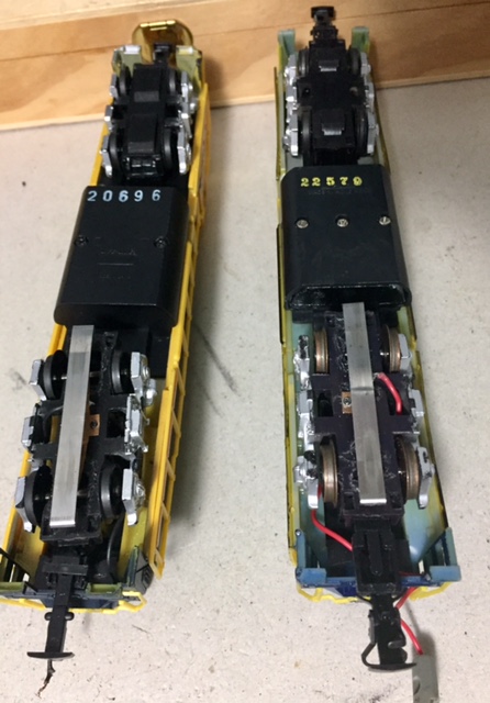

More power to the people. I had a go at two ordinary Life Like GP 38 two rail locos. While road no. 3600 was already born as a dummy, road no. 3500 was converted to one by removing the cog wheels and feeder cables inside the loco. Both are quite (but not too) heavy.
Then the useless humps were removed under the rear trucks to make room for a center-PuKo pickup shoe, respectively. Left = before and right = after, respectively:
The two dummies from below.
Road no. 3600 matches the blue and yellow war bonnet paint scheme applied to ATSF locos as of June 1972. In due time, road no. 3500 with the cheap, shrill and wrong paint mix will obtain a classic 1960s blue with yellow book ends paint scheme (with which the first GP38 batch was delivered to ATSF in June 1970).
The two SD 40 locos by Mehano received decoders, and I managed to adjust wheels and couplers, but I couldn't fit any decent pickup shoe under the six-axle trucks due to lack of space. Now Life Like dummy no. 3600 feeds them with center-Puko power. At least they can pull themselves up the hill, but I did not dare to haul a train yet. Of course riding comfort of the Mehanos does not match the one Maerklin locos offer.
Cable connections still to be improved.
Road no. 3500 is supposed to power other Geeps. To be continued.

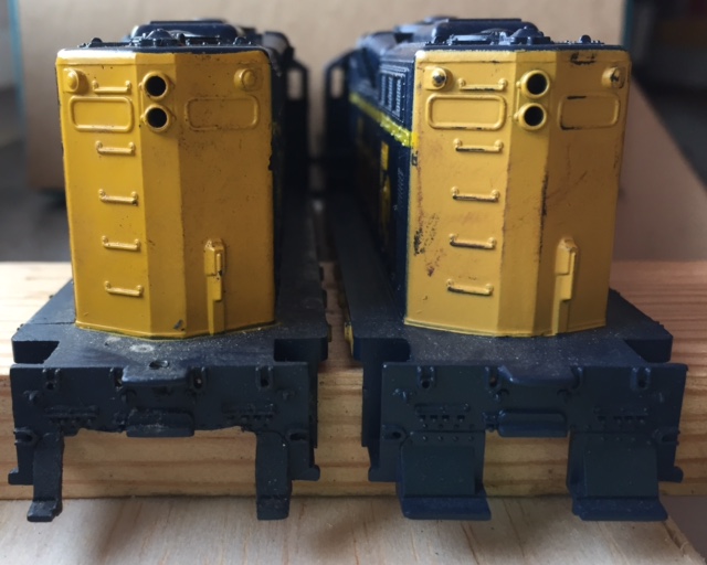

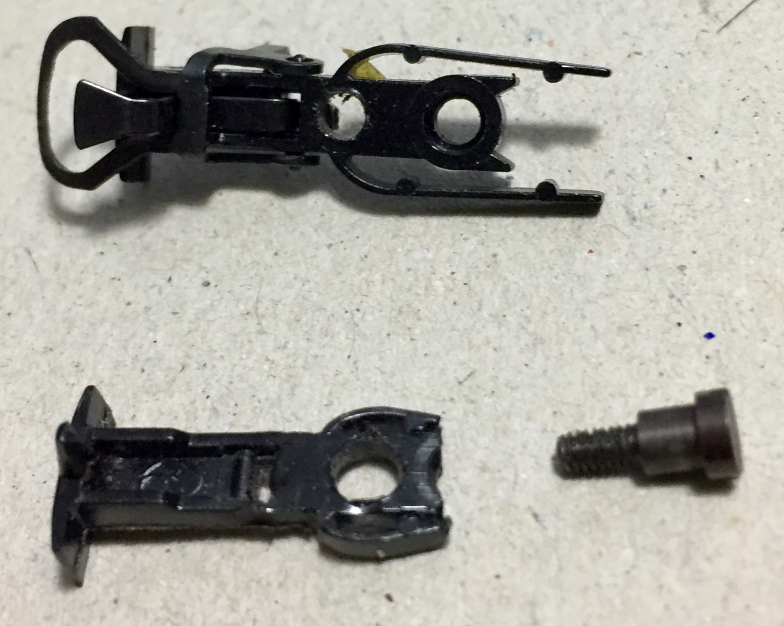

As I am happy with the six-axle Life Like Proto 2000 (P2K) EMD E8 described earlier, I converted a series of P2K four-axle EMD GP30 locos, two Santa Fe and one Rio Grande loco. Rewiring and decoder installation was a routine job. Finding a solution for the chassis mounted couplers allowing operations on R1 curves was more challenging.
A Maerklin 701570 coupler gets an additional hole where the "wings" meet. Excess length cut off for avoiding interference with loco truck.
The hole has the same size as the ones of the Maerklin draw bar. The Maerklin draw bar screw 753030 serves for fixing onto loco chassis. The coupler is now - like a draw bar - freely pivoting around the screw.
Procedure repeated at other end.
This is the one and only way to move a train through a R1 curve. The coupler moves with the curve. Only - and in my view unimportant - drawback: the coupler needs to be straightened manually before coupling.
Before obtaining a patent and starting industrial production, I will have R&D fix that via a spring mechanism, similar to the Kadee coupler box mechanism.
:o)

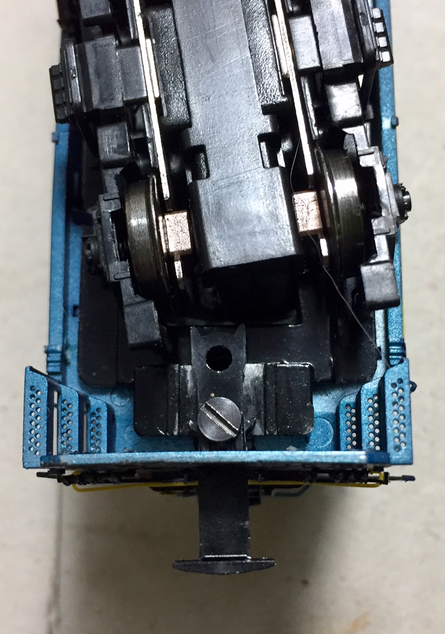

P.S: I do not want to destroy any truck or gearbox for installing a pickup shoe. The black cable dangling from the loco is to be connected to a second dummy unit which is equipped with a pickup shoe.
#53 Posted : 08 December 2016 18:22:49(UTC)
Posts: 6,064

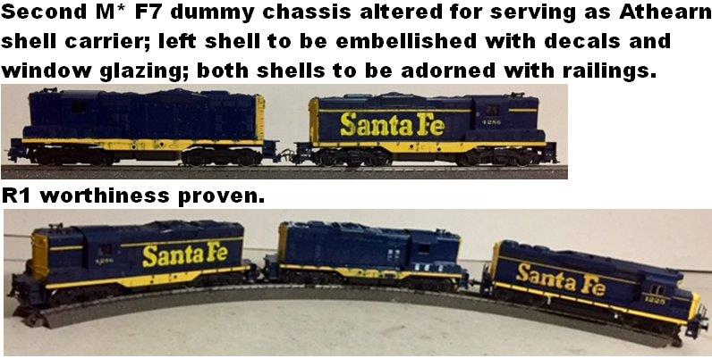

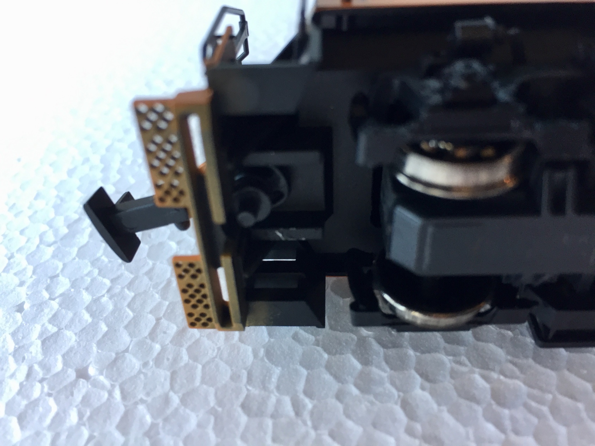

Regarding the dummy with a pickup shoe I am following two separate avenues.
(a) A Maerklin EMD F7 chassis has the same dimensions as a Athearn EMD GP7 (or GP9) one. While the motor sitting in or on a motorized chassis does not fit into a sleek GP body, a dummy chassis offers an alternative. To fit an Athearn shell with its flat veranda on such a Maerklin dummy chassis, the latter needs to flattened by folding outer ledges. The GP chassis is longer than the F7 one. Therefore, 215860 couplers (having an extended neck) are mounted on each side. GP front skirt openings are widened to allow wider swings on tight R1 curves. Right before and left after cutting.
Then one of the dummy trucks obtains a standard Maerklin pickup shoe to feed the motorized GP30. Here is the consist in action. The dummy is still lacking handrails.
(b) A Life Like GP38 dummy obtains a pickup shoe (see November 13 post). Again, 701570 couplers are manipulated by clipping their wings and pushing them into the existing coupler pockets. Finally, paint jobs are to be done. The Santa Fe version in the works (in the rear),

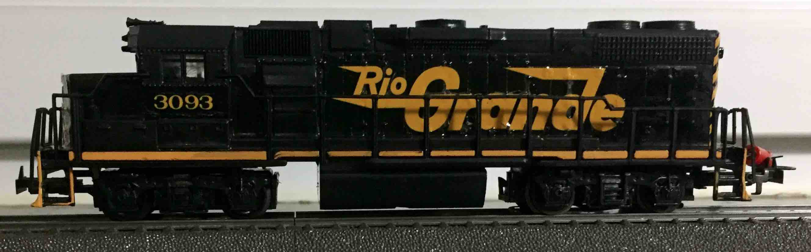

The Rio Grande version in the work (in the rear).
Unlike the Santa Fe, the Rio Grande did not own GP38 locos. However, they had GP40 locos with exactly the same outside dimensions, but with different engine (invisible) and therefore different roof ventilator combination (visible). We pretend that this is an early Rio Grande GP40.

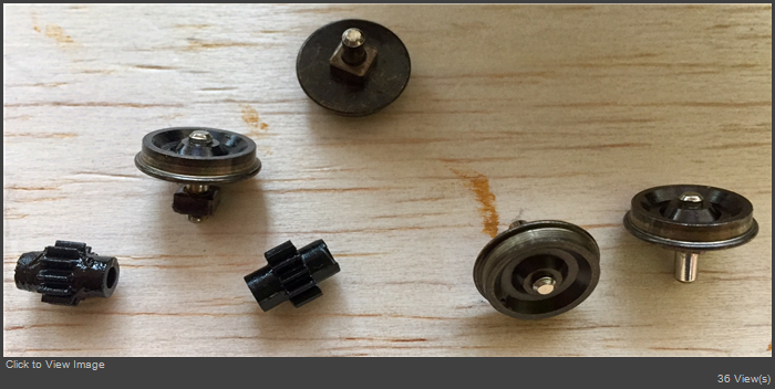

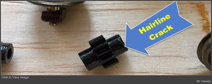

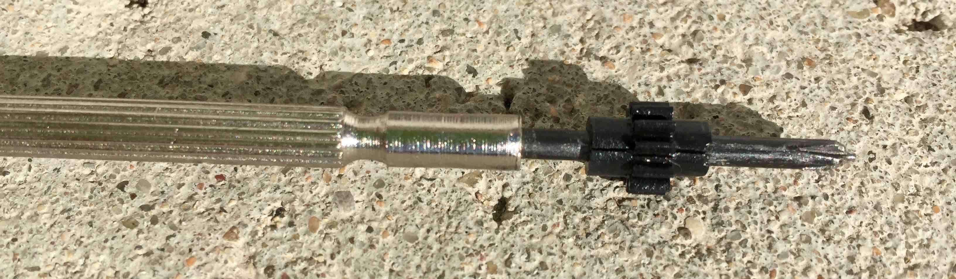

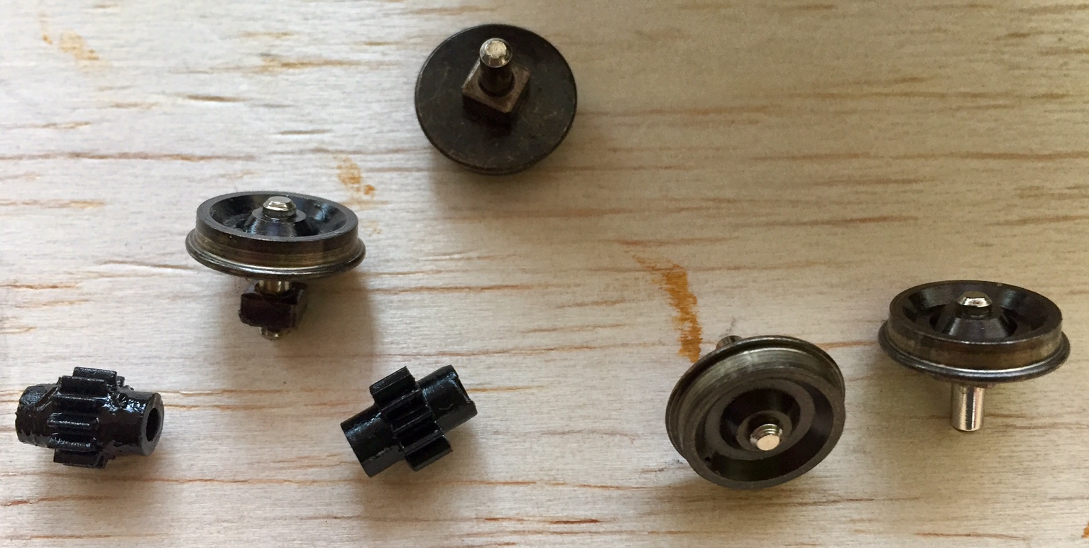

Then, one GP30 suffered from split cog wheels. How to fix this: Pry off truck side panels. Then carefully pry off bottom cover, using small screw driver.
Cover removed & right wheelset pulled out...
Existing wheelsets can easily be pulled apart, releasing the split cogwheels.
When reassembling with replacement cogs, make sure that the latter stay in the center, leaving some "balanced" slack on both ends for the square bearings. Repeat/adjust/redo until loco runs smoothly (annoying task). At the end: success.

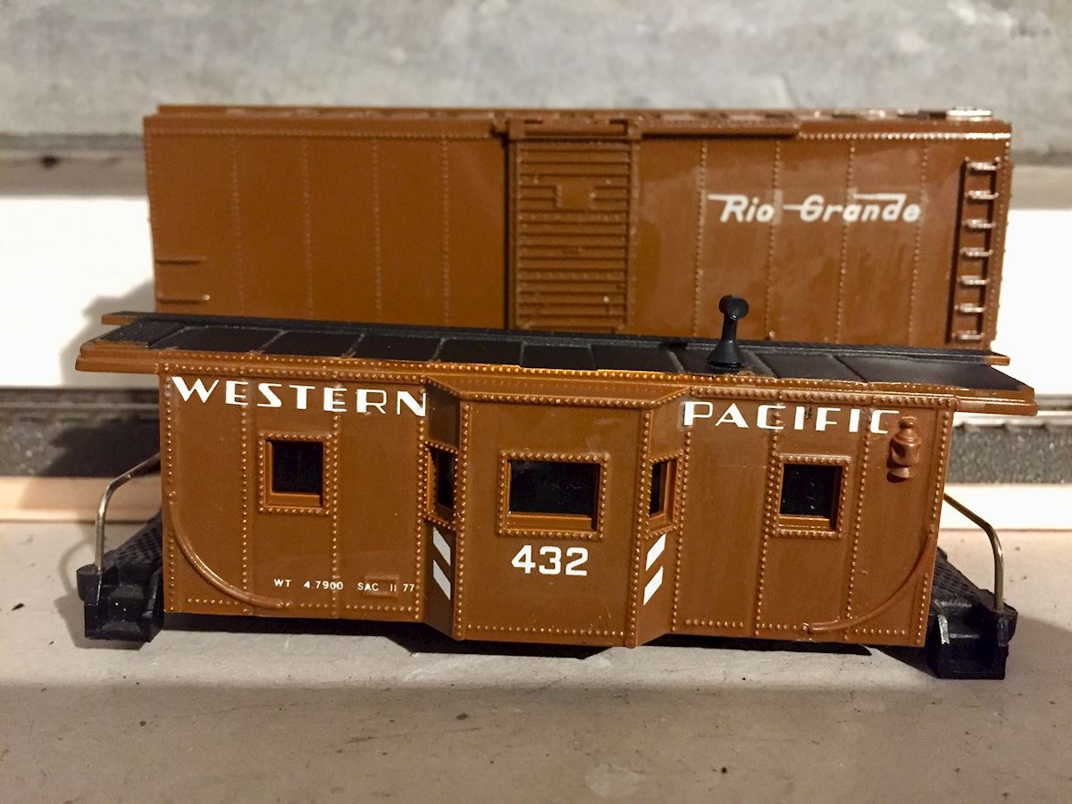

And to conclude the day, something more tangible. Life Like US freight cars run well on C track. Interestingly, Maerklin F7 loco couplers fit into coupler pockets of Life Like freight cars. Here is a short Life Like hopper coupled between two Maerklin ones.
Hi Ak,
I have owned about 20 Life Like locos of the type you are dealing with.
On all, I had to replace the split axle gear (cog), which had itself been cracked.
You cannot see the crack, just the loco does not behave to it's best, and clicks (jumps) along.
Terrible quality and a lot of work.
I had to wait 2 years for a batch of replacements to come from Walthers. Though NWSL (expensive) and Athearn (hard to get) replacements work for these.
Any chance of annotating the photo to show the split as I can't see it? Kimball has already answered my second question about how you would notice that part has split.
Thanks,
Carim

As Kimball wrote, it is very hard - if not impossible - to see the crack.
Thanks,
Carim
Hi Carim,
You cannot see the crack. As Ak says, it is hairline.
The ony way to see it is to prise open each gear by using a small round piece of steel (screwdriver) through the hole, and twisting somehow.
If it opens up.... there is a crack!!!!!
Not worth the effort, just replace every gear on a loco that displays the symptoms..... (clicking or thumping, mildly jerky or lumpy under power).

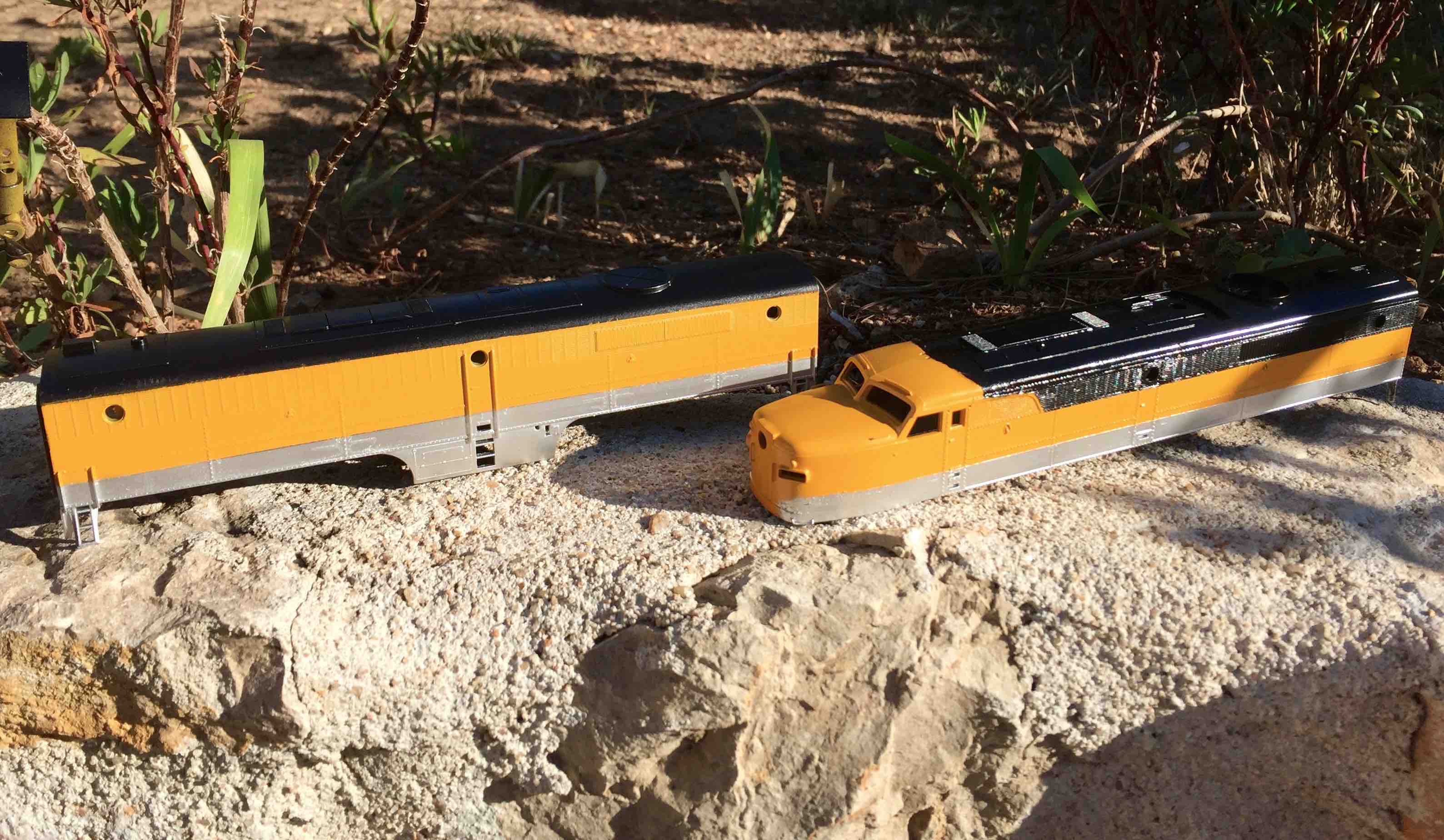

Alco PA and PB: First "Aspen Gold" and silver metallic applied.
And then the single black stripe added. The paint scheme is matching the ultimate looks of Rio Grande units 6001 and 6002.
Decals still missing and grab irons, window panes and horns to be mounted again.
RPO car in the making.

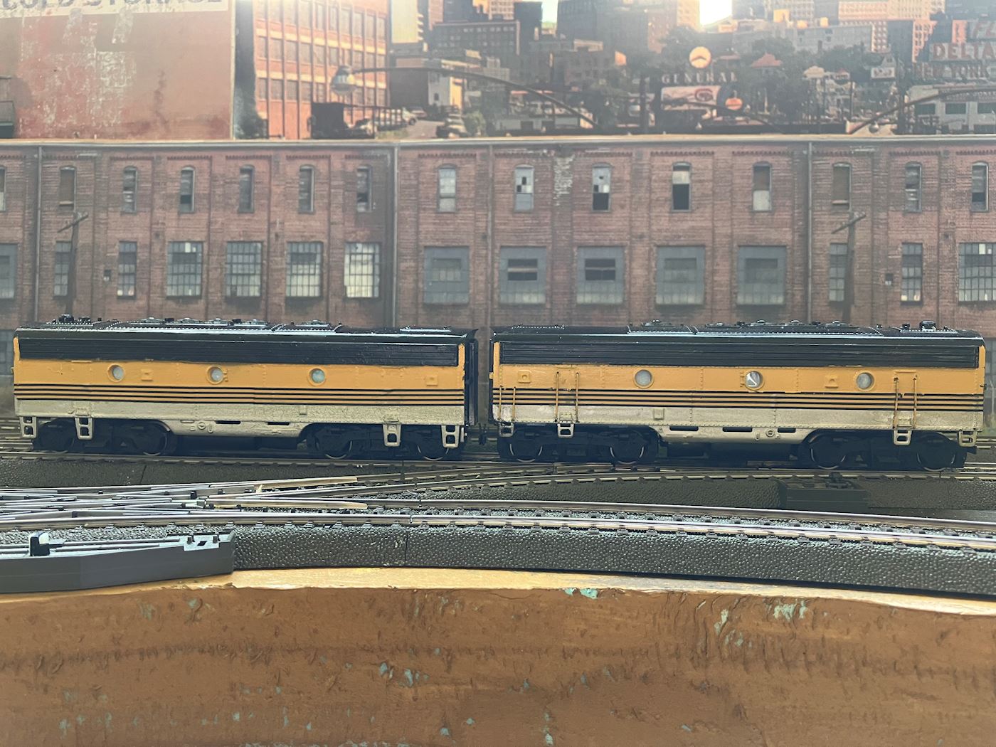

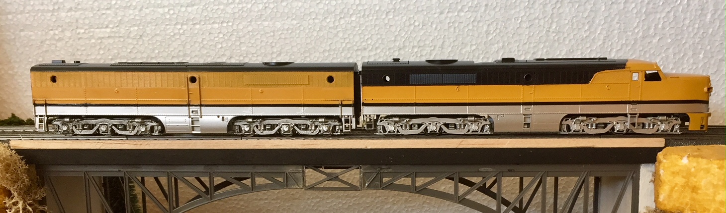

Alco PA and PB plus RPO car now with decals and detail parts.

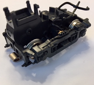

Alco RS2 by Kato conversion perfected by finally installing a flawlessly working pickup shoe right under the front truck.
Credits for the following works go to a trusted MU forum member, who might want to come forward?
Cog wheels out, bottom plate gone, styrene plate glued into place (and painted black) to create basis for pickup shoe. Drill hole into said plate and fix pickup shoe with center screw.

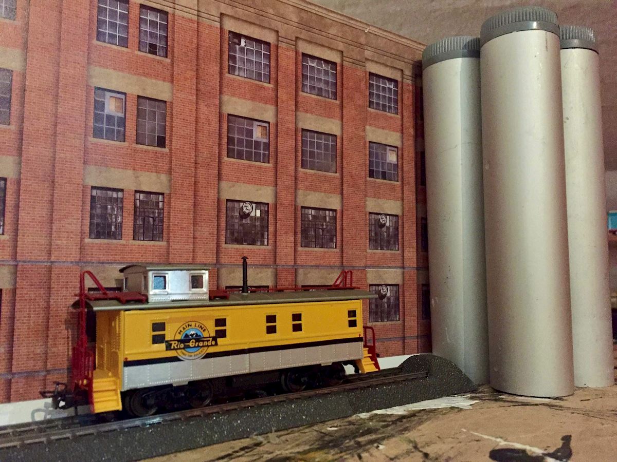

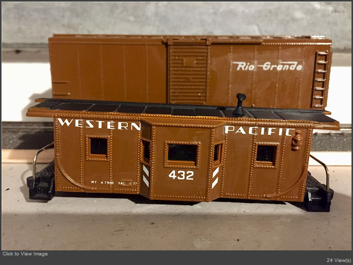

The Rio Grande caboose evolved.

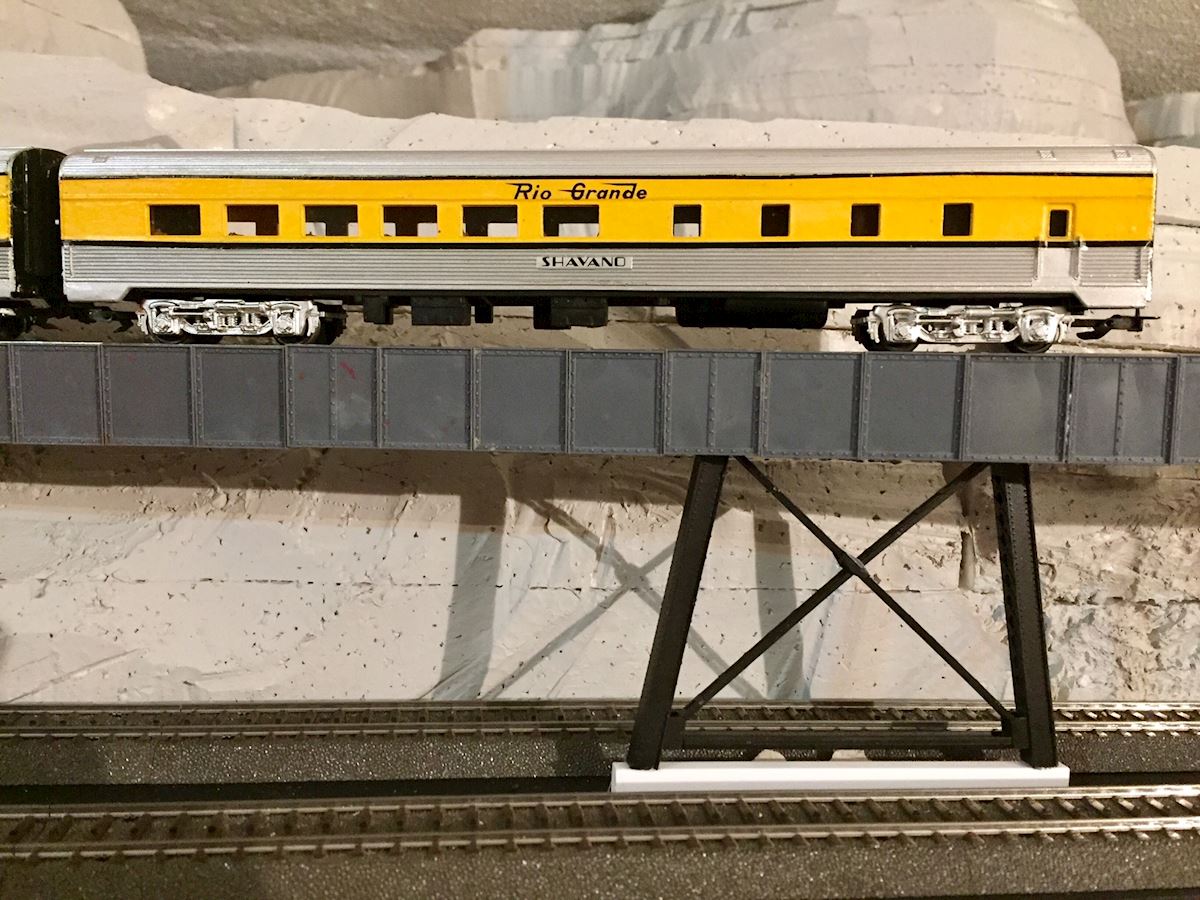

1960s Rio Grande lightweight passenger cars.
Baggage car 1210
Coach 1240
Diner/Lounge "Shavano" (not a prototypical name, but the others were too long for the plate...).
These are re-painted Santa Fe coaches by Frateschi. I used Microscale #87-577 Ski Train decals (one set suffices for three coaches) since there is no alternative on the market.

And since I had the silver primer ...
...and box car brown paint at hand.

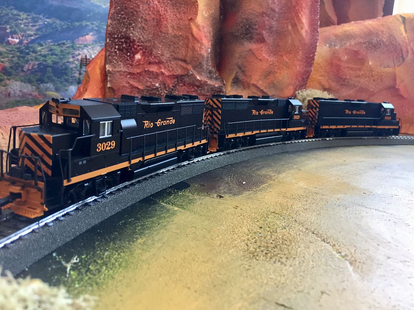

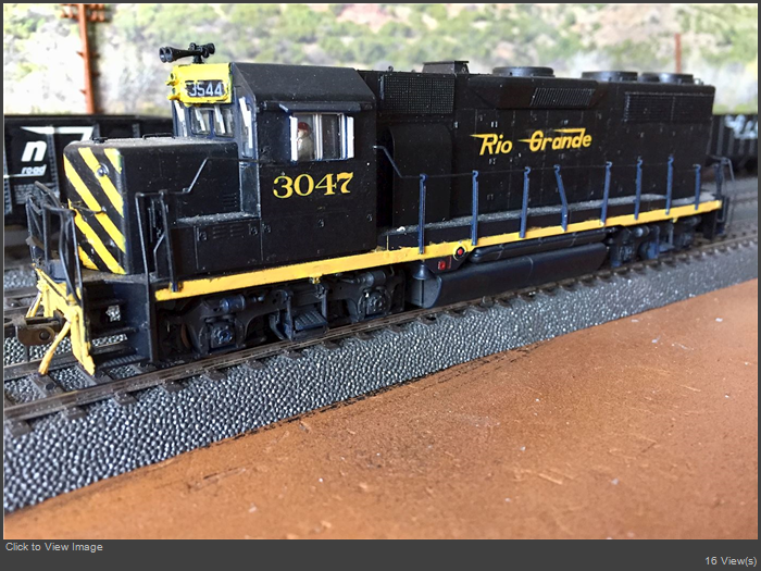

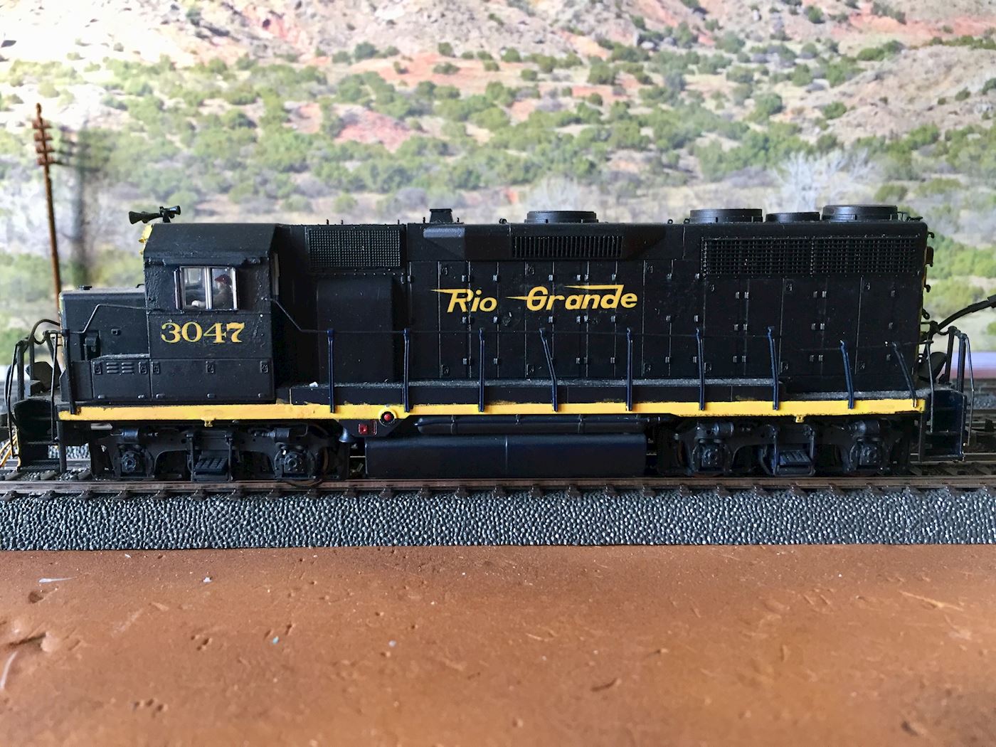

Roco-made Rio Grande GP40 (marketed by Atlas) in front, rewired and decoder-equipped; puko pick-up shoe in trailing LifeLike dummy (introduced in above posts #53 & 64) feeding power to motorised unit via thin black cable - see:
https://www.marklin-user.../t41332-1-pin-connectors
The wheels are behaving, but traction is disappointing on ramps. I ordered Bullfrog Snot „liquid traction tyres“, hoping that the latter will improve the situation.
P.S.: Being a Wild West railroad, Rio Grande’s lettering colors actually varied in all shades of yellow/gold/orange over the years.

Painted a glaring red Mehano CN crane to become Rio Grande big hook 028. I guess I matched the ramshackle maintenance-of-way equipment looks.

The Rio Grande F-types wore various liveries during their tenure. The Maerklin F7 is sporting the latter day single stripe version introduced in the 1960s. I painted four units to reflect the 1950s four-stripe livery.
My creation above the Maerklin one. Both versions are prototypically correct and co-existed side by side.

A Western Pacific (WP) caboose for my WP diesel.
Box car brown paint, WP decals, glazing and Maerklin coupler.

Cool! WP has always had a **special** place in my RR heart!
It had just been purchased by UP when we arrived in San Francisco in the early 80'S
Incorporation into UP was underway but I still had a chance to see a number of engines in the old UP livery , some of them switching in the yard in Fremont .
And I'll never forget the stories I heard and read about the Cal Zephyr, and above all my visit to the Portola WP Museum where I had a chance to get at the controls of a Silver/Orange F7 and a dark green GP9 for a run around the balloon track!
Then we drove the car several time through the Feather river Canyon route and finished with a ride from the Railfair in Sacramento to Portola on the UP "Shipper's special" in 1991.
At the point were UP 3995 and UP 844...
Geez! Where did all the years go?

#95 Posted : 01 September 2020 18:13:19(UTC)
Posts: 6,064
My ultimate locomotive conversion project: 3x Kato GP35
When starting, I faced the following:
- Not much space for a decoder in the shells.
- One of the truck gear cases to be “disabled” for installation of the pick-up shoe.
- One decoder could feed two motors, but AFAIK not a third one.
- Locomotives delivered with Kadee couplers.
So, I decided to have a three-loco consist with two motors controlled by a single decoder, equaling eight powered axles. Wheel spacing was reduced to Märklin standards. The loco in the middle saw its power train dis-connected with the idle motor remaining in place as ballast; one of the trucks - without cog wheels - became the pickup shoe bearer: a 0.250” Evergreen strip serves as a base for mounting the pickup shoe; thin black cables with tiny male/female plugs (allowing connection/separation of the locos) provide power to both motorized units. I left the Kadee couplers “in the middle” connecting the three locos, but mounted Maerklin coupler hooks at the front and rear of the loco consist. The loco consist instantly mastered R1 curves as well as slim and not-so-slim turnouts, but the dummy derailed on wide-radius 2477x turnouts and crossings. The pickup shoe was the culprit. I reluctantly mutilated the central “fixed” cog wheels remaining on the two former driving axles (no way back to DC there anymore...) under the pickup shoe, which finally solved that problem, too.
M*-compatible coupler hook fixed with the regular pin.
Pickup shoe; the white beams (still to be painted black) are needed to hold - in the absence of the removed axle retainer - the truck sides together.
Feeder cables and Kadee couplers (trip pins bent upwards with pliers to avoid C track center stud contact).
The trio
#96 Posted : 02 September 2020 10:31:20(UTC)
Posts: 6,064
I believe I did not report this paint job up to now:
A former B&O MTH GP35 for M* "AC" became a Rio Grande.
I painted the Zebra stripes myself instead of using decals.
Of course road number and speed lettering are decals.
P.S.: Oops, the merciless camera lens reveals that one of the axles is derailed...

Three years ago I bought paint to “make” two Rio Grande paint scheme EMD F-Type B units. Now I have finally painted and decaled both shells. I think they look pretty battered as if they spent a long time in freight service.
RollEyes
According to the Microscale decal sheet instructions - citing photographic evidence documenting the situation at a given point of time - the roof of a four-stripe version was black, even though Rio Grande fan sites report that four-stripe F-units were originally delivered with aluminum sides and roofs. However, as the Rio Grande fleet concurrently carried a great variety of paint schemes, including the earliest, intermediate and final schemes, I followed Microscale's guidance.

Well observed: Yes, indeed. The left one is less detailed (while the right one has separate flimsy grab irons), but more pleasant to deal with in terms of painting and applying decals. On the inside the finishing of the left one is smoother, and the plastic of the right one seems to be a little bit brittle. Outer dimensions and roof details are identical, while ladders differ. I guess the left one is a generic Athearn model, while I am not sure about the right one.
#100 Posted : 29 June 2025 21:13:13(UTC)
Posts: 6,064
And I used my remaining four-stripe decals to create this Märklin B-unit shell version.
