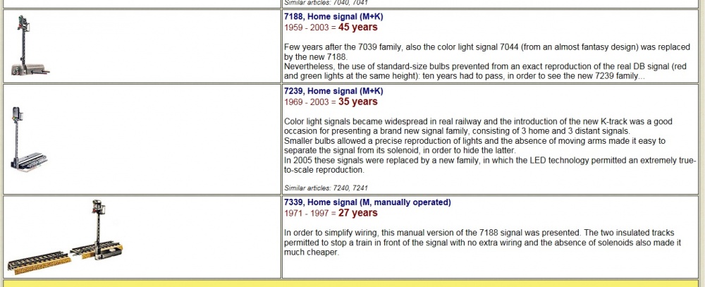

Ok, Ok, I found this image
7339 is a manually operated cheaper vesion of the 7188.
And the yellow cable just power the lights.
Phil

When it was introduced in 1971 the catalog said it was controlled "by manual operation and control the current to the center stud of the piece of track connected to the signal" and "sold with the "additional piece of track 3-1/2" long, with interupted (sic) center studs". So to have a block section at the signal one needs to use both pieces of the track shown in your image; additional tracks can be placed in between I suppose for a longer block. I hope that helps some.
Brian

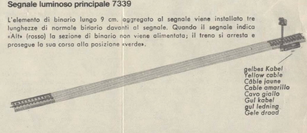

So I can create a complete parking line of track to park a complete train !
See this thread on the forum. Sorry for not discovering it before .
Thx phil
