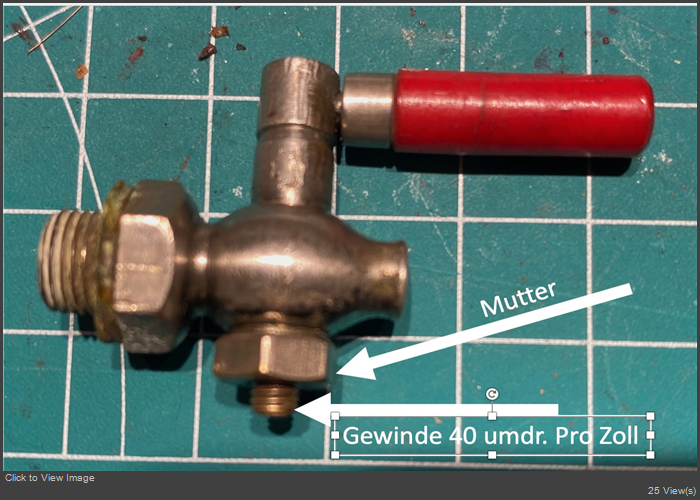

Thanks a lot for your comments and thoughts, guys. What I really wanted to know is where one can find those Märklin nuts, with internal thread of 40 TPI. I tried both BSW1/8 and UNF Nr6, both with 40TPI internal gauge, but none of the fit the diameter of the bolt (is true for the valve shown below, but also for the fixing screws in the machine).

Hi Bob
The Marklin engines used metric threads, the information given are imperial thread systems and definitely won’t work on marklin engines. For example I have a 16051 which is a unit made in 2004. I also have a 4158/91/7, the thread on the water fill fitting is m8x.075 pitch on the later unit, and m8x.08 pitch on the pre war unit.
The threads on the water valve are m3.
Hope this helps.
