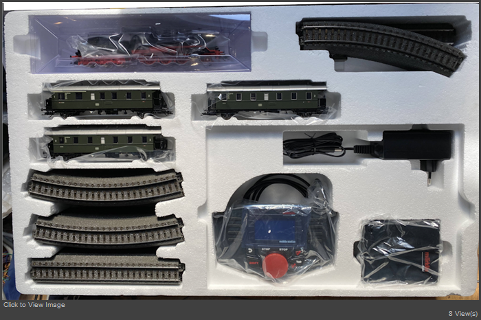

Lasdt year, I purchased myserlf a 29243 starter set
https://www.maerklin.de/en/products/details/article/29243
The loco and cars are beauties, finely detailled and there is an oval with 2 points
Here is the train in question

Hi all
Great thread. I am in the same situation as Susan, so all the good advise in here are greatly appreciated.
I have a good number of old M tracks and a starter kit (Märklin 29532), unfortunately with a MS1, from which I will try to
build a layout (including getting a MSII)
I have 2 locos converted to digital, and 2 more waiting.
My question is, can I use the old electrical turnouts, if I get a decoder for them, and is there a descent guide following with the decoder?
If I want to digitize the layout over time, is it possible to run some tournout with switchboxes and others with decoders if I use a powersupply only for the non-digitized turnouts
/Carsten, Denmark

Yes. Any turnout you wish to digitize you can use the Märklin M83 decoder. It suoports four switches per decoder. You connect the yellow and two blue wires to this M83 box and also the track power.
-Eino

So I don't need the Märklin 74462 decoder for each turnout or have I misunderstood you. I know I need the M83, but I also thought I had to get the 74462.
/Carsten

No, it is one or the other is required. They both perform the same function.
However if using an ms1 controller, this will not control points and signals, but the ms2 can do so.
