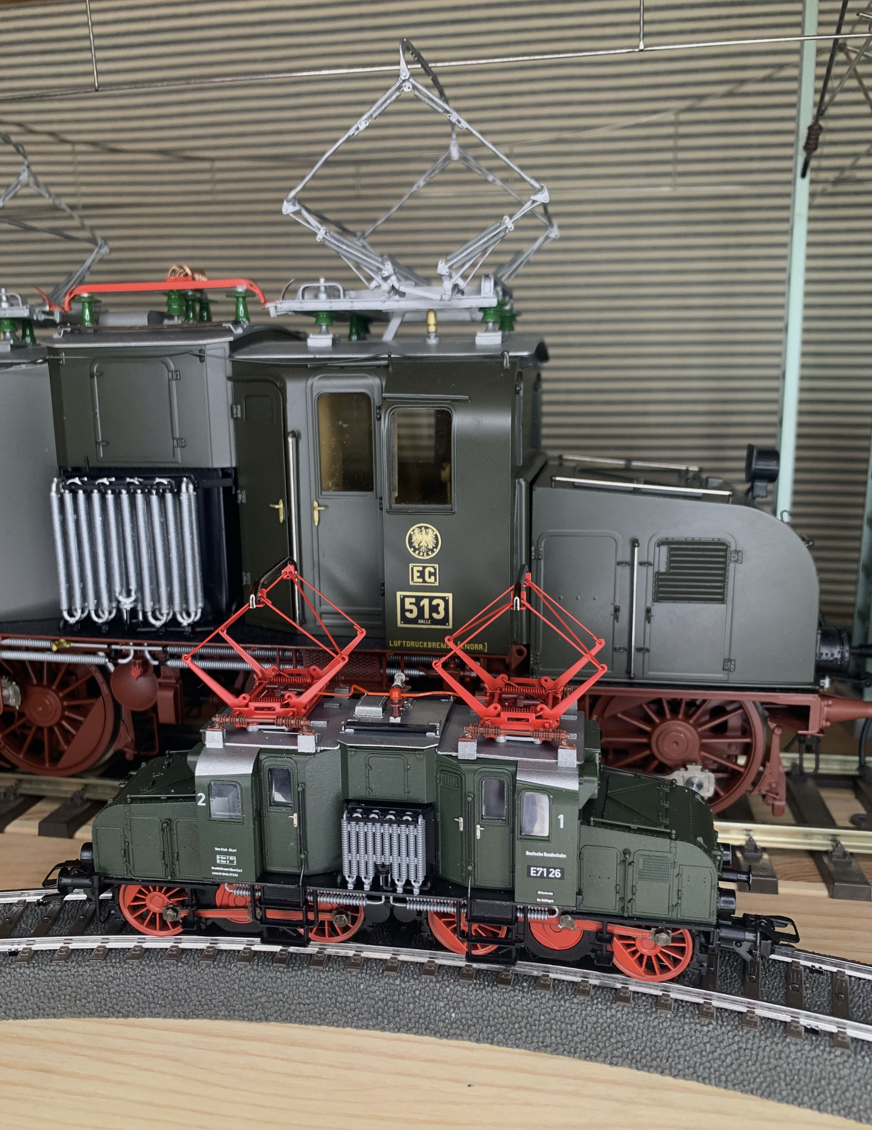

No I didn't get the wagons. But yes, I love the locomotive! Ligting the engineer's cabs individually, nice! Running with F18 rail joints with operating sounds off, quite nice! Comparing it with my scale 1 model from Fine Models shows what they need to emphasize on when they go down in scale:
Märklin E71 H0 and Fine Models E71 1-scale
(Isn't it possible to upload pictures, do I have to have ref by a url?)
