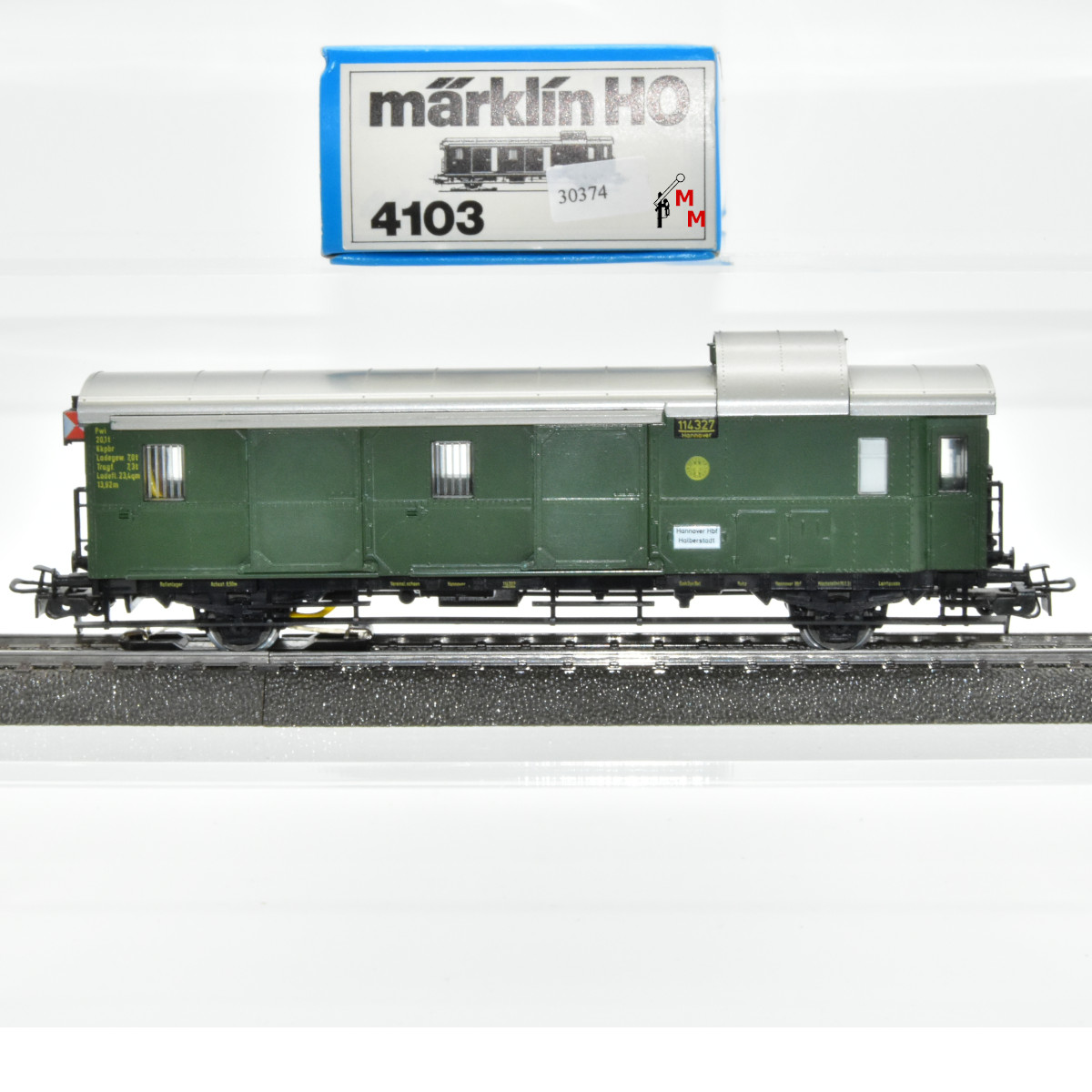

The Pwi wagon example in HO showing the recessed end doors #4103.
With acknowledgment to Michelstaedter Modellbahntreff:
4103

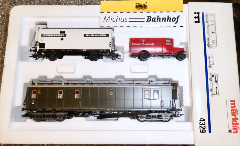

Maybe I will get around to it one day and run it with my excellent #4329 Post set for era II.
With acknowledgment to Michas-Bahnhof:
4329
