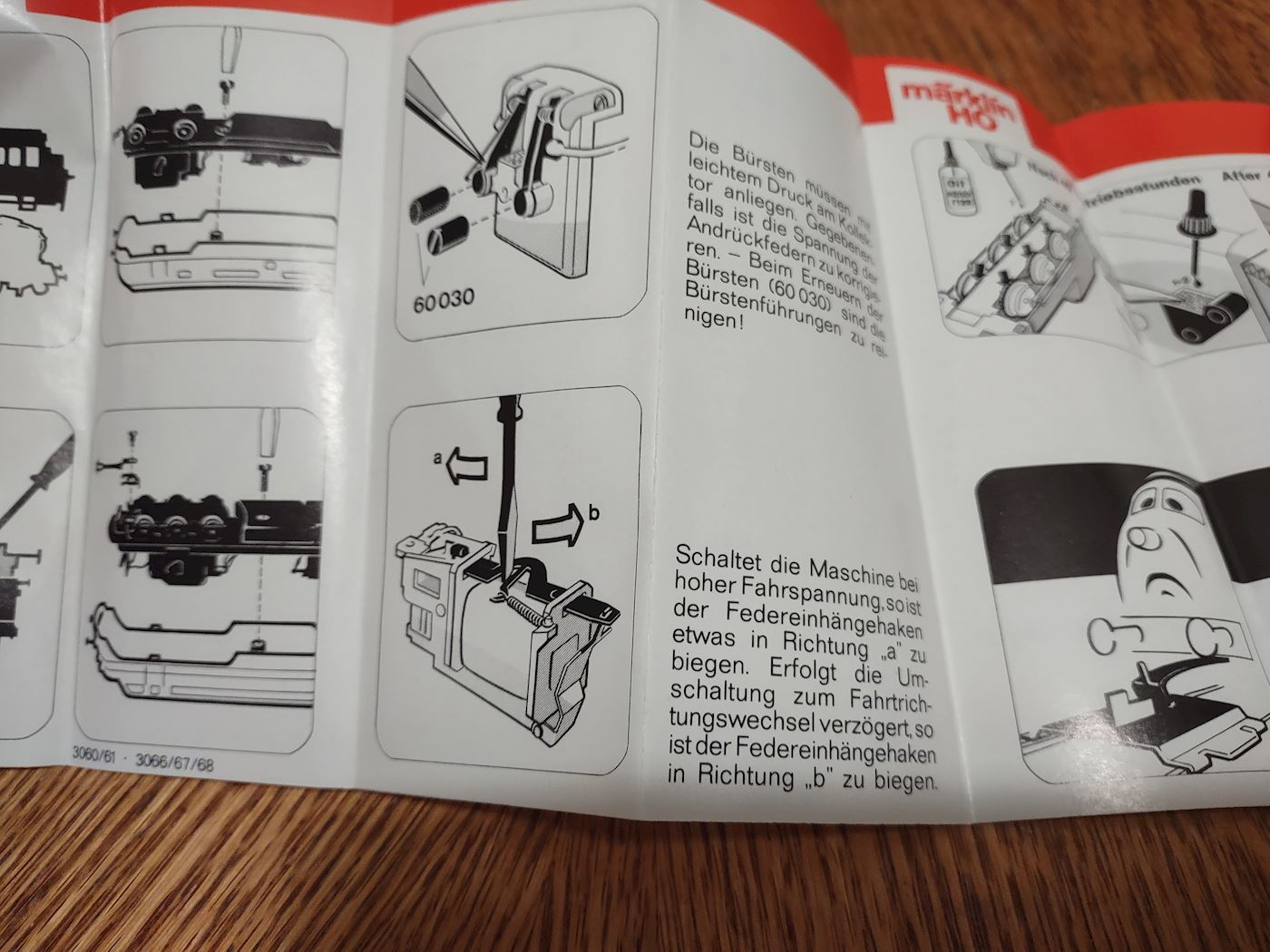

Offline Donb
#5 Posted : 28 November 2022 17:44:04(UTC)
Donb
Joined: 03/04/2013(UTC)
Posts: 310
Location: Fraser Valley
Sounds to me like the toggle spring return force is out of adjustment. Look for the arm where the spring ( item 28) attaches to on the toggle, and take a screwdriver and carefully bend that arm backwards to reduce spring Force or forwards to increase spring Force on the toggle. Only make small adjustments at a time and try it and see if that doesn't fix the problem.
A post a photo but I'm away from my trains right now.

Offline Donb
#6 Posted : 29 November 2022 05:38:24(UTC)
Donb
Posts: 310
here you go:
