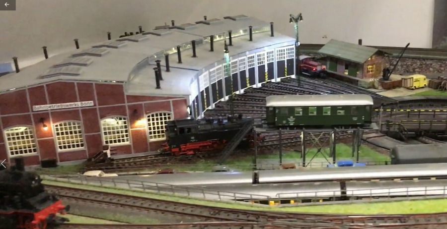

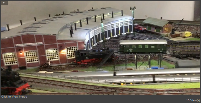

On my steam depot I had Brawa lamps, beautiful but with regular bulbs that kept burning so I installed surface mounted LEDs from an adhesive LED tape and enameled thin copper wire for cabling. So it went like this
