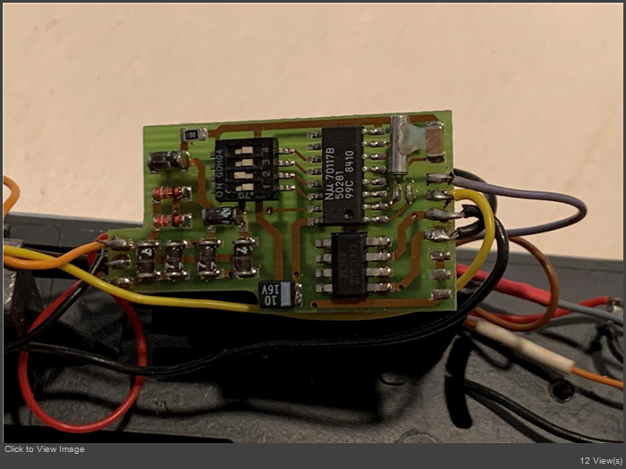

Thanks for your replies, everyone. Here is the photo. Switch 2 is on, which I guess is 74. Perhaps I am not programming the Mobile Station properly?
@marklinist5999: yes, I am in Washtenaw Co.
thanks 1 user liked this useful post by nyimpe
#7 Posted : 05 March 2022 16:21:47(UTC)
Posts: 4,109
That's a Delta decoder. I'd try a different address, see if the MS will find it by the dtatbase. If not, try manually changing it to the new one in the MS.

Check voltage in on decoder (red and brown wires) while train on powered track. Set dips off and on again, as age affects contacts. Set all 4 switches on, which is default address 80 for Delta (all off is analog mode).

If I set all dip switches to off, it works as analog. But if I set them all to on, it also works as analog. Do you think I just need a new decoder?
#13 Posted : 09 March 2022 09:54:10(UTC)
Posts: 15,544
May yes, maybe no.
The decoder should work in analogue mode with any address setting, assuming it has "automatic system detection", which not all Delta decoders have.
Maybe there is something wrong with one or more of the DIP switches, maybe the decoder no longer works in digital mode.
Difficult to tell from a distance.

It took me a while to get back to this, but I bought and successfully installed a 60906 mfx decoder. Thank you all for your help!
