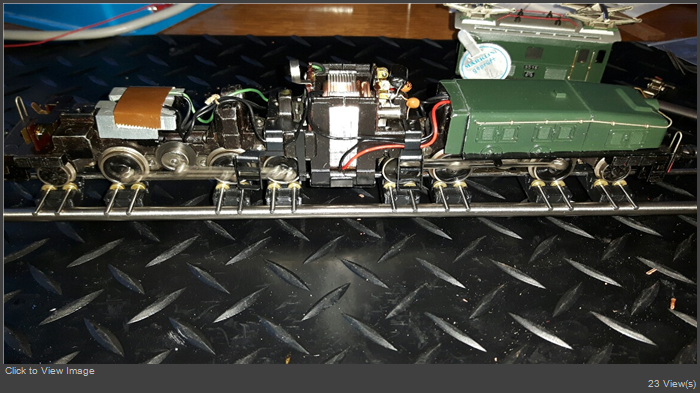

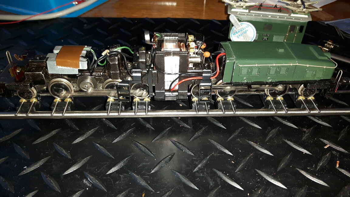

A while ago I thought that I am going to have a lot of free time on my hands so I was looking for ways to keep myself busy. I knew that there is no chance of building a layout (the boss won’t donate the spare bedroom) so the solution was a rolling road that will help with the locomotives maintenance.
I didn’t like the idea of paying over £200 for the Marklin unit or £150 for the competition, a Google search yielded the following unit on ‘Ali Express’.
It is an 8 rollers unit that is primarily designed for DC engines, however by wiring the two, left and right rails together (-) and adding a wire (+) to the centre rail the unit will run as a 3 rails unit.
The quality is not the same as Marklin and the construction is simpler but sturdy. The slight inconvenience is that the roller blocks can’t be fastened in place so if the model is removed there might be a need to re-position the roller blocks, a small inconvenient for a unit that costs only £32.

If you want to keep the rollers in position but still be able to easily move them. Glue a neodymium magnet in a hole in the plastic brackets.
The magnets will stick to a Toledo stainless ruler. Use that as a base plate. You can massage the magnets along the ruler for correct spacing.
