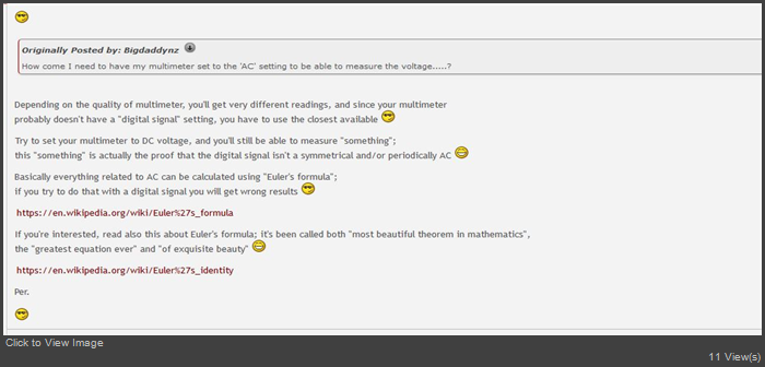

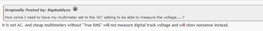

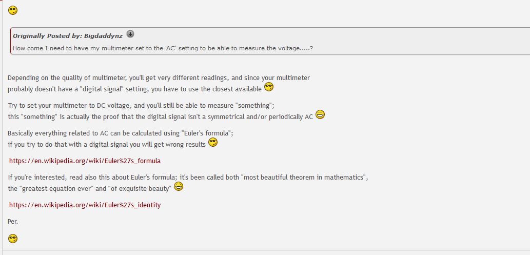

... it's not a square-wave. The term rectangle-wave would be a better fit...
The term 'square wave' as I understand it - "A square wave is a non-sinusoidal periodic waveform in which the amplitude alternates at a steady frequency between fixed minimum and maximum values, with the same duration at minimum and maximum. In an ideal square wave, the transitions between minimum and maximum are instantaneous."
https://en.wikipedia.org/wiki/Square_wave
That probably covers your rectangle wave!
At any rate as has been mentioned the output from a digital controller is neither AC or DC, but a square wave but it does have AC and DC components which is why you will get a voltage reading if measuring the wave in either AC or DC mode with a multimeter.
Using a True RMS multimeter in AC mode gives an approximate reading but the proper way to measure the signal is with a True RMS multimeter that can measure in AC + DC mode as my Fluke 287 can. That takes into account the AC and DC component of the waveform and gives a more accurate reading.

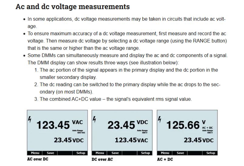

NO! <sigh> The digital output of a digital controller IS alternating current.
but a square wave
yes, the AC is square wave.
back to utter nonsense. AC current only has AC components. AC and DC are mutually exclusive.
More nonsense.
Misusing a meter by using the DC mode when reading AC will give a reading (which is wrong) and does NOT suggest that the current is anything but AC.
Attempting to use the AC mode of a meter when the AC is not sinusoidal, will also give an incorrect reading of the AC square wave. This is because the design of the meter is to adjust the measured voltage based on the assumption that it is sinusoidal. The 'AC' mode of the meter should be labeled 'AC sinusoidal'.

I've always got a 18.5v reading from both my Digitech and Fluke 287 multimeters (both are True RMS meters) on the AC setting when measuring the out put of my CS2. To my horror and confusion I could only get a 14v measurement from my Fluke (AC mode) when measuring the output of my CS3 - the power supply feeding the CS3 was set to 19v. I eventually found out I should have used the AC+DC mode on the Fluke and doing so gave a reading of 19v.
Here's a screenshot from the Fluke's manual
So as Per suggests there is DC 'something' present.

No, what I meant was that the asymmetrically signal makes the multi-meter "think" that DC is present Cool
exactly read what RayF states. His and my statements match exactly.
Strange, because I agree with RayF; but not with you; for me as well as for RayF "AC current" implicates a sinusoidal variation Cool
Please stop claiming that digital track signals are not a form of AC current.
I would never call it "a form of AC current"; if you only send digital "1", you get a steady DC for as long as you send the "1"s Cool
The most sensible nomination of a digital signal would for me be "polarity changing DC" - which it also is BigGrin
You have a certain DC voltage when you send "1"s, and you change the polarity when you send "0"s Cool

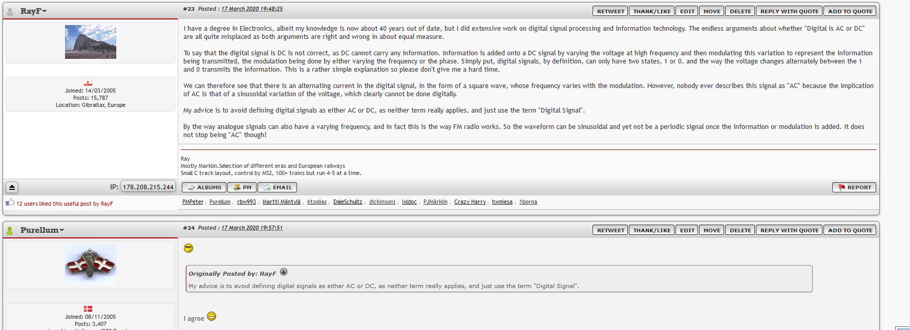

The endless arguments about whether "Digital is AC or DC" are all quite misplaced as both arguments are right and wrong in about equal measure.
My advice is to avoid defining digital signals as either AC or DC, as neither term really applies, and just use the term "Digital Signal".

Can anyone (i.e. Per) answer why I got 18.5v from the CS2 with my Fluke on the AC setting but only 14v from the CS3 with the Fluke on AC.
Switching the Fluke to AC+DC mode gave me 19v from the CS3.
Dale didn't even attempt to answer that which would have been more appreciated than the answer he did give.
Because I already gave you the answer in a previous post:
You are wondering why two incorrect readings don't match.
