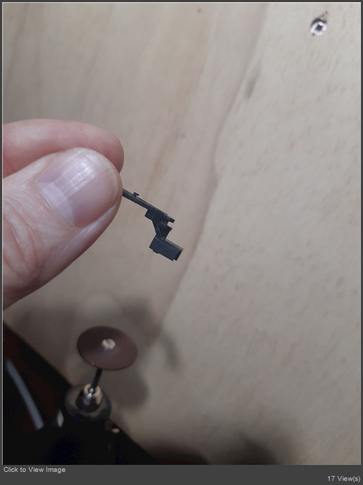

I have not had any problems with ERH. There have been a few issues with damaged items which were affected by dealer/manufacturer/distributor issues, but Walter and his staff have been very nice to me. I usually talk to Jen if Walter is not around, but Walter is the tech expert.
As far as WET (Westend Trains), I have not dealt with them since Mike took over from Klaus. At the time, WET was a side operation to Klaus Marine, which was the primary business. I would visit them almost every time I was in Toronto on business, along with John's Photo & Hobby.
As far as the 64190 (correct number) and the 79248 (Railjet 1216), what problem are you experiencing?
If it is a coupling issue, like you posted earlier, my recommendation would be to take two pieces of wood, approximately 1.5 m by 6 cm.
Attach the two pieces to make a L shaped form. I used glue and screws to fix the two pieces together.
Set the assembled part down on a workbench. So that the upright section forms a back panel.
Affix a foam sheet or other insulation to the back panel.
On the base, you can now install your choice of track sections, so that the track extends a cm or two from the left (or right) end of the cradle.
Determine the position where you want to nail the track in place in a manner to ensure that when the section is tilted flat, that the train remains on the track while resting against the insulated panel. Secure the tracks in that position. On the version I experimented with, there was a little room between the back panel and the train. When the model was tipped on the side, the model would sit with the wheels closest to the real wall on the rails, which would allow enough space when upright that the model could be driven on to the layout without rubbing against the side.
Once completed, you can use this cradle to attach the couplings of models like the Railjet, Roco's ICN, Maerklin's Gottardo or any other model that requires the consist to be coupled prior to being placed on the track.
Once you have coupled the train, you can then return the cradle to the upright position, connect the track to your layout and easily run the train onto the layout.
I experimented using the C to M adapters for the connection between cradle and layout, which allowed for easy connection/separation, unlike C track which has to be bent up.
Some times, I think it would be easier to have a four to eight pole connection between coaches that would be separate from the actual coupler. They could design a socket either in the gangway door piece or in the footboard of the gangway itself. You would then insert the cable between the coaches and then connect using a normal coupler. That way, the models could be connected while on the layout and assembled car by car rather than as a unit.

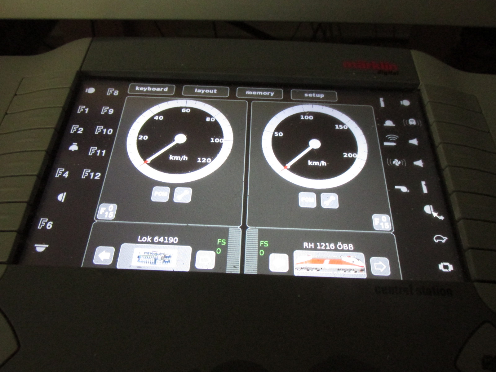

I have a lot of trouble configuring locos other than Marklin on the cs2.
I have a Brawa steamer (under repair for 9 months at ERH), a Roco diesel, a Roco electric (79248). And of course the set 64143, 64190 and 64973. That's all.
I was wondering if I had done the configuration job on the cs2 properly
I read the instructions again and if I understood everything correctly, since the cab car has a different address than the loco, the cs2 is correct and the presentation on the screen is normal.
And if I understood correctly, for the car lights, you have to work (according to the instructions) in Motorola mode, so with 2 functions, one from the cab and the other from the locomotive.
I haven't checked it yet.
For the moment, only the cabin car is illuminated, the other 3 cars are not.
If it doesn't work when I do the test, the problem would come from the electrical connectivity of the couplers or something else.
I have to finish the functions F1, F2,....etc of the 2 folders on the cs2.
I prefer by far the recording on the cs2 with MFX decoders: it's incredibly simple.
It's the cross and the banner with decoders from other brands : it's a long time to do.

Hi "Thewolf",
I assume two years down the track, you have sorted the issues you were having with your Swiss carriages. I have had the same issue and I've finally got around to looking at it (along with a few others that have been similarly having issues). Your post and the replies were useful for helping suss the problem. I'm just adding to the discussion for anyone else who looks at this, since I tried a few extra things which seem to have made a difference as well, in fact 5 things in total.
1) Coupler triangular "frame"
What I found is the coupler was having trouble getting from side to side, forcing itself across with a jerk. Taking the triangular "frame" out (and trying not to lose the spring - one flew off somewhere!) there seemed to be some excess plastic making it tight for the frame to move past the mid point on the carriage chassis - see picture 1 (I hope these photos post in the right order).Triangular frame before.jpg
and it has made a world of difference to the free flowing of the couplers. Admittedly I don't like taking to the trains with a dremel, but given the frame is the cheapest and easiest part to replace if I got it wrong, I gave it a go. One of them was still stiff, so another millimetre off and it is good now.
2) Going around R1 curves, some of them S bends on the mountainous sections and through stations, it does look like the coupler could catch on the buffers or the buffers may tangle. I took your advise and pushed them further back into the chassis.
3) Not possible to do this with the loco, so have swapped out the close coupler with a relex coupler.
4) With the control cab, the wiring from the wheels just seemed a bit tight through the seating plastic, possibly pushing the conducting frame out of its slot and therefore loosening the coupler triangular frame underneath it. A bit of drilling to open up the hole a little more may be helping.Cab control car.jpg
5) Finally the weight of the carriages. They are light and I was finding the control cab at the shoe end was sometimes derailing on the frog on turnouts when rounding the curve. The shoe possibly has too much spring and with the centre rail rising through the points, it lifts the wheel on the frog sufficiently to derail it. Instead of playing with the spring, I've put some ball bearings above each wheel set to hold all carriages down, also weighting the train so the resistance from the shoe at the back doesn't pull the intermediate carriages off the rails.
All of these seem to be helping. I have run the train (admittedly only being the loco, 2 intermediate carriages and the control car, so not long) at speed and slowly in push and pull modes and it is now behaving itself. Given the number of times I've taken them apart, I wish I had the lighting kit on hand . . . and a bunch of passengers. I think the lighting will be a Christmas present for my son, since they are his carriages . . . good that he can finally enjoy using them.
Andrew.
