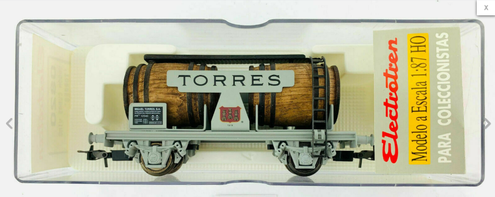

My brother recently sent me an Electrotron wine barrel car made in Spain. The barrels are made of wood and it is very nice. However, it derails on switches. The pressed on wheels have loosened on the axles and wobble. I am trying to remove the axles so that I can put a drop of adhesive on the axles to hold the wheels on the axles. The problem is that the axles are in metal holders that look to be integral to the metal frame of the car. Before I try to bend the axle holders and break something, is there a trick to this operation? All of the axle removal posts that i have found havre to do with locomotives or plastic axle holders.

Not sure about your car but there is an Electrotren wine car looking like this.
To me there is a very high probability, the wheel axles end with a cone and rotate into a plastic cone (wheel bearings) and usually you extract the wheel by gently making the wheel bearings wider (by one mm or so) with a screwdriver or with your nails. On other types, the axle is pinched in the middle so that it does not fall off.

Normally, the axles can be removed by sticking a flat screw driver between the wheel and the plastic/metal holder on the outside.
Use a little bit of force to expand the space between the two and then using your other hand, you should be able to retract the wheel set and repair or replace it.
Be mindful with the use of force as you don't want to bend or damage the holder.
