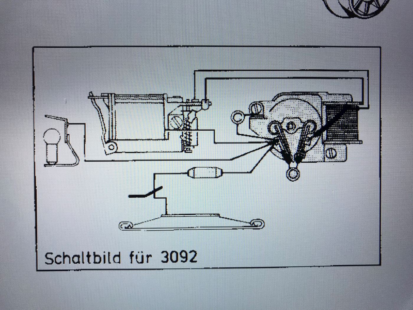

#7 Posted : 19 April 2021 21:42:29(UTC)
Posts: 6,069
Originally Posted by: Stuart_B_S Go to Quoted Post
Does anyone have a parts guide for my 3111 loco? I'm not sure what I may be missing.
There is no 3011 info available on the Märklin website, but I understand that the 3092 description serves for this purpose, too. Link: https://www.maerklin.de/...elnummer=3092&lang=1

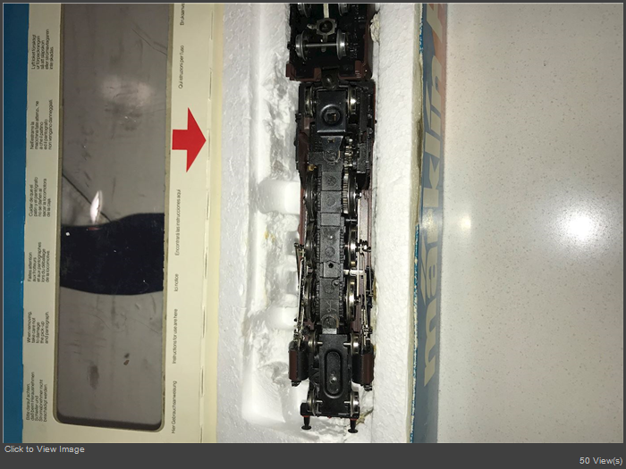

Offline Stuart_B_S
#9 Posted : 20 April 2021 03:37:17(UTC)
Stuart_B_S
Joined: 30/03/2021(UTC)
Posts: 7
Location: MANITOBA
Here is the bottom of my 3111:
Obviously, there's no slider.
As far as I can tell, all I need to do is get a slider and a screw.
Can anyone confirm this?
Also, the parts guide lists a small piece, #45, but there is no description of what this piece is. Any ideas?
Thanks again in advance!

#11 Posted : 20 April 2021 08:44:55(UTC)
Posts: 2,299
Hello Stuart,
From your image, for your 3111 locomotive you will need a new :
- slider ( "Schleifer"), part 46 on parts diagram, Märklin part number 7185 (shown as temporarily not in stock, but I note them on eBay)
- screw for same ("Senkschraube"), part 47 on parts diagram, Märklin part number 756100 (shown not available but I see they are on eBay)
- brass contact for slider (for wire to motor) ("Kontaktplatte") part 45 on parts diagram, Märklin part number 273890 (shown not available
Have fun,
PJ

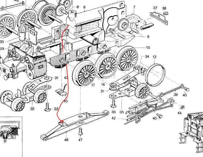

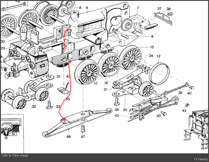

#12 Posted : 20 April 2021 11:48:37(UTC)
Posts: 3,721
Hi Stuart
I concur with my friends above except that part 45 is not made of brass but it is like a one-sided PCB.
The side in contact with the loco chassis must be insulated.
There is a simple alternative: to solder a red wire to the slider spring (on the side of the insulation plate) and pull it through the hole in the front cavity
thanks 6 users liked this useful post by JohnjeanB

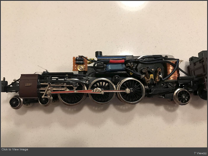

Offline Stuart_B_S
#18 Posted : 03 August 2021 04:13:15(UTC)
Stuart_B_S
Posts: 7
Location: MANITOBA
Gentlemen, thank you all for your help and patience. I am finally home from work, and finally have some time to further investigate my issue.
I have the slider and screw, and I have the body off..
Pics are attached.
Where do I go from here as far as wiring?
thanks 1 user liked this useful post by Stuart_B_S
#19 Posted : 03 August 2021 08:27:36(UTC)
Posts: 4,106
Pics are attached.
Thanks!
Hi Stuart, as Jacques suggested, it's definitely a 2-rail DC Loco.
The question is whether it was originally 3-rail and has since been converted to 2-rail, or, did it leave the factory as 2-rail (aka HAMO 8311). Looking at it, I suspect it may already be modified, the Diode PCB is not original.
You are faced with a reasonable amount of work to return it to 3-rail. It certainly 'can' be done, but at present the wheels are insulated from either side, both on the Loco and Tender.
It is possible to ignore this, but the risk is that slow-running may be an issue due to the lack of sufficient wheel/rail contacts points, particularly over turnouts, double-slips etc.
So you are faced with adding the required pickup shoe, plus, deciding whether to directly solder it as suggested (not preferred because replacing it becomes more difficult), or sourcing / fabricating the required contact plate (ref #45 in the exploded view diagram).
Then you also need to replace the existing Diode circuit (needed for directional lighting) and replacing it with either an original mechanical reverse unit, or, a Decoder.
You could fit just a decoder, and make use of the existing motor, or fit a complete conversion kit including decoder, armature, brush plate & field magnet.
Or, depending whether there is any particular attachment to that particular Loco, cut your losses, resell it as-is to a 2-rail modeller and purchase the same 3-rail version to replace it.
Perhaps not what you want to hear, but sometimes you just have to be pragmatic and weigh up the work involved, the costs of parts etc, to still have what will always be a compromise.
