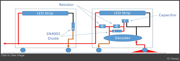

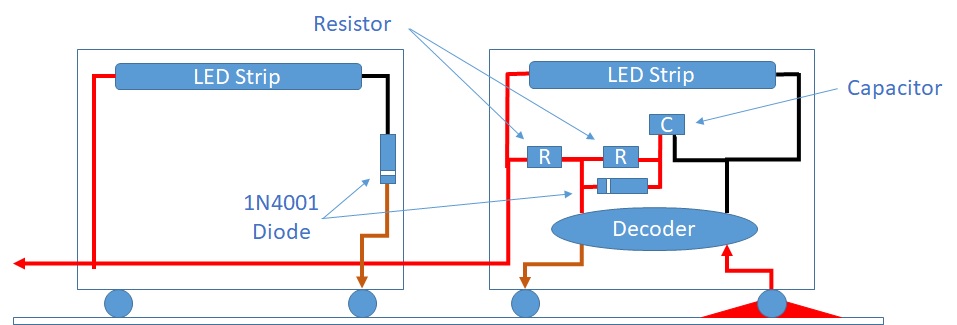

As I already received 4 standard cars (Märklin 43574), I plan to use Current-Conducting Close Couplers (Märklin 7319) and Ground Springs (Märklin 72050), and install according to Dale’s great description for LED strips inside passenger cars.
Actually, I have a third question:
(3) If I have a function decoder for the light control (on/off) in the single car where I have the pickup-shoe: Do I need two-pole connections between the cars, or can I lead minus from the LED strips via a 1N4001 diode and a Ground Spring to the rails in each car? (See drawing below)

Would a bridge rectifier be better than diodes. In my installations, I used a bridge rectifier, capacitors and resisters in every carriage. The current conducting couplers carry the full voltage from the track to all my carriages.
Mind you, I have designed mine to run on ac or dc. I think the bridge rectifiers help to clean up the strange voltages that come from the digital feed. without the bridge, mine didn't work so well on the dc.
Not sure if this is the right response regarding your question.
Dereck
thanks 2 users liked this useful post by dominator
#4 Posted : 20 January 2021 10:27:37(UTC)
Posts: 15,488
When the couplers are connected to the decoder output then a bridge rectifier in each coach makes no sense, a simple diode will be enough.
To prevent flickering a capacitor in each coach could make sense.
Capacitors without a loading resistor can disturb the mfx signal on the track.
Adding a relay to the decoder output and distributing the track current over the couplers may be a good way. Then bridge rectifiers in each coach make sense.

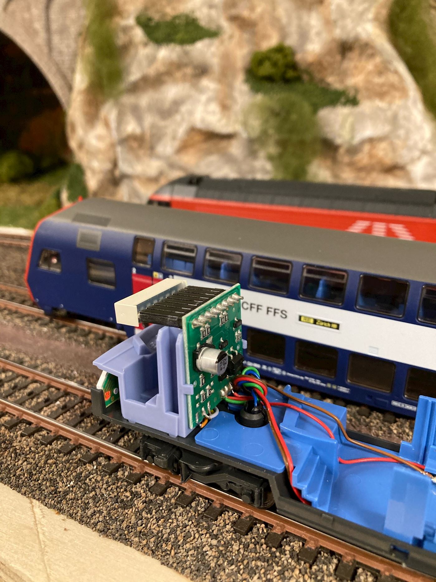

I have now opened the Cab Control Car (Märklin 43575) for the first time. There are some electronics at the cab (below pic) and under the boggie there are some mechanics that checks which direction the car is running. If forward, then white front lights, if backwards, then red lights. Above the cab, there is a lighted sign, ”Zurich HB”.
I’m not so happy with this solution... Glare
The lights are flickering at bad conduct locations, and I want to add a capacitor. Also, I plan to exchange the ”direction mechanics” with outputs from a function decoder I plan to use for controlling interior lights on/off.
Has anyone of you done something like this, and know how to deal with the cab electronics?

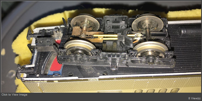

#6 Posted : 10 April 2021 17:08:37(UTC)
Posts: 3,629
Hi PeFu
I have some cars like this and they work very well and it is extremely simple
It is based on the use of a trailing switch (Schleppschalter)
Here is one of them: a contact clipsed on one of the axles is making contact with one contact or the other thus giving the directional switch illumination.
Another one is the Schienenbus trailer based on the exact same principle.
Of course this works mostly with very low current (less than 10 mA) although in the early 1950s Märklin was doing the same on most large locos (CCS800, TT800, DL 800, ST 800, TP 800..) with a much larger current and larger contact with larger friction force
I don't see any blinking which may be caused by unclean wheels or contacts (cleaning the wheels and making sure the slider is not worn out may be simpler.

Would it be possible to feed the electronics with rectified (and capacitor supported) DC instead of digital power? There will be an additional rectifier within the electronics, but this wouldn’t cause any problem, would it?

I ended up feeding the cab control car electronics with DC according to the principle described in a parallel posting. This way, in addition to eliminating the flickering, I can also turn the cab lights on/off. I can’t see any reduction of brightness, feeding with DC instead of ”AC” (digital power).
