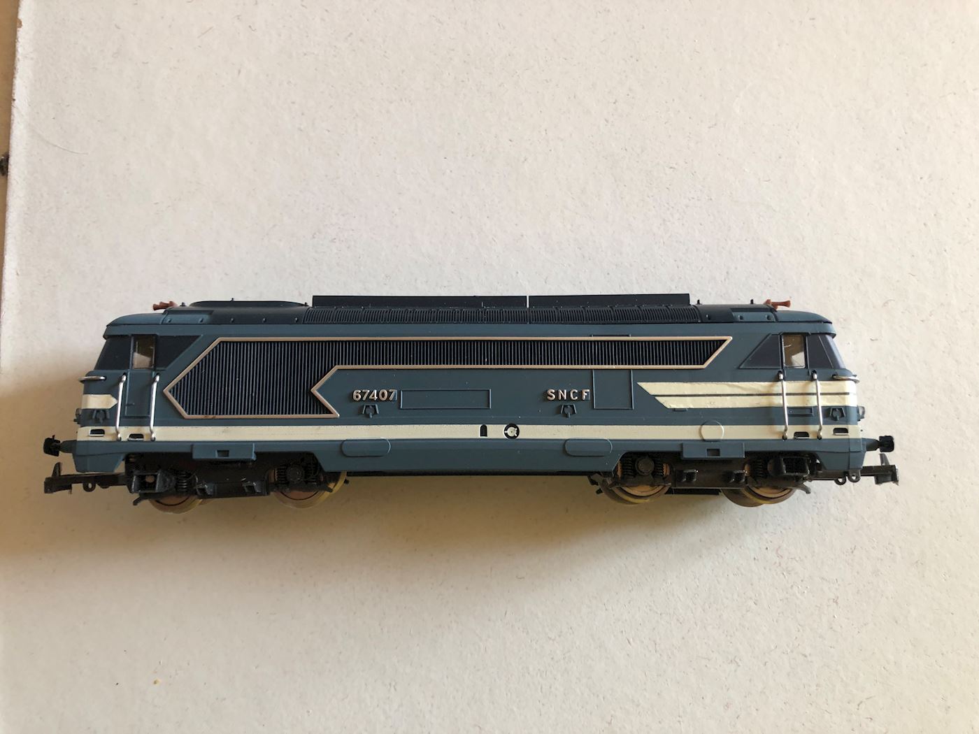

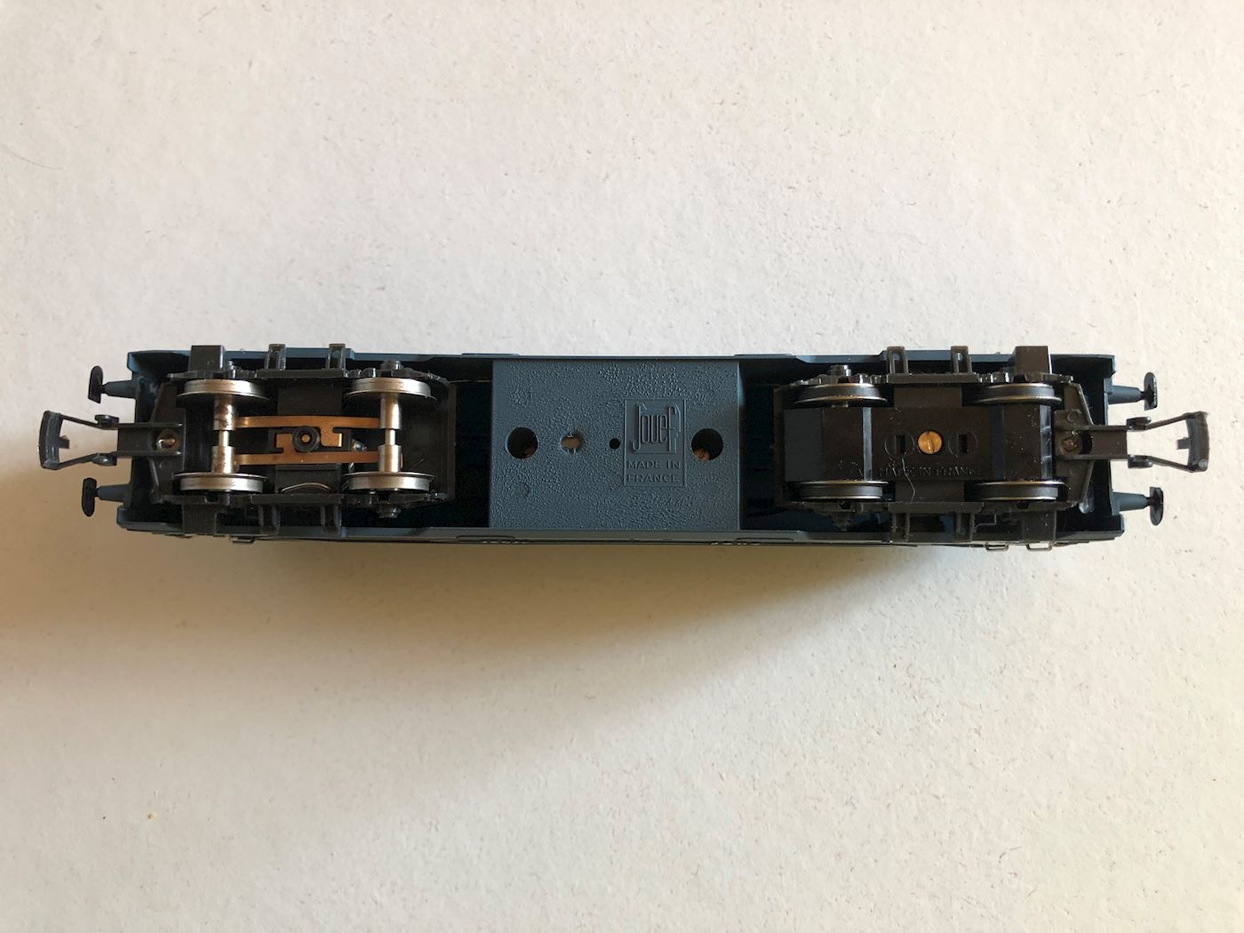

I have a Jouef 8539 Diesel from my first days in model railway, I was on holiday in France and bought this to run on my old Hornby layout.
I would like to tray to convert to run on C track with my CS3, is it an easy job or should I sell it on Ebay ??
Tim
#2 Posted : 28 February 2021 12:58:46(UTC)
Posts: 14,881
Hi, I wouldn't sell it, its easy to convert if you know how., a.) you need a rectifier diode to convert it to DC, add a decoder with either an 8 eight pin socket + an 8 pin plug (2 Aux functions + 2 light functions) or a 21 Pin decoder with an 21 mtc adapter plate (more Aux functions)., you could change the bulbs to led's with a resistor (1000oHm), you just have to change the wiring and combine both sides of the axle and try to fix a pickup shoe to the front bogie., I would suggest remove the pin which holds the front bogie to the chassis and insert a screw which will hold the bogie to the chassis and at the same time you can use this screw to attach the pick up shoe to it.
