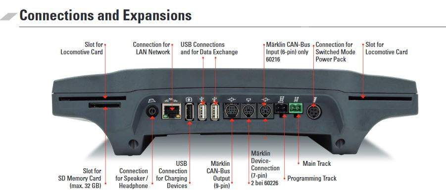

Firstly, you need the CS3+ if you want to use a CS3 as a slave as that's the only device with the required input - CS3 / 60226 doesn't have the required input. If you don't have a CS3+ then the question is a moot point.
But I don't think a CS3 will work as a slave to a CS2 as the CS3 is the later device.

#4 Posted : 25 November 2020 15:48:04(UTC)
Is that the case? The CAN bus is bi-directional and I don't think there is an input and an output.
I believe that is the case. You can't link two 60226's together, the 2nd and subsequent CS3's has to be a 60216 because the 60216 has the proper connector for the 60123 cable. 60226 doesn't have it. 60226 can act as a master in this scenario.
According to Märklin Magazine you can combine a 60226 with a 60215. For a 60213 they write that a CS3+ 60216 was required (but I think this is only required if you want to use the booster of the 60213 without limitations).
Yes, you can do that because all CS2's have the proper connector for the 60123 cable. You can combine 60226 CS3 with a 60213 and early versions of 60214 CS2's, providing you do NOT use both the CS2 and 60226 CS3 boosters, as neither those versions of the CS2 or the 60226 have galvanic isolation, and doing so breaks the rules around only using one device with no galvanic isolation let alone whatever actual electrical damage you might cause.
A 60216 is only required if you wanted to use the booster of the early version CS2's. If you have a late version 60214 CS2 (hardware version 4.34 or above) or a 60215, those devices have galvanic isolation so are fine to use as boosters.
Why Marklin created this nightmare is anyone's guess!

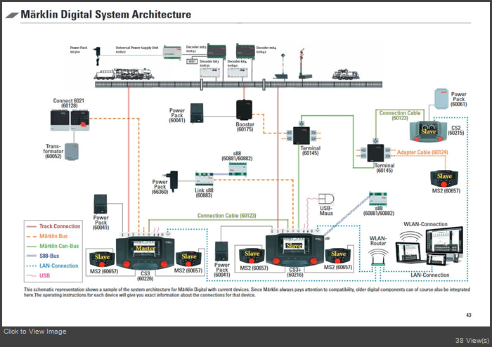

Mine is 60215 CS2 and 60226 CS3 so there should be no problem connecting both with the 60123 cable? If so, can I use CS2 as master and CS3 as slave?

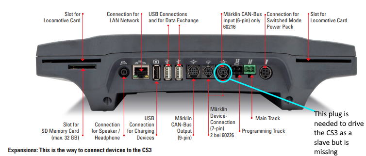

No you can't. The CS3 has plugs to be connected by the 60123 cable AS A MASTER and no plug to be connected as a slave (Only the CS3+ has it)
The other side of the cable can be plugged on the CS2 to be used as a slave.
Note: both connectors of the 60123 cable are not identical.

#8 Posted : 25 November 2020 17:52:30(UTC)
Posts: 3,653
No Tom, even if you check the box, the CS3 failing to have a CAN bus input makes it impossible for it to PERFORM as a slave.
Check Märklin documentation

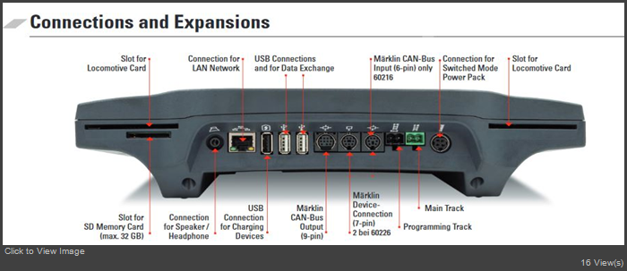

#9 Posted : 25 November 2020 18:05:57(UTC)
Posts: 3,653
Hi Tom
This is an extract of the lst 60226 documentation page 3
This is the link to the full documentation
http://streaming.maerkli...3_Manual_EN_final-lo.pdf
#10 Posted : 25 November 2020 20:31:54(UTC)
You've posted the very same picture I already posted in post #4 Wink
