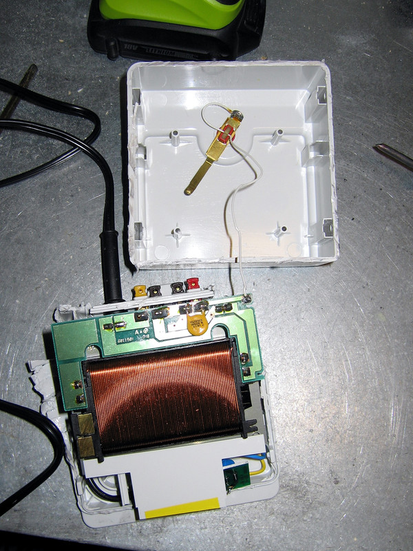

A few years ago my white transformer was acting up like you describe. I traced my problem to a 'failing' wire inside the transformer. The wire was pinched (you can kind of see it in the middle of the wire) Cracked open the transformer and replaced the wire and all was fine.
Just throwing the idea out there....
Ken
