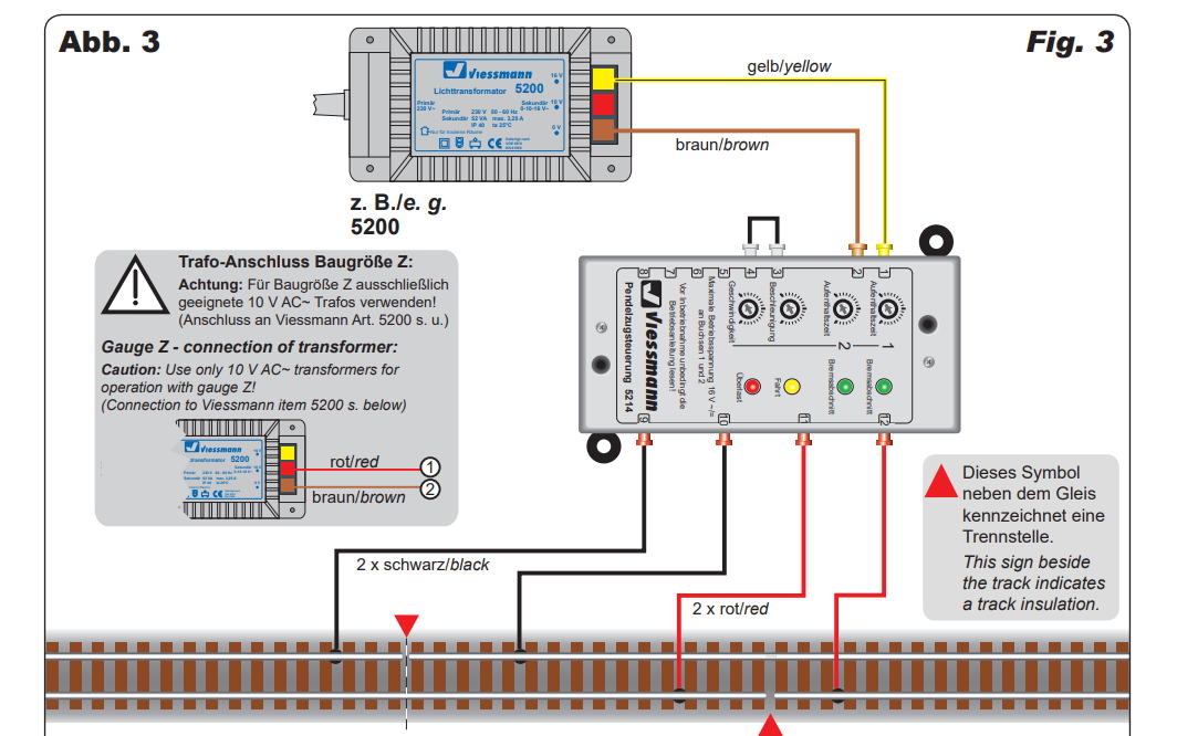

#8 Posted : 22 November 2020 21:16:19(UTC)
Posts: 3,729
Here is a wiring of the Viessmann module 5214 for shuttle operation for analogue DC 2 rails system
It says it all
- 4 wires for operation (2 extremes to detect the end of shuttle, 2 central to power the train)
- 4 potentiometers to adjust speed, acceleration, stop time for stopping station #1, stop time for stopping station #2
It is powered by a 12VAC transformer.
It is simply brilliant

It does work well (though there are a few imperfections) but not if you have an existing layout with common return wiring - that with is all the section isolating on one side of the tracks. I wanted to be able to have shuttle control over a section of my layout for when I can't be around actively to operate it at exhibitions which is why I went to the trouble of developing my alternative wiring.
Surprisingly, my perception is that it works much better with the old five-pole equipped locomotives than with the new coreless motors!
