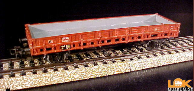

I have seen a similar problem with HO cars from 1955 built with a Zamak superstructure and a "Thermoplastic" body; the 4606.
On this picture from the LokMuseum you can clearly see the bending
The thermoplastic has shrunk and not the Zamak underframe so the body is bent. In this case nothing can be done
May be in your case there is a sheet metal inside that could be corrected?
