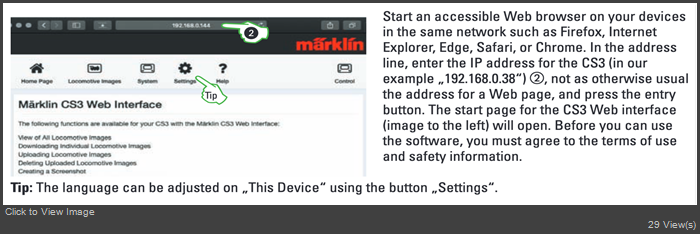

Thanks teewolf, but we know all that, and if you aren't using a computer and the web interface you won't know what we are talking about. Please see the attached image link from the latest CS3.2 manual showing the interface.
We need help from someone who has bumped into our problem before.
Hope the upload image works?

Forgot to point out that the Control is on the right side under the marklin logo and should open a screen with all the loco and track controls.

Oh, I use this web interface. Thanks, now I understand your control button at the upper right side of the menu bar. I use this “control” (in German stands “Steuerung”) for creating and setting my layout panels. Anyway more cannot be done behind this button, at least at my CS 3. I use this function because via the browser the grid switch on/off is working. It does not work using the CS 3 screen. Well, there are still some errors in the software.
But if your panel page never starts and you only see the red line flushing across the screen, then your CS 3 is not connected to the intranet. That is always said on my screen while it is flushing. Then I restart the web interface and after a new connection to the CS 3 it is working again. If this does not help you, I really would try a bootloader update for the complete CS 3 software. How to do this you find it under the help function in the menu systems/settings/systems/CAN. There you also have to set the tickmark for the bootloader update first. Then you must close the CS 3. Do not a restart, shut down first and then start again. The help function explains the procedure quite helpfully.
