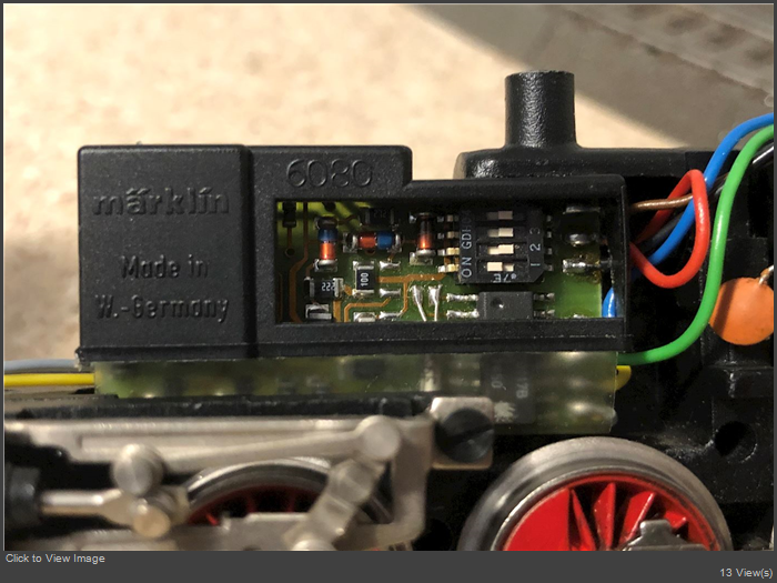

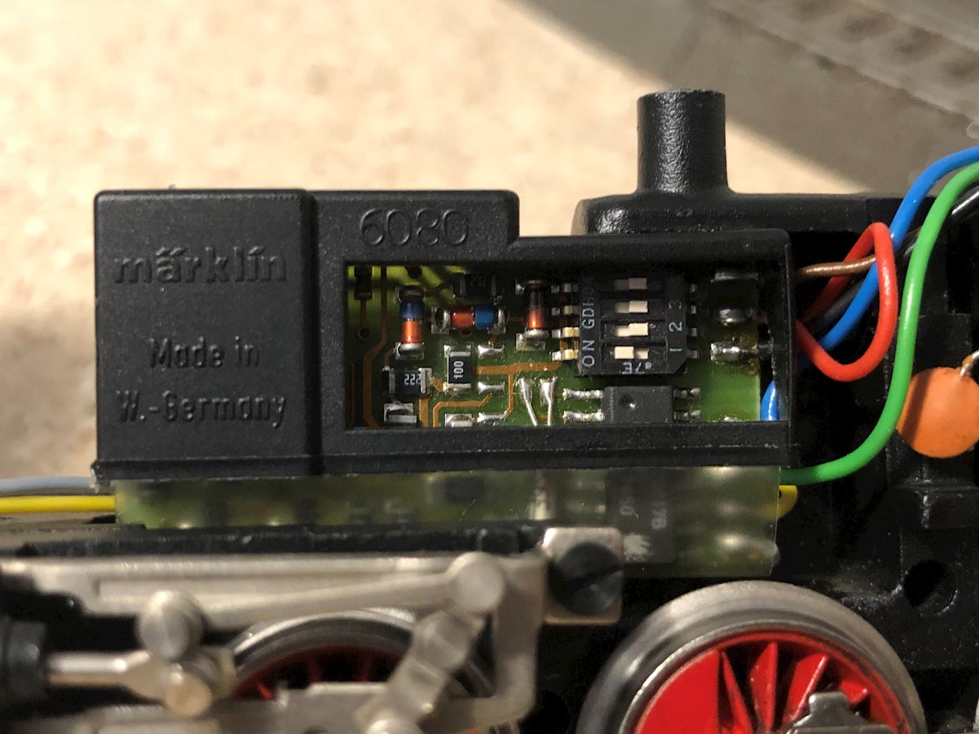

I have an older locomotive that we had converted to digital in the early 2000s. It used to run fine. But we moved and stuff. And now after a couple of years, I have setup a new layout. But this locomotive wont respond.
I have put a multimeter on it and it is getting power - but I know to little of these electronics to figure out what the issue is.
My first port of call was to check that it is getting power - which it seems like it is. Check.
Next, it is entirely possible that I have forgotten the address for this locomotive. Problem here is I cant recall how to set the numbers/address. Logically I would think that it is just a bit code. But I am unsure. Unfortunately I no longer have any manual or paperwork for it. When I google the code that is on the frame of the chip, I dont get what seems to be in the train. I will attach two pictures. I vaguely remember something that they couldnt put a full new (at the time) digital decoder in, so they put a delta decoder in. But I am not fully sure of this.
I would greatly appreciate help or advice of what to do, what to check and/or help identifying the controller.D9646117-5E18-4516-AC22-E17F72827F33.jpeg1D306B34-64B5-488D-879D-E54454CB1BCB.jpeg

So decoder seems to be a 6080
The 'dip' switch is set to 1 which means the address of the loco is 78
Delta has only four addresses regulated by the 'dips' moving them to the ON position sets the various addresses
1 on is 78
1+2 is 72
1+3 is 60
1+4 is 24
1+2+3+4 is 80
Hope this helps

DECODER is not an 6080 is a DELTA

Decoder looks like a 6603 DELTA decoder

I concur it is a delta decoder slipped into a #6080 holder. The 6080 had 8 dip switches. Set address as 80 by putting all the switches in as described by Marco.
You may need to give it a bit of a cleanup & service if its been in storage for a long time. We can guide you through that if you like. For now just see if you can get one of the exposed gears on the other side of your picture to be rotated freely with your finger & if that turns the motor easily you should be set to go.BigGrin
