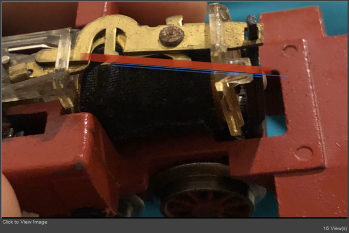

Given the current hiatus, I decided open up my vintage train sets and found that my Marklin 3029 engine only works in reverse
How do I fix this ? I have two Marklin sets and tried both analog power boxes to reverse the engine so it starts moving forward but no luck
Please help

Hi Jay, thank you for your reply I managed to open as per river6109’s directions (thanks) -
Please help me identify the solenoid. In addition, I think someone has tried to repair this before and there is a paper stuck (I am assuming this is supposed be where the spring is hence it’s in reverse.)

The spring on the relay is missing that is the reason of the problem

Part number of this spring:
Märklin 7194
This spring is available in a set of 5 :
7194
I have attached another image with mark up line of where I think the spring has to be fixed.
However, I this is the correct place because I can’t find the second hook where the spring should hook into on the loco
thanks 2 users liked this useful post by Kartik

Hi Joel, thanks for the pic 👍🏼
I think the plastic hook on loco is broken, I will have to find a remedy for this, if you have any ideas let me know...

You only have two solutions really. Either you will have to glue something on to hold the other end of the spring, or replace the entire reverse unit. Possibly that small plastic hook got broken when refitting the body some previous time, in which case you might find the broken piece (tiny) and more importantly the spring in the box it was stored in?
You could probably fashion something out of just about anything you might have lying around, or you nay even be able to look at opening the loop of the end of the spring to hook it onto the body of the reverse unit but that will be a bit fiddly and you'll need steady fingers and fine tweezers. Be careful not to stretch the spring.
Oh, the other thing is you can at least manually reverse the unit so the Loco runs forward, but without the spring, the solenoid will tend to 'chatter' (vibrate and try to operate)

What I would try and do is to drill a small hole, about 1mm (40 thou) or smaller diameter in the end wall of the reversing unit. Don't use a drill when doing this, hold the drill bit in a pin vice rotated between your fingers. with care it should be possible to drill a large enough for the loop of the spring to go through without damaging the solenoid winding. This would at least get you running again until you find a replacement reversing unit on eBay or the like.
