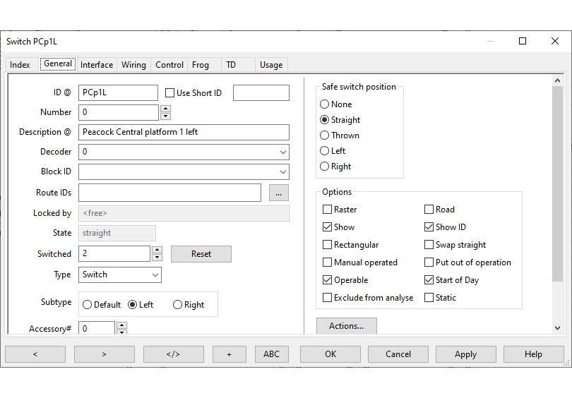

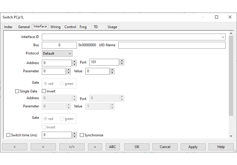

I don't know if I'm missing something but although it is not complaining, there doesn't seem to be much link between RocRail and my CS3...
I have the CS3 screen up, and clicking a point in RocRail, RocRail switches it (logically on the screen), but nothing happens on the CS3 screen?

I see you have 101 in the Port input block. However, you have to enter the decoder address for that point in the address input block.

No, that's wrong according to the RocRail Wiki (but I did try that anyway):
https://wiki.rocrail.net...dressing:accessory-pg-en
Hi Henrik,
I know, that is what their wiki says, it also caused me problems. But, then I put the Märklin point decoder address in the address block & that fixed the problem.

Ok, just tried it again, nothing happens.
I think what I really feel I'm missing is something in RocRail saying "Yup - talking to CS3 and it's acknowledged me". It's like flying blind. I know it's not giving an error but still...
P.S. Just turned track power off and on in RocRail and the CS3 responded so they are talking!

When you connect Rocrail to your CS3 (Ethernet cable) and set it correctly then the simple check is to turn the power Off and On from the Rocrail screen. If it turns Off and On the CS3 then your are in business.
Definitely, each switch must have an adress defined (same as the CS3 address). Simply and oddly the adress IS NOT to be keyed in the adress field but in the PORT field.
If there is no communication between the CS3 and the PC then you need to configure both the CS3 and your PC

I don't think that's the problem. The problem seems to be defining the points correctly in RocRail.

That is good, so you know that CS3 & Rocrail communicate. Move the point on the CS3 and see if it shows the address in the Trace window in Rocrail.

Ok, trace window, that is extremely useful, exept the numpties have done it in some sort of graphics library, so I can't copy and paste from it.
So, the CS3 accessory says x3864 26:1 value=0
The RocRail has numbers such as x3064 26:1 value=25
Oddly, "Value=" in RocRail is set to 0...

The only differences I can spot with my system are:
- Interface ID is empty on your screen: this may be normal only if you have only one controller and if, in MBUS definition, the field "Interface ID" is left empty. Because I have two controller I have entered a name in both locations (MyMCS2).
- The field "Accessory#" is one in my system where it is 0 in yours (but I am not sure it matters).

Going out on a limb here since I only have a CS2 and not a CS3. I notice that you have set the Protocol on Rocrail as Default. I suggest that be changed to either Motorola or DCC depending on what you have set the decoder as. With my CS2 setting Rocrail to Default has always caused me problems.
You're the man! Set it to NMRA-DCC and it works!
