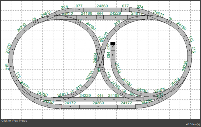

A space-saving and daring combination which I employed in the shadow station area of my former layout Humbug-Dummtor. Actually an iteration of the asymmetrical wye presented by Kimball above.
Another iteration made possible by the advent of 24315.

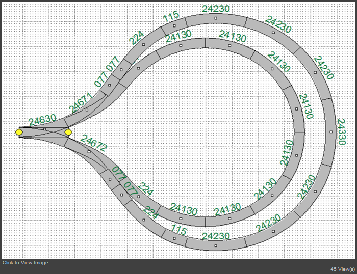

Elaborating on posts 27 & 28:
Space requirement for this nucleus: 171 x 130 cm.
Question, this doesn't line up in the ANYRAIL program but does it in reality as I do not have any of this track to try out?
Michel

The only critical section is the connection between the curved turnouts to the left: The “C track slack” allows for this, but one might need to screw down the C track. Leaving away the curved turnouts = no problem any more.
The C-Track range has a 24649
I believe that using this helps eliminate a lot of piecemeal makeup sections and offers the train a nice ride
True, but to be considered:
- My design defuses S-curves by inserting 188 mm straight sections, respectively, which avoids stressed couplers and derailments.
- When I once had a more sophisticated version of the condensed pretzel, it was concealed in the centre of the layout, thus riding comfort did not matter at that time:
https://www.marklin-user...n-Layout.aspx#post323270
- Your design requires switching (via operating the curved turnouts) for "continuous" running over the pretzel, while mine does not (subject to proper setting of "non-motorized" Maerklin sprung turnouts).
BTW, forum member 5HorizonsRR has a similar construct: https://www.marklin-user...t-Project-In--4-x-7-Feet

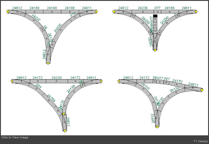

Post # 76 contains another solution regarding the curved turnouts situation:
Never without my 24206...

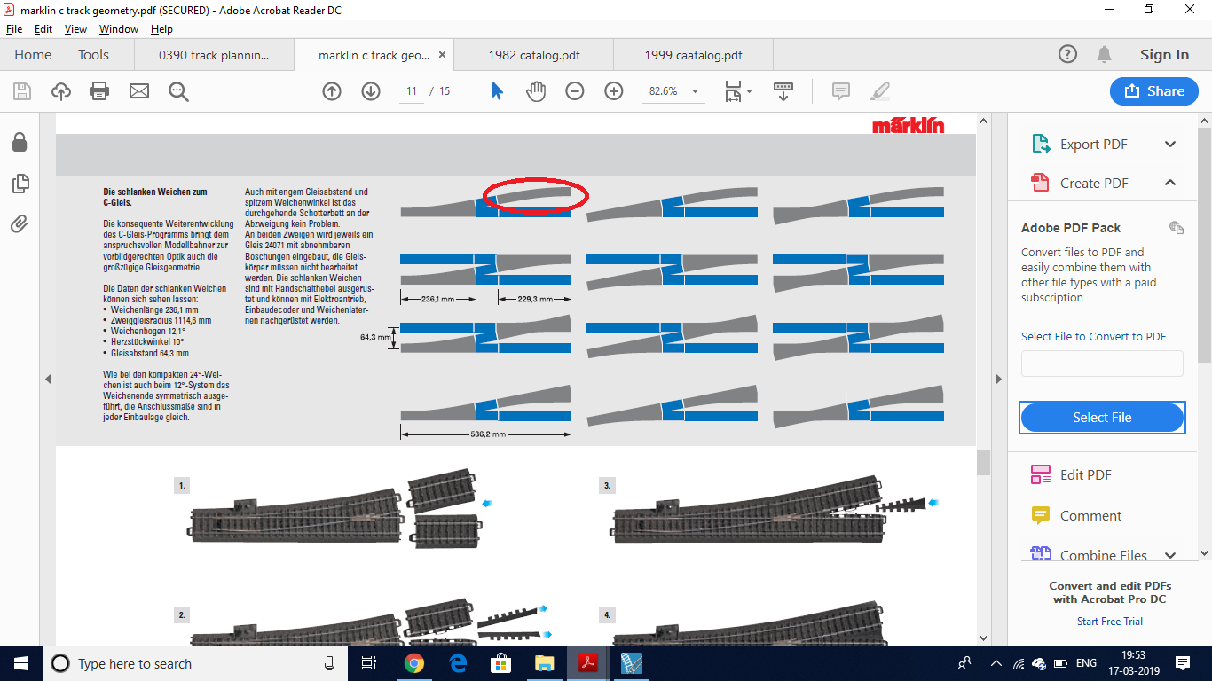

It’s the Märklin 24912.

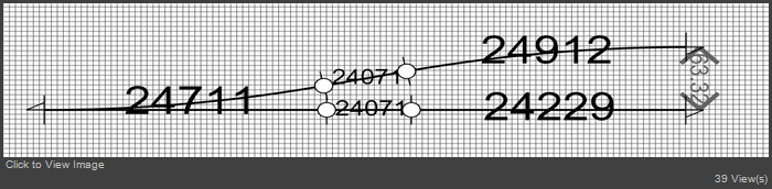

Hi guys by using a 5137 turnout in M-track i could get a siding with around 55 mm center to center distance. However the minimum center to center distance that i can get with C track using 24711 or 24712 is around 64 mm (see below pic). Any suggestion on how to get a smaller distance. The thing is that in india our tracks are spaced at 4725 mm. Thus for a ho scale it is 4725/87= 54.31 mm. Can anyone help
Thank you
khirad

The radius of the curves in India, and everywhere else, are certainly much larger than the scale radius of R9 of C track, so you will never be building your layout to an exact scale unless you have really a very big space and use K track flex track.
the distance between the tracks is bigger than the real scale because you need clearance in the curves and you may also need to pick the train by hand, and in that case your fingers must fit between 2 trains in contiguous parallel straights.
One method for what you are asking maybe not using the 24071 tracks and cut the 24912 so that it will fits. Then you will get smaller distance between the tracks, but is not an easy task, at least for me.
If you want to go the way I described above, you need to cut the roadbe close to the turnout so that it doesn't overlap. Then instead of cut a portion on the other side I sugest you cut a portion of the roadbed and center rail in the midle. After that join the 2 parts of the roadbed in still in the track and cut the 2 rails in excess. After that solder the 2 parts of the center rail so they will be electrically connected...
Miguel

#116 Posted : 22 March 2019 19:00:15(UTC)
Posts: 6,064
Originally Posted by: quarkhirad Go to Quoted Post
... Any suggestion on how to get a smaller distance. The thing is that in india our tracks are spaced at 4725 mm. Thus for a ho scale it is 4725/87= 54.31 mm. ...
Please check post 101 above, in case you are not afraid of mutilating C track with a saw...

Hi khirad
The distance between parallel tracks is similar anywhere - including Germany.
As Miguel says there are practical reasons for Maerklin to widen this in C track.
However I don't like the idea of messing with the 24071.
Instead of the 24912, in a track set up for the purpose try the smaller radius curves.
Try a 24206+24207 which equals 13 degrees and may do the job of keeping the tangent parallel (as does the 12 degree 24912). I just tried that with the track pieces - it works for a 51mm spacing.
Or maybe a 24215 (which will need cutting) or a 24224 ....
Then cut it at the point where the tangent would be parallel.

I have used the track pieces to achieve 55mm spacing as follows:
Wide radius point + 24071 + 24206 + cut 30mm straight + 24207. Looks good to me.
You will run into fouling problems if using signals, catenary masts etc.

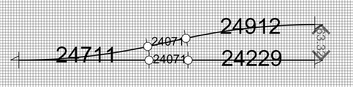

Here is a great use of slim turnouts in sequence with an irregular use of the 24071 track piece.
Posted by hxmiesa in the topic mentioned earlier.
"The removable TRACKBED could be part of the switch; In the cases where several consecutive switches are to be mounted, 71mm might be saved if a small (71mm long!) triangular piece of trackbed could be removed at each side of all of its 3 track connections.
At the end of each group of switches, the 071 track-piece with removable trackbed would still be necessary, of course, in order to allow the "normal" sectional trackpieces with complete trackbed to be connected.
Of course you cant read the pictures I have in my mind, so I suppose a drawing here would help a lot. I dont think I can explain it much better. I thought it wasnt so complicated to imagine... Blushing
PS: No drawing necessarry; Here is a photo of somebody thinking the same (More or less);
http://666kb.com/i/b9vz9ii5hz85uaq1l.jpg
slim turnouts and 24071"

Which are you cutting Kimball, the 24711 or 24071?
Thanks,
Roger
Online kimballthurlow
#129 Posted : 01 May 2019 00:28:17(UTC)
Posts: 6,817
Hi Roger,
I just re-posted hxmiesa's picture.
I have not tried the arrangement.
However the 24071 has the removeable ballast side section, so I doubt that would be cut.
It looks like a small wedge is cut from the ballast side section of the 24711 at the toe end.

However the 24071 has the removable ballast side section, so I doubt that would be cut.
I agree, but I don't understand exactly why someone would want to do that? Just to gain a few mm closer track spacing?
I was amazed when I tried to do a two series of four 24711/24712 turnouts between adjacent lines and even a straight run of four meters would not allow eight pairs of turnouts with a turnout in and one out for each of five lives. I could just fit in three sets connecting four of my mainlines and did the other pairs at other locations. But would cutting the turnout bases really gain you enough to make it worthwhile?
On the other hand I have wondered why Märklin didn't just build that joining piece into the turnouts at times myself. I always assumed that it allowed for other track geometries which wouldn't be available if it was all built into one piece. But on the other hand I don't know of any track arrangements from Märklin that don't require the use of the 24071 pieces, so that could be complete bull crap. BigGrin
Märklin's finances are definitely improving and they are focused on staying in business, as I think they should. So I doubt that giving us better C track options is high on their priority list. Maybe that provides a business opportunity for another company to make C track compatible pieces that answer our many wants and needs. ThumpUp
Sorry to reply to this old post, but I have been thinking/planning a c-track layout and I wanted to get your sense of my own version of the reversing loop/interchange for two, double track lines. I drew this up and it seems to work with all but two turnouts permanently shown. However, since the gurus on this site all use a figure 8 and not just one circle, I must be doing something wrong. Please enlighten me
Steen Jorgensen
#139 Posted : 14 June 2019 15:51:10(UTC)
Posts: 6,064
Hi Steen:
What do you mean by "permanently shown" please?
Sorry, I do not understand. What is wrong about having a circle instead of a figure 8?

#141 Posted : 02 July 2019 13:28:09(UTC)
Posts: 6,064
Another curved Hosentraeger.
"24" prefix for C track article numbers left away in image. The R3 curves (24315 + 24330) can be replaced by R2 or R1 curves as one pleases. The tiles measure 20 x 20 cm.
#142 Posted : 02 July 2019 14:35:33(UTC)
Posts: 6,064
Another double crossover on a double track line.
Upper track: 24672 + 24115 + 24206 + 24206 + 24215 + 24912 + 24071 + 24711
Lower track: 24230 + 24671 + 24107 + 24712 + 24071 (+ 24071 between turnouts) + 24229
Edited by user 03 July 2019 20:56:51(UTC)  | Reason: Configuration corrected
Offline dickinsonj
#143 Posted : 03 July 2019 03:13:03(UTC)
Joined: 05/12/2008(UTC)
Posts: 1,881
Location: Crozet, Virginia
Wow - I thought that I knew and owned every piece of Mäklin C track sold and then you made this post! That is a very nice looking interchange BTW and it needs to go into my designer's bag of tricks. I never saw the 24912 piece in a catalog or noticed when they introduced it, so I was totally clueless about its existence and I can foresee many uses. BigGrin
Of course I now have to get some and add them to my track design process, which starts with physical instances and progresses toward nice, clean, officially approved designs. Cool
I learned more than I expected when I saw this post - both a very nice interchange and an important part of Märklin's C track system previously unknown to me. ThumpUp
Thanks!
