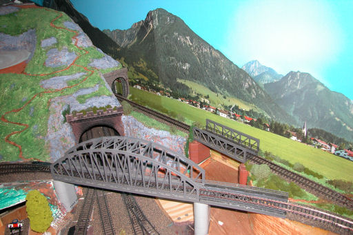

are you sure they are not compatible? The supports should be placed at the ends of the bridge and transverse to the track. Perhaps those are only for K-track and the older red plastic ones with green base probably work for M track.
bridges on old layout
