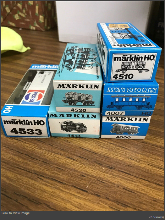

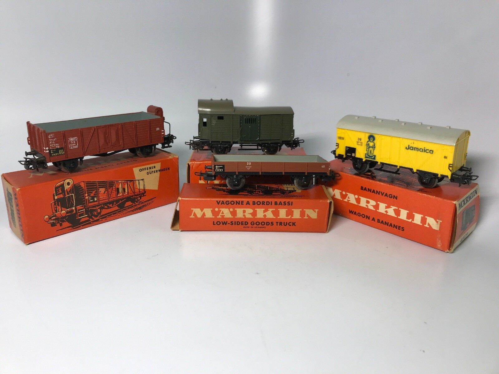

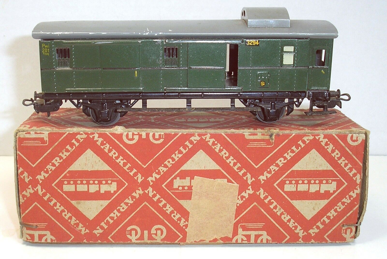

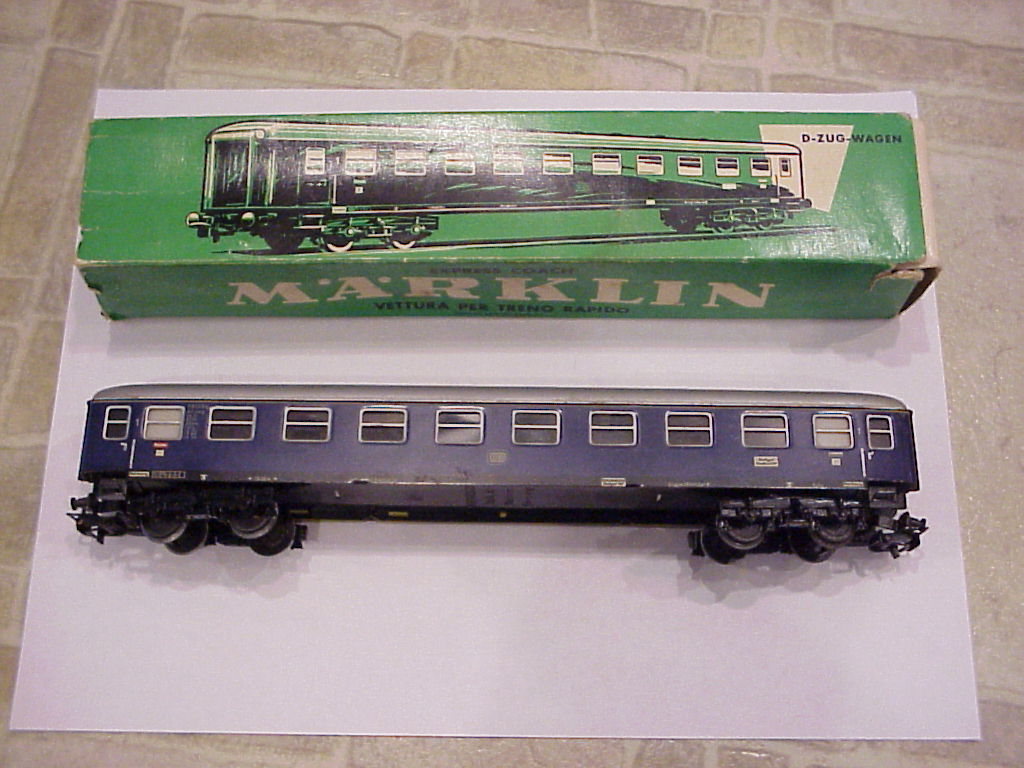

I'm new to train modeling, the forum and Marklin trains. I am starting to buy items to put my track together. I really enjoy the older trains from the 50's and maybe early 60's?. I especially like the old-timer metal cars.
Based on the color of the boxes, can the approximate year of the car be determined, assuming it is the original box?
When did plastic start to be introduced into the cars?
I'm sure you all know what I mean, but I've attached some examples of boxes that I pulled from a certain auction site.marklin red diamond box.jpgmarklin breen box.jpgmarklin blue boxes.jpgmarklin red box.jpg
