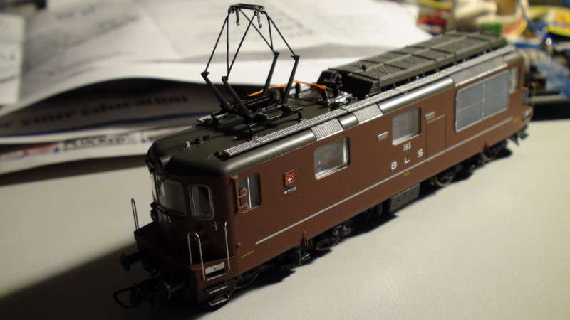

Hi, received my new loco today and on the surface I'm quite happy with it, added a Plux22 sound decoder and a speaker (will change speaker for a slightly bigger one later on.
there are several light functions but I couldn't get Aux function 7 going = high beam it could be again unless you buy the sound version this may not be included like 2 power packs. the rest are ok.
Aux 1 function: right hand white light = forward
Aux 2 function: right hand white light = reverse
Aux 3 function: right hand red marker light = reverse
Aux 4 function: left hand red marker light = reverse
Aux 5 function: right hand red marker light = forward
Aux 6 function: left hand red marker light = forward
marker lights can either be single. right hand (end of train) or double (solo loco)
running characteristics: very good
sound: ESU = added
loudspeacker ESU = added
ESU powerpack = added
extra axle with rubber tyres = added
connected the pantograph for overhead power.
weight: 454g = will increase it to 500g.

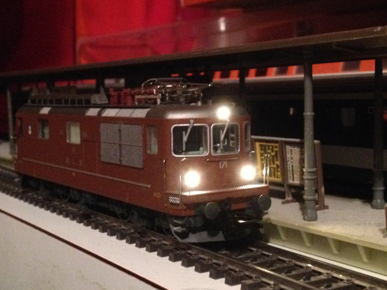

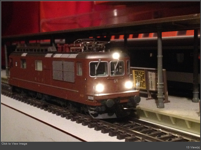

I got my 78781 the other day. I must say it is very nice. The AC model comes with a Zimo sound decoder, which sounds very good.
So far, I like the way it looks in front of my Rivarossi Goldenpass and Lima/Friho BLS Lotschbergbahn consists. I still have not yet tried it with my Roco EWIV consist.
The only downside is that the standard setting has the red taillight instead of the white one. It can be changed using the MS/CS but not with the 6021.
I thought that I would post a photo, along with a photo of the 2014 Rivarossi model (2101). The 2101 has brighter headlights. I don't remember if it was already LED or whether the Rivarossi still had bulbs. I think that the Rivarossi model may have milled light channels. I have to test it in the dark to see what the light dispersion (beams) look like.
The Roco model has high beams (F8), but they are still not as bright as the regular setting on the Rivarossi model.
I have yet to do a full function test using the Test function of my Lokprogrammer, which allows me to go up to F23.
