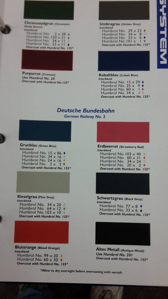

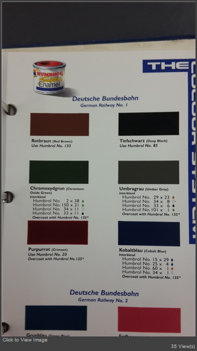

This chart shows how to make up some of the DB paint colours using Humbrol paints.
I'm not sure if the Green Blue colour is the one you want. The chart also shows Blood Orange.

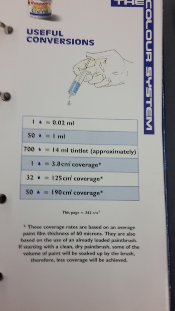

For completeness, I'm showing the other chart I have plus the measurement guide.
These were taken by phone camera from a Humbrol manual a local model shop (now sadly closed) had.
