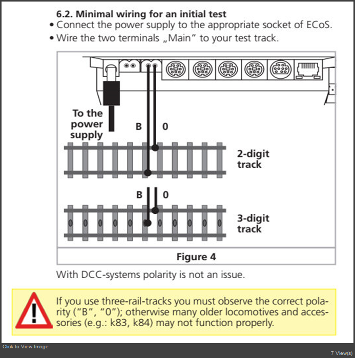

If I would bet, I would set all my money to the reversed connection. That's the classic fault with Motorola 1 decoders.
From the ECOS manual page 5:
Markus
