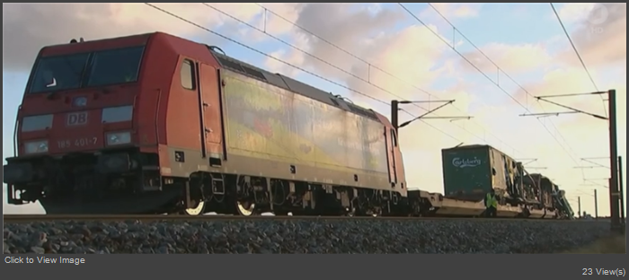

The current theory is that high winds had knocked on of the truck trailers off of the freight train that was loaded with truck trailers. This load fell onto the tracks, where the passenger train traveling in to opposite direction collided with. That could account for the damage to the remaining trailers on the freight train. High winds were present on this bridge, but not high enough to cause restrictions in traffic speeds or closures. A working theory is apparently that one of the truck trailers was empty, thus making it very light, and when the sideways winds hit it on the bridge it was blown off.
The unfortunate incident will certainly change the way Denmark regulates speeds and cargo over that bridge in the waterways connecting the Baltic Sea to the North Sea - its a very windy place at the best of times. Empty trailers might well be required to NOT have installed, but rather packed away side tarps, to allow winds to blow through rather than pushing the trailers.
Anyone that has driven on highways in high winds knows the feeling when a strong side wind pushes your car or truck sideways suddenly. Large trailers are more exposed due to the large sides that get pushed. If the trailer is empty, it can get blown over by a gust, and on a train that's no different.
(images from Tagesschau.de https://www.tagesschau.d...nd/zuguenglueck-103.html )
