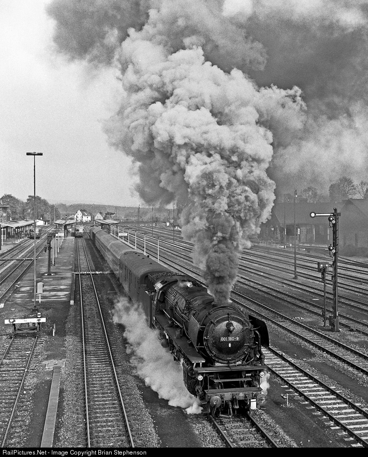

Came across this, thought it may help:
DB BR 052s in Herzberg, Germany, April 3rd, 1976. Note the bottom right of the photo:
Source: http://www.railpictures.net/vie...hp?id=550762&skip=-3
-Brandon

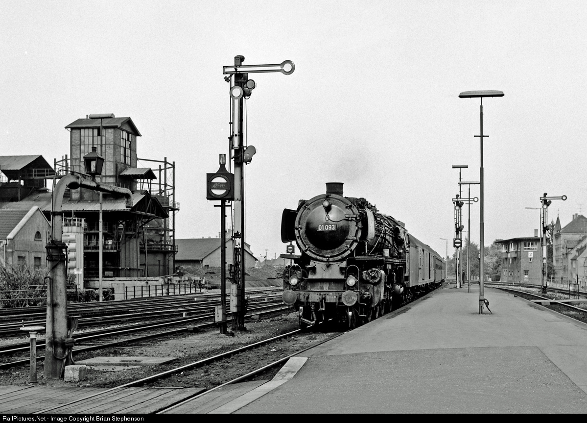

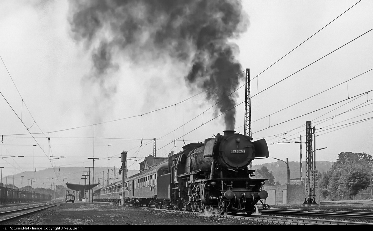

A couple more;
At the station neck in Merzig, Germany, 1973:
Source: http://www.railpictures.net/vie...p?id=535446&nseq=113
Source: http://www.railpictures.net/viewphoto.php?id=535445&nseq=114
-Brandon

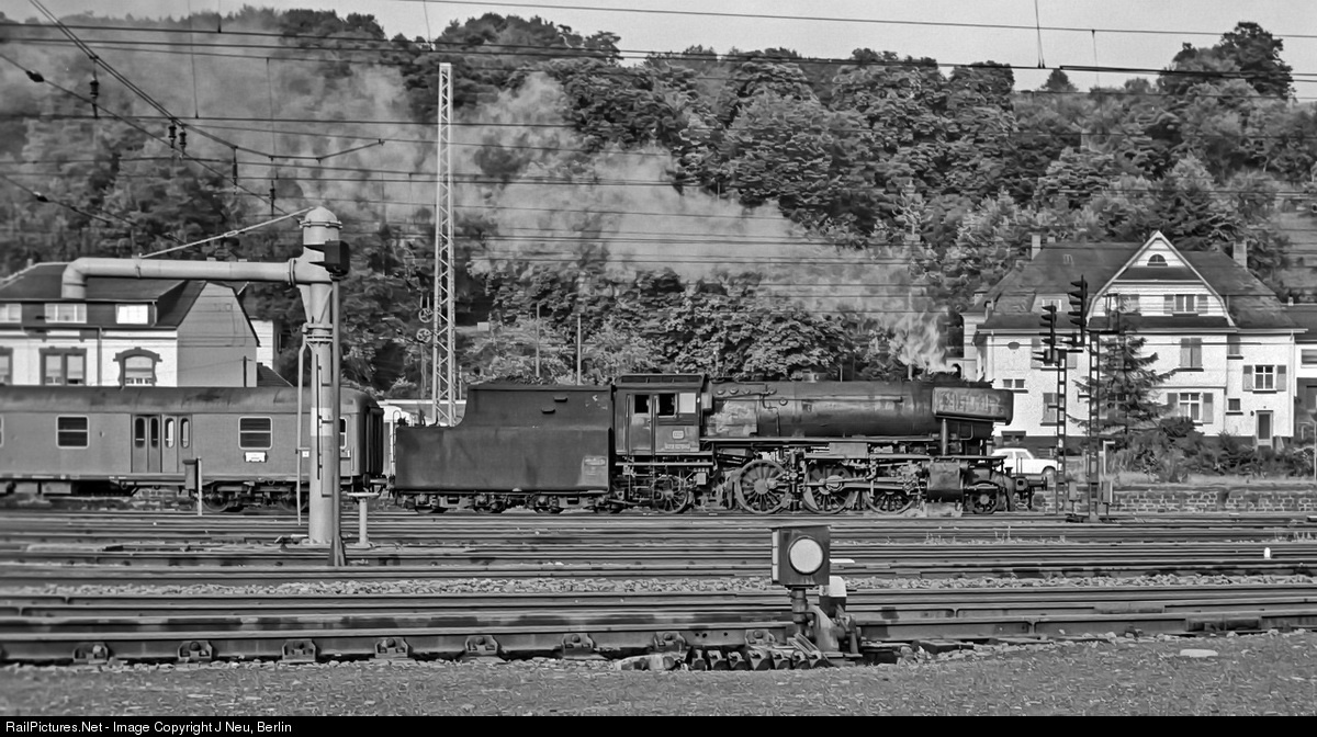

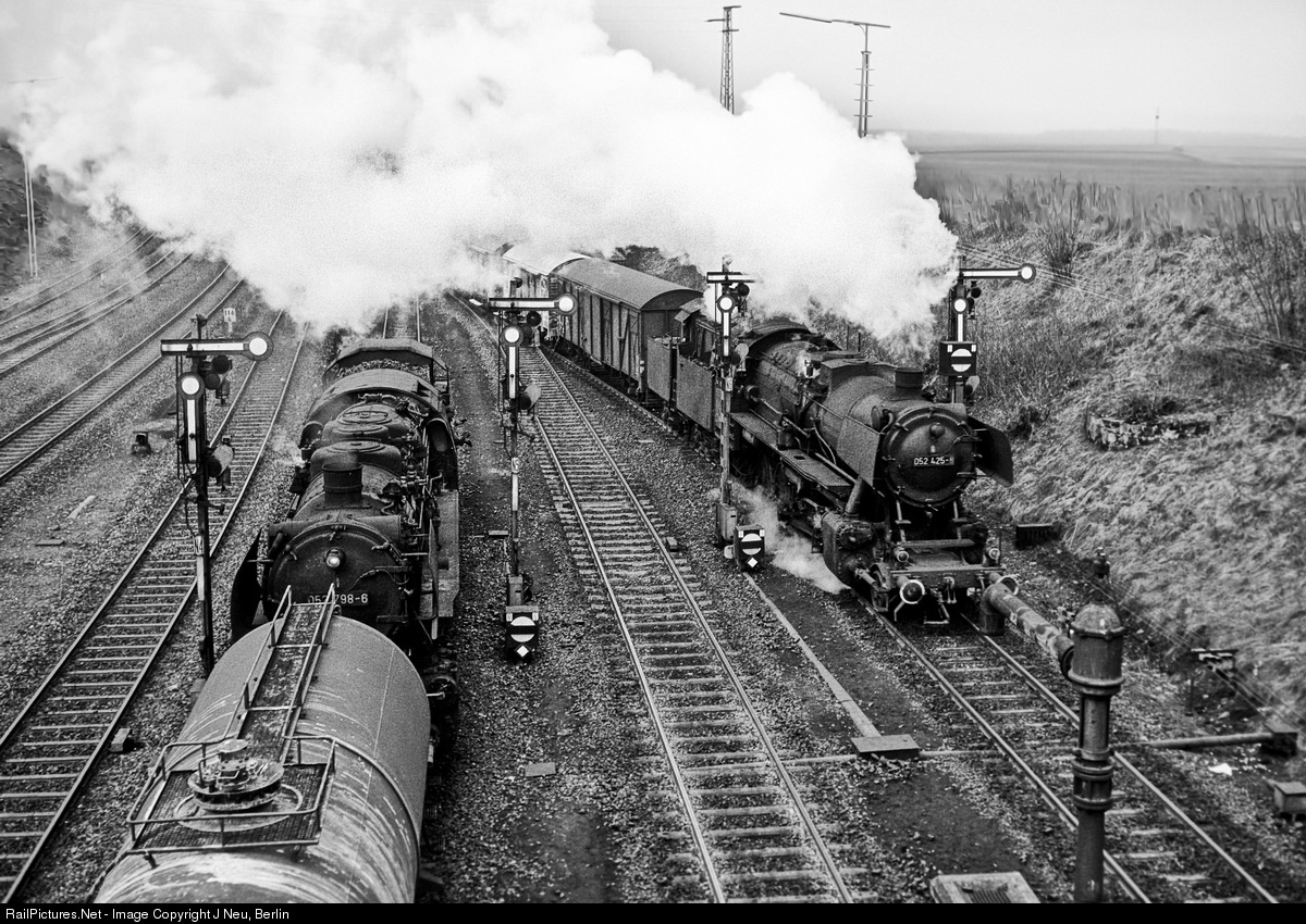

A couple more. I'm mentally designing the features of the station on my layout, this is of interest to me.
DB BR 001 in Neuenmarkt-Wirsberg, Germany, 1973. Water spout to the left in the middle of the platform island.
Source: http://www.railpictures.net/viewphoto.php?id=479874&nseq=330
DR BR 01 at Friedrichsaften, Germany, 1965. Water spout opposite platform.
Source: http://www.railpictures.net/viewphoto.php?id=493634&nseq=254
