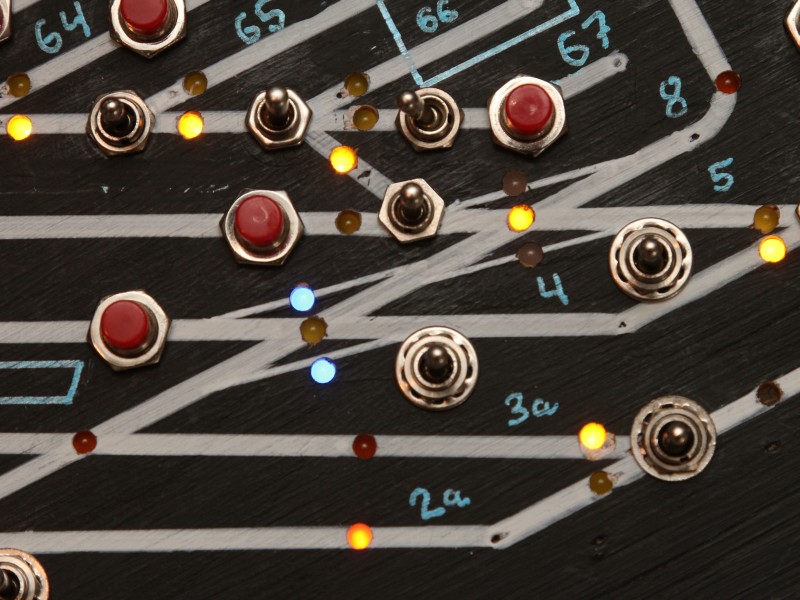

I use toggle-swiches on a drawn board. Analogue, with feed-back-indication LED:s.
Current layout:
The former project:
thanks 4 users liked this useful post by LeoArietis
That's looks great - what are the red buttons for? De-couplers?
When you say feedback LEDs, do they actually get the position from the points?
