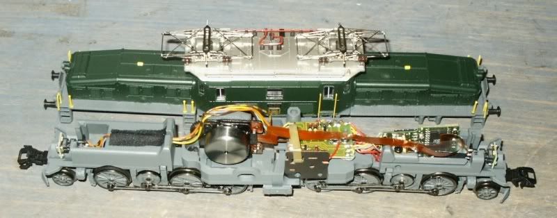

EUREKA!!! I got it open!
As stated, one of the hoods is more difficult than the other and it's the one that is more important since it covers the decoder.
Here is a pic of the crok on the operating table
and here is a detail of the "secret" compartment
#13 Posted : 17 May 2007 07:13:25(UTC)
So Mario, how did you manage to get the cover off, and was it difficult? Now that I know that you have succeeded, I'll have to have another try on my 39560.

Yeehar, I've got my cover off as well. I tried Svein's method, but to no avail. However, a flat blade screwdriver inserted into the gap just after the articulated join above the 2nd wheel(see Mario's picture), and wiggled around a bit, and hey presto the cover popped off. Can't see any evidence of the cover being put on when the paint was wet, but who knows.
