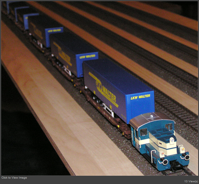

The 36809 prototype is of a privately owned V121 and was produced for 2006 as a MHI model. They can still be found for around 150 euro.
The models most noticeable feature is its size (or rather lack of) measuring only 7.4cm buffer to buffer. Despite its small size, it is still well detailed and and made primarily of metal including metal grab rails.

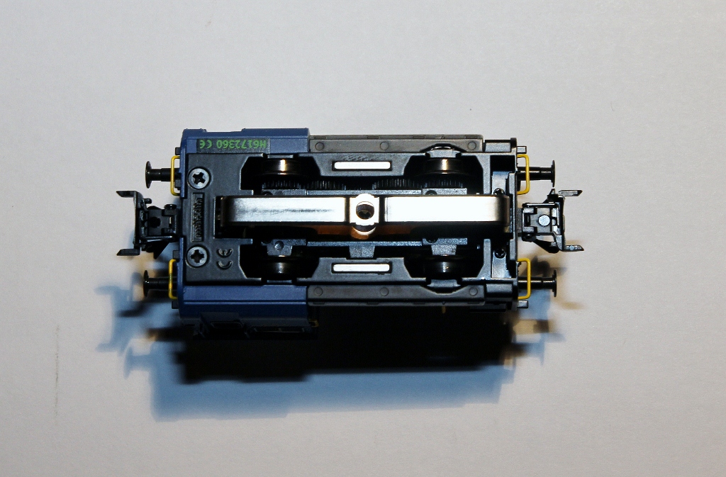

The model features a more basic FX type decoder mounted inside the roof of the cab. Basic functions can be programmed like acceleration and braking delays.
Power is provided via a miniature (controlled high efficiency) motor to a worm drive. Both axles on this locomotive are powered. As you can see from the photo as well, the connection between the decoder and the motor (as well as power/return) is done via a series of copper spring contacts. This allows the locomotive to be split with no wires connecting the two halves. Care should be taken when putting it back together to ensure none of these are bent out of position.

Another unique feature of this locomotive is its method of obtaining traction. None of the four wheels are fitted with tires. Instead, two small magnets are mounted to the bottom of the locomotive and place parallel with the rails. This provides additional "down force" for the very light locomotive.
Unfortunately even with the magnets the locomotive still lacks much traction. You won't be able to pull more than one or two relatively light wagons at once on flat grades (forget about any gradients). The locomotive even sometimes has trouble gaining enough traction on it's own to make its way across turnouts (I've only tested on C-track).
Adding some weight to the inside of the locomotive itself, or possibly even trying to fit a single traction tire may help. I haven't experimented around with this too much.
The lack of pulling power/traction will limit its uses on your layout, but it still serves as a good switch engine.

The locomotive features all LED (white and red) headlights and markers that switch with direction.
The "white" lights are realized with yellow LEDs. Red rear lights are always on when "white" headlights are on, double A lights are not possible.
As tulit wrote: just a basic fx decoder of the 60760 class.
The magnets are just strong enough to lift a piece of 24077 C track, so the extra tractive effort gained by the magnets is just about the weight of that piece of track (magnets may be more efficient on M track, never tested).

I have the slightly larger Kof III, and that can pull at least 5 wagons with ease, but I think it looks silly with a long train anyway!
I've seen Köf II handling 30+ freight cars - something you cannot expect from those tiny models.
The engineer moved single box cars by hand sometimes, without attaching the Köf II. The 1:1 cars roll easily and stations are normally absolutely flat (and those small 3xx class diesels were not allowed to leave the stations anyway).

My problem with the turnouts in this case isn't so much derailment, rather the locomotive gets stuck spinning all four wheels. A little nudge from behind and off it goes again.

Hi Tom. I will go back and confirm again the operation of the lights. I thought they had full switch over, but I may be remembering incorrectly.
Interesting point as well. I wonder how the traction would be on M (tin versions?) or even K rail? Unfortunately I don't have enough of either right now to do a test like that.

.....or possibly even trying to fit a single traction tire may help.....
You would need to fit grooved wheels, or have a groove machined into the existing wheels to be able to fit traction tyres.
An alternative might be to use a product called "Bullfrog Snot" (readily available in the US), which is a rubberised compound which you brush on to a locomotive's wheels while they are turning. Once the compound is dry, you then have a traction tyre. When it wears out, you repeat the process.
However, with such a small loco, I'd be worried that this might affect the proper grounding of the loco. You might end up fixing one running issue, but create another.

Yeah I think I've decided to essentially just leave it alone for now. I've been having much better luck with it lately not getting stuck.

Here's a quote from the manual:
In principle the pulling power for this model is limited. The maximum grade it can negotiate with 2 to 3 twoaxle freight cars is about 3 %.
Despite that, they sold trainsets with Köf II and two four-axle freight cars.
Even without grades, turnouts can be a problem even with short trains. So make sure the train gets enough speed before crossing turnouts.
I attach a picture of a Ka/Ks that was taken to the limits. It got that train going, but it came to a standstill with slipping wheels later on.

It has to be fast
The Köf II is amongst the slowest locomotives that were ever made (with respect to Märklin and prototype).
It is slow, it is a weak puller, it is finely detailed and nice to look at - and it can pull a few cars around a layout.
If you're looking for fast, strong, and cheap locos, don't get a Köf II.
Many digital MRR fans look for locos that can drive really slow, but at a constant speed.
