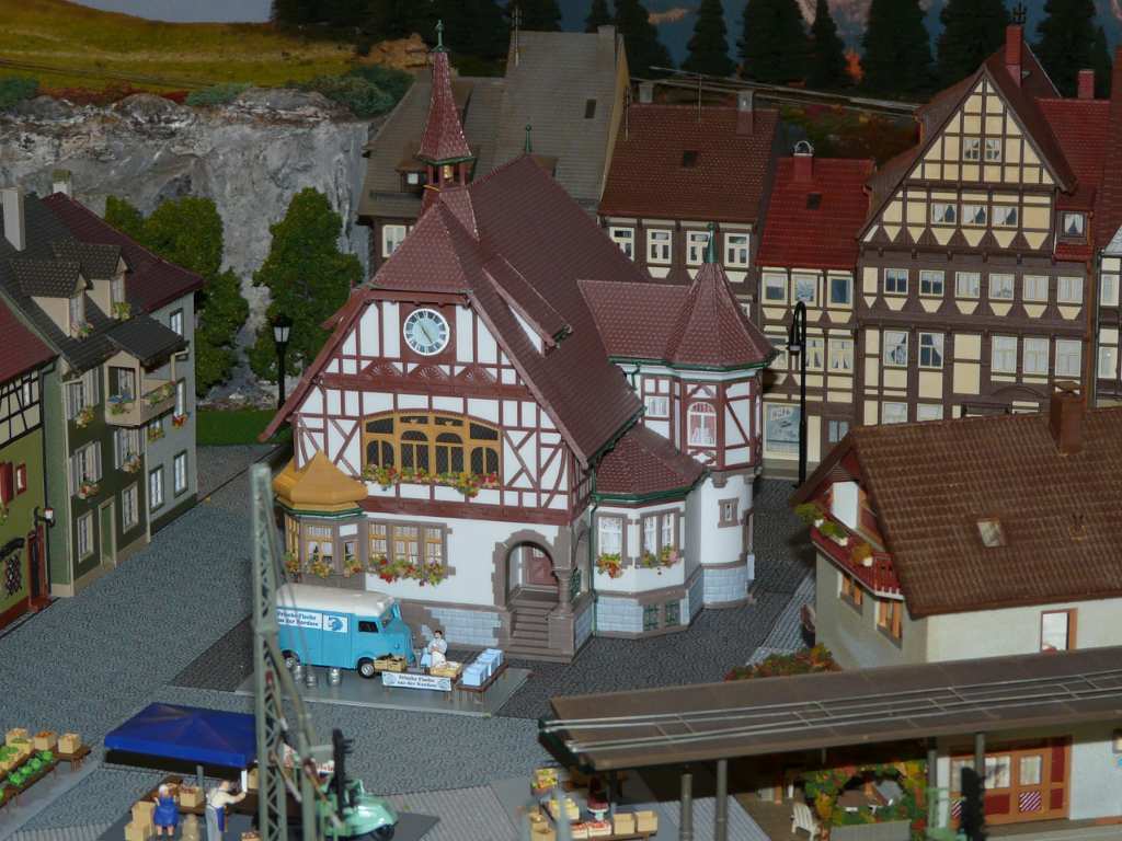

Hello fans,
Progress is slow this time, but results are becoming nice.
After struggling with my defective signals, I've setup the roundhouse locomotive shed and the beginning of automatic motion with the turntable.
Very nice leds illuminating inside (sodium light color like).

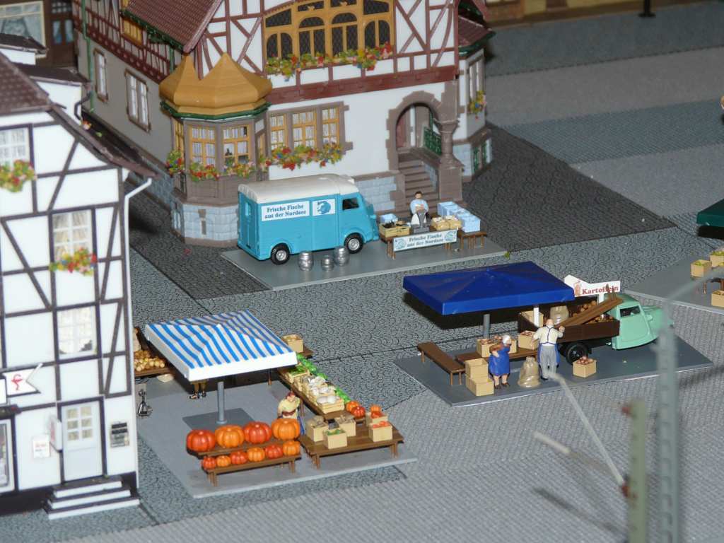

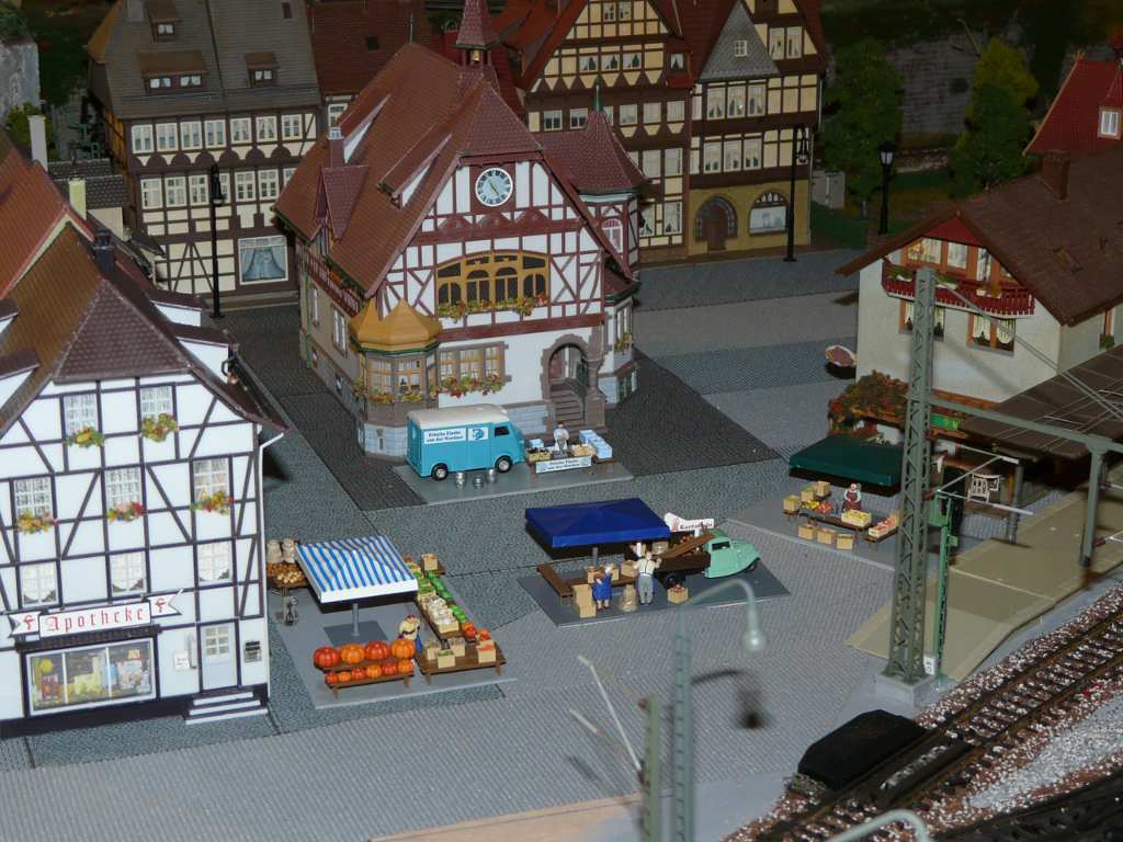

A few shots:
Closer...
Three old ladies waiting for carrying goods or people...
Closer...3048, 3310 and 3684...all upgraded with LokpilotV4
fabrice

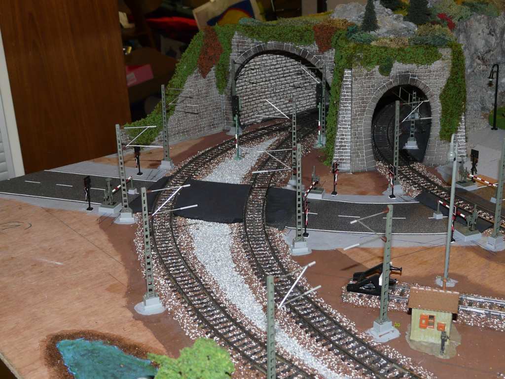

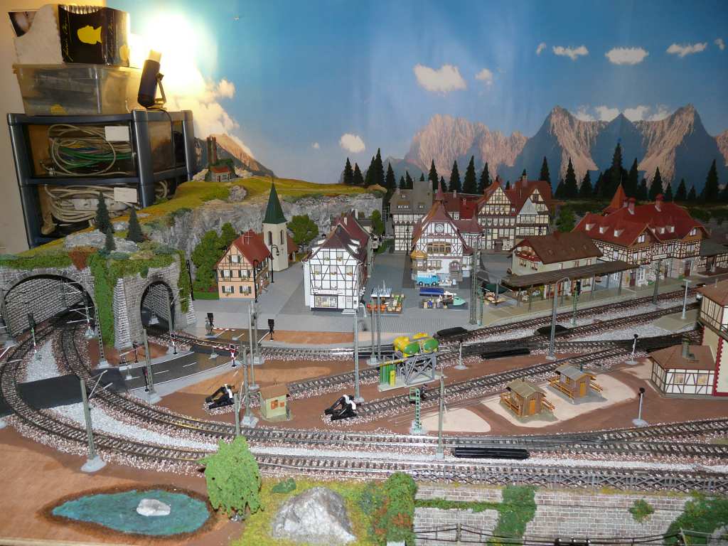

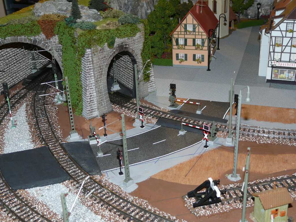

Hello fans,
Some news of the layout...
Because of having too much problems with M light signals, I've decided to remove them. After experimenting, my choice is done with Viessmann multiplex signals (472x series) which have a very close look to M signals, complemented by Vie5229 MM/DCC decoders.
This implies some new investment Crying ... and also to rewire the upper layer with removal of all upper tracks Bored. Before starting the works, I've taken my plan to update it, and as a natural consequence Mad , I've decided to modify a bit some tracks to add playabilityBlink.
The first variation add another line in the background, totally hide the descending ramp, and modify the switches on the right side of the station.
Here is the new plan:
But I'm also tempted to add more, with a second variation:
That's difficult to stay reasonable ...Cool
I'm still hesitating between first and second variation...The second implies more works as the plates are already adjusted and need 3 cm more width...
Stay tuned...
Fabrice
