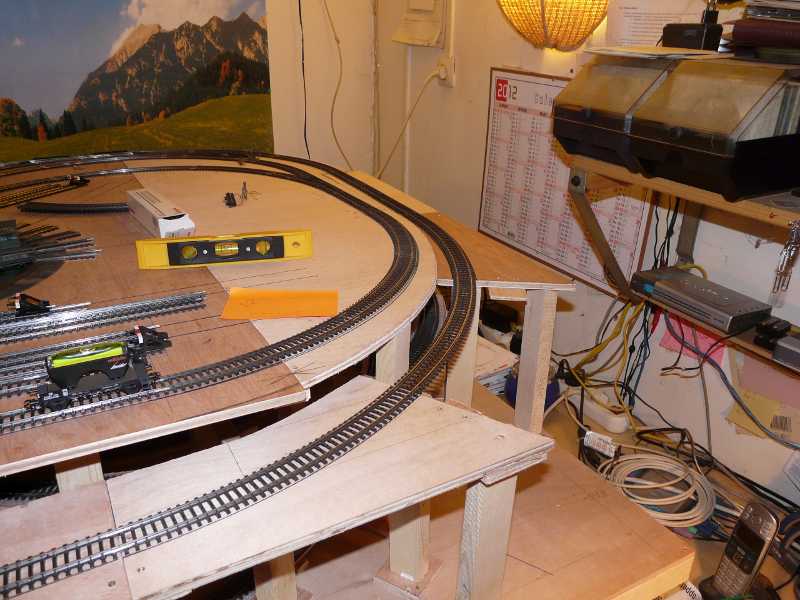

Hi Folks,
Regarding post #40 and the "emergency escape lane" (as found on some highways), I've done it.
See below:
Happily, the straight section between the left and right curved turnout had exactly the length of a straight turnout. So I put it, draw a curve (its end was exactly in the middle of a pillar -murphy's law ! Cursing ), then a straight line with a high slope.
A 7% slope...I hope it will be enough Bored
From an other angle...
I've done a test with a 3 wagon set and all went fine. They stop at the first 1/3 of the slope Glare...
I don't know if it will be useful, but I've tried to prevent some disasterMellow.
Still have to put some side supports in the aerial part of the ascending ramp...
Fabrice

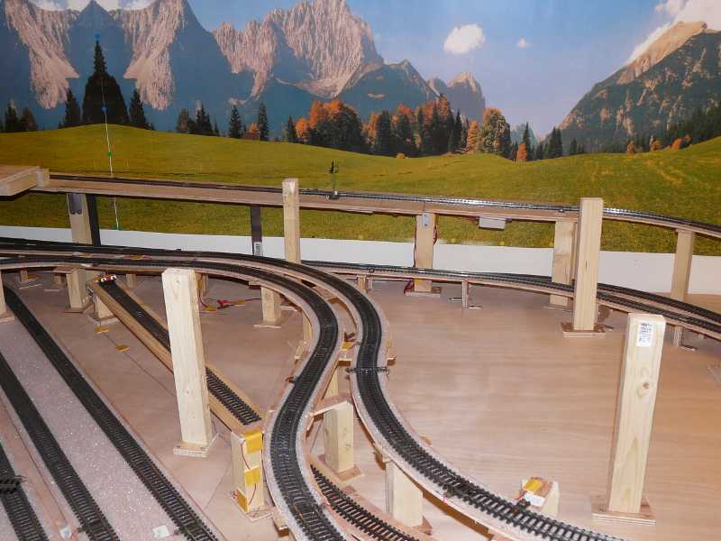

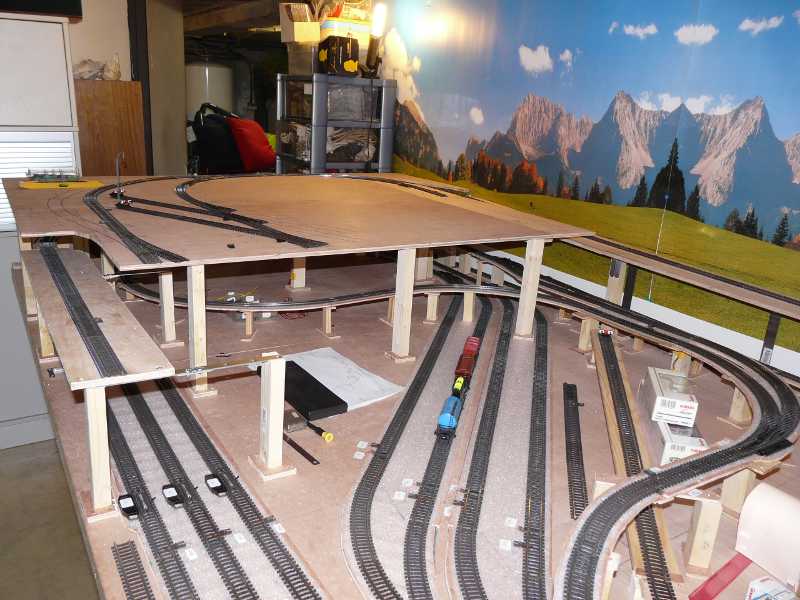

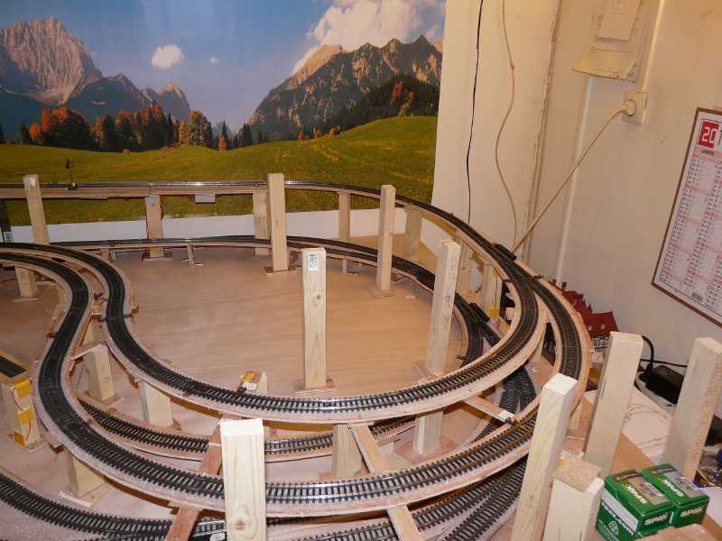

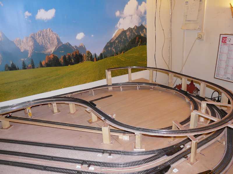

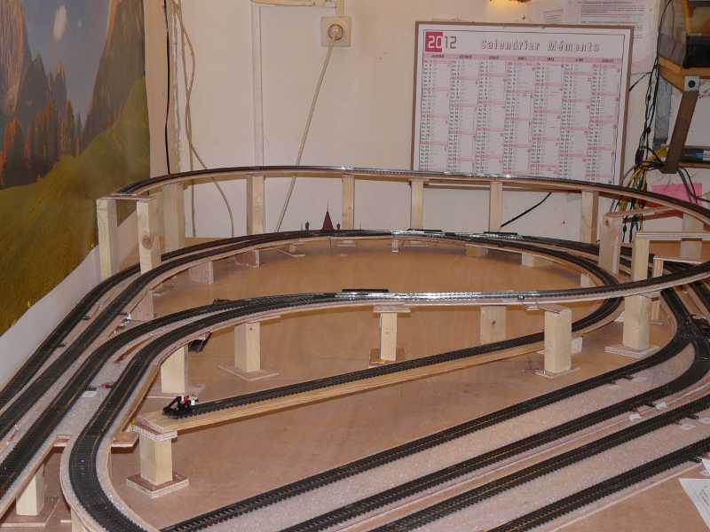

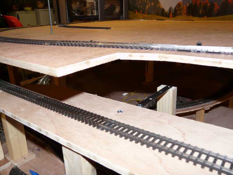

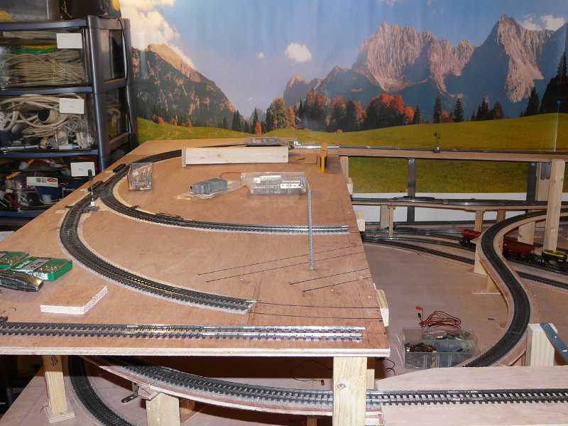

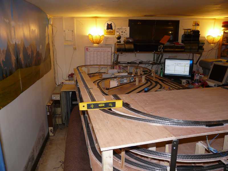

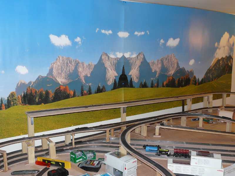

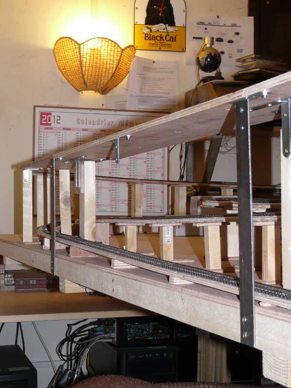

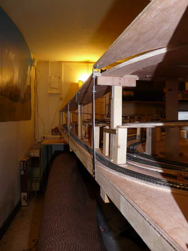

A few shots of the beginning of the upper level...
The long descending ramp...
First (of 5) upper plate...Placing the tracks
Curved track bed not yet done...

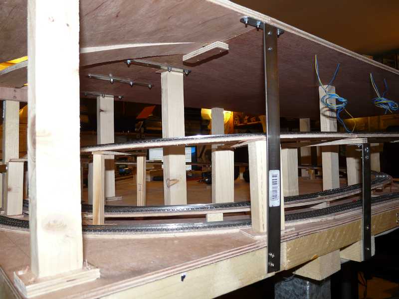

Detail from below...
General perspective of the descending ramp, still from below (curved track bed finished)
Upper level 2 first plate, from below, ...
Upper view...
Final overview...
Next step: start wiring of ramp and upper plate...
Fabrice

Very nice progress Fabrice, thanks for the photos !
Interesting structural system with the flat steel sections, it's "food for thought" ^^ ;)

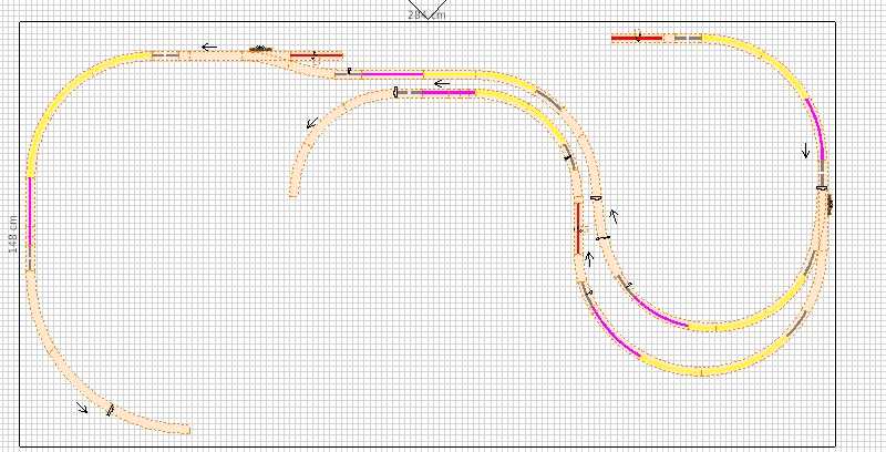

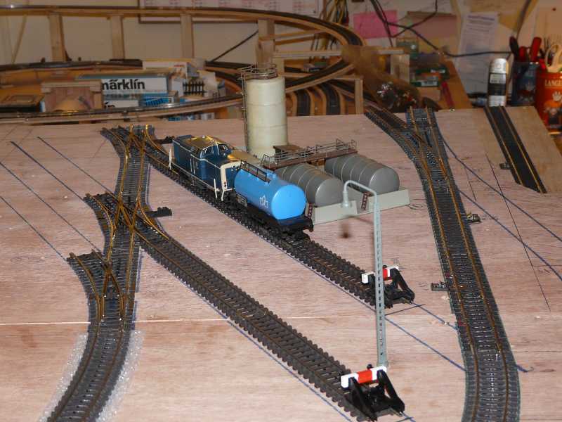

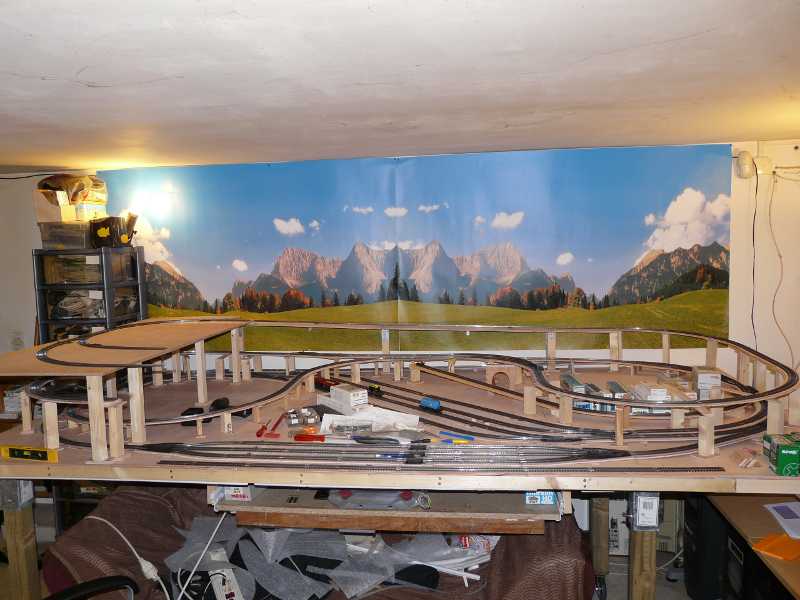

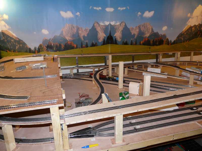

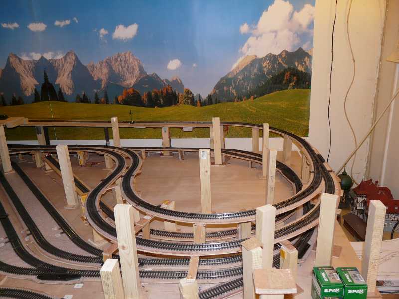

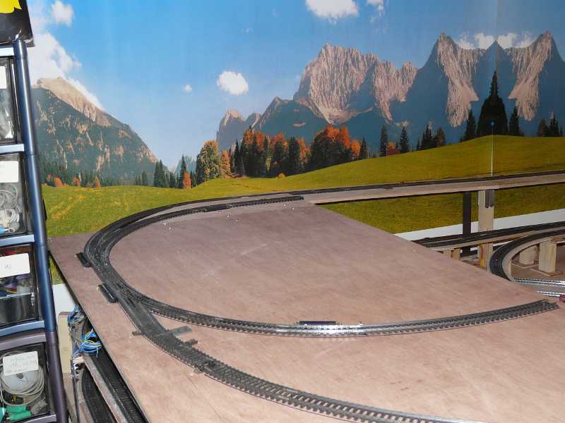

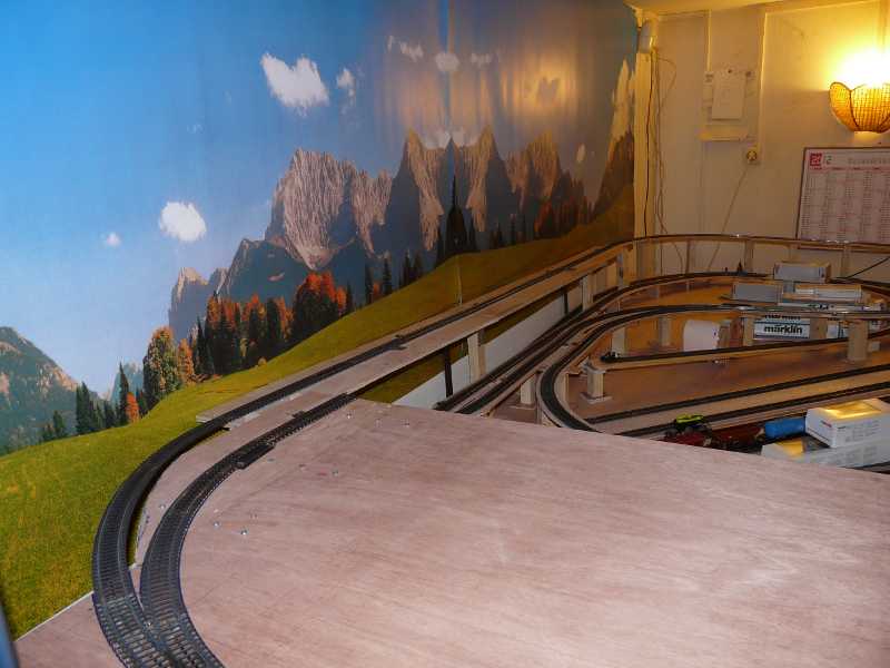

Hi Fans,
The week-end work started well...BigGrin
I took measurements for 2nd upper plate and prepared a piece of ascending rampGlare
...I even put a metal mast with led...very nice....and...
Crying The "disaster" occurred : not enough height between the ascending ramp and the upper plate to put a tunnel !Cursing
So I had to change the plan...Happily, I had only to reduce the curve radius, shorten a bit the siding and invert a turnout. Blink
The original plan is drawn in blue on the left hand-side...

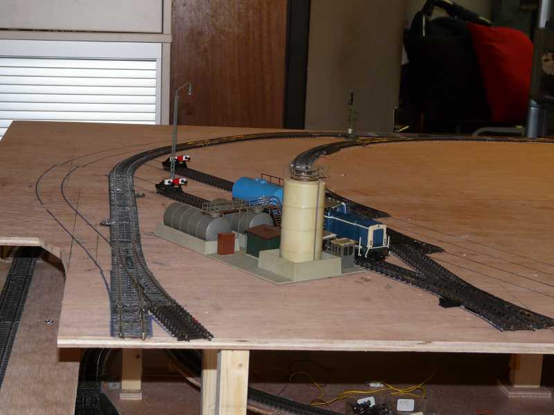

The fuel depot from rear...
Overall view. I still have to cut out a bit more the 2nd upper plate to allow a decent tunnel entrance.
This project is very compact, and this time I had luck to find out a solution for my very big mistake...
I hope I can finish the layout as plannedConfused . Maybe it's too ambitious for my skill level...But I don't give up!BigGrin
Fabrice

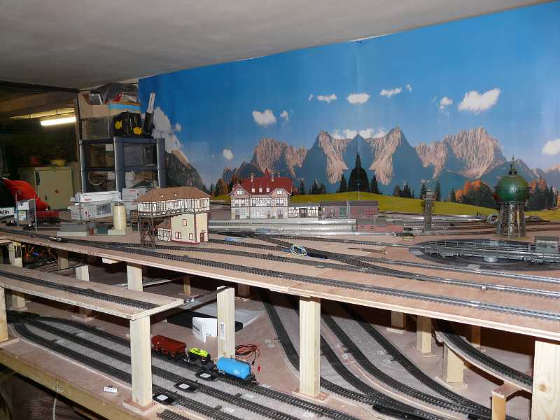

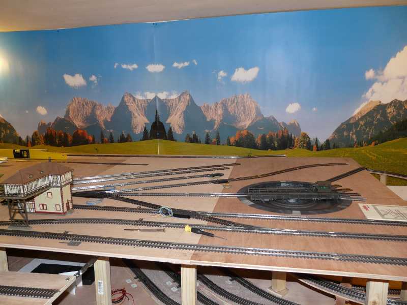

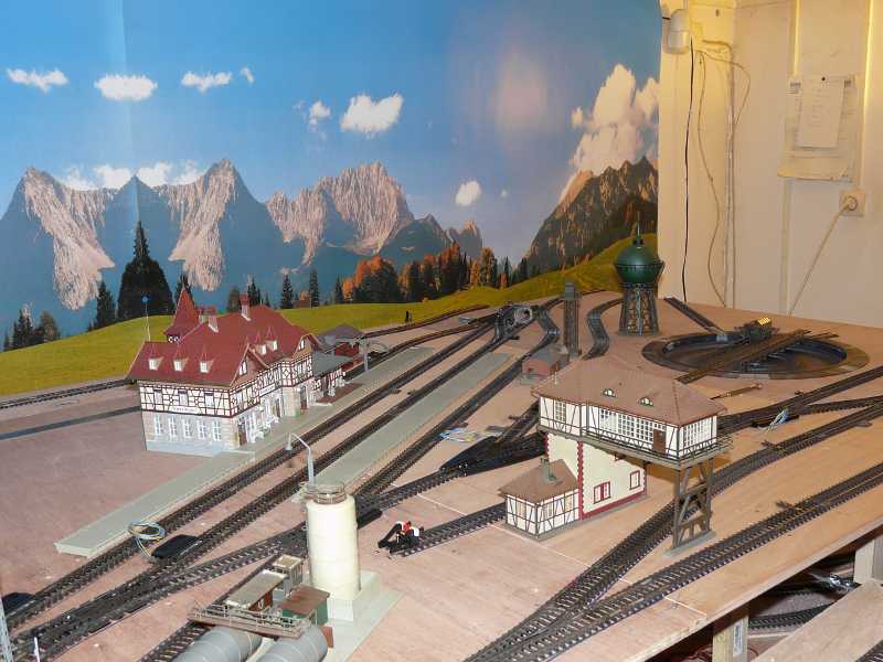

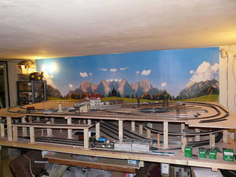

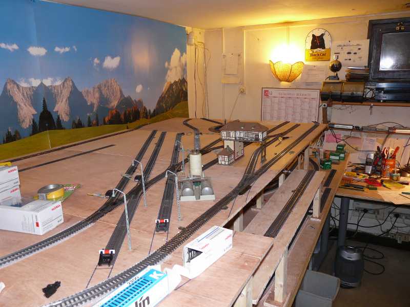

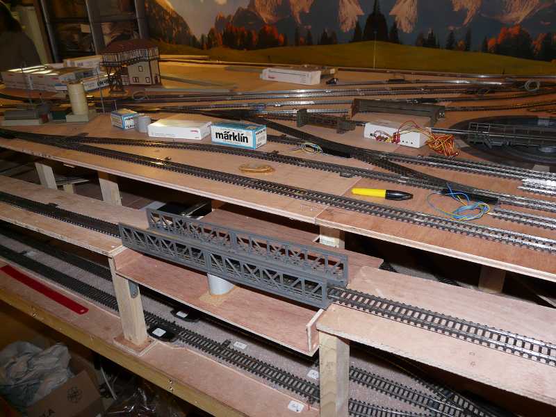

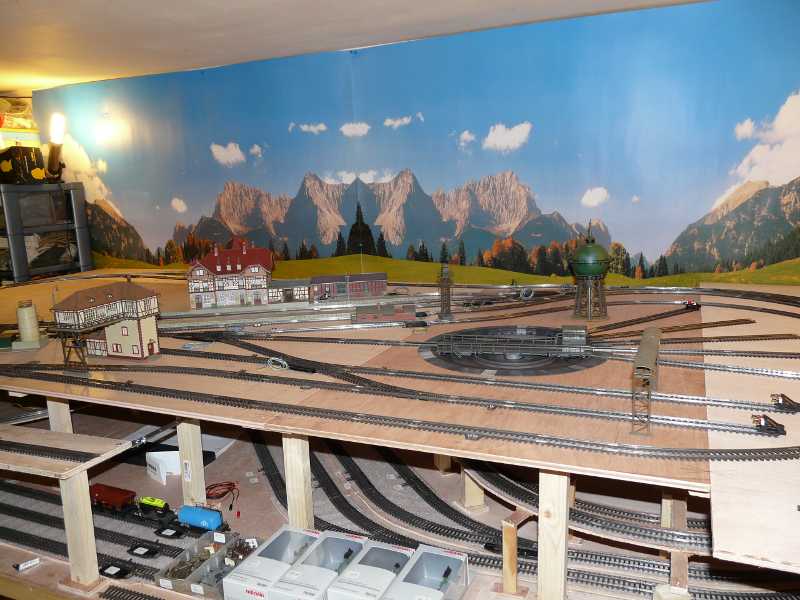

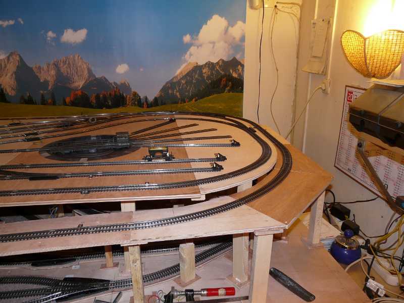

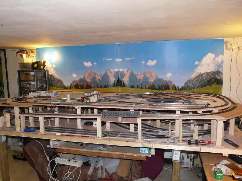

Hello fans,
Some significant progress this weekGlare ...Let me show you...

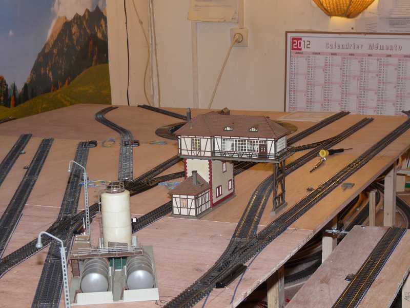

Fuel depot with light masts.
Closer look on switching tower.

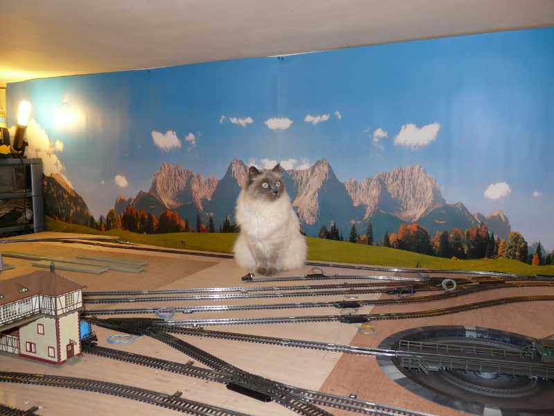

Placing station tracks. The turntable is also in place.
The station in background.
The station from another angle.

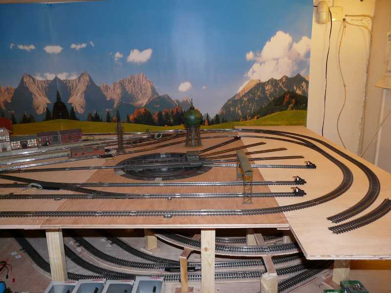

Turntable and last upper plate (draft version: cutting has still to be done)
Overview of week-end works...
Current state...
Still a lot of work to do, but the first rendering is interestingCool
Fabrice

@Juhan : The visible part is composed of most of the upper layer (Level 3) + the ascending ramp in the front part (still in progress). See post#1 - Level 3; you will notice also a small hill/mountain with tunnels on the rear-left part of upper level.

Nothing spectacular this week-end, except all tracks are connected !BigGrin
A few shots, as usual...
The bridge...
The missing link
The last piece of the puzzle in place
Ascending ramp : overview
Final overview of infrastructure
Inspector evaluating the resultsGlare ...Hmm, still work pending...not really finished!Mad
Next steps: have a break, think, wire, test all before starting tunnels, and later scenery...
Stay tuned.
fabrice

I just reviewed your postings and I am impressed.
I really like the metal brackets and metal straps you use for spport.
I've never seen that type of construction and may try that concept.
Rob

@Rob : The main reason which led me to use metal straps and bracket was the lack of room, i.e. the descending ramp is behind the wall (rear side), and the left hand-side is near the entrance of my room... The drawback is : it's more difficult to shape/cut/drill Crying ...and you need adequate tooling Cursing, but then it's rock solid ThumpUp
Fabrice

Works on hold...
Inspector is inspecting...
Laugh
Fabrice

Works on hold...
Laugh
Fabrice
Looks like she's saying:" Do you really plan to go on with this?"
Precious moment!Wub
My cat is only happy when trains are running.
If they don't she pushes them!BigGrin

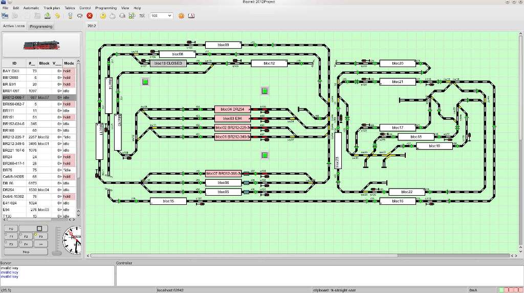

Hello fans !
No layout pics today 'cause no noticeable visual change.
I've wired all remaining main blocks in "draft mode" in the upper level and tested the layout with 10 trains running in automatic "random" mode BigGrin.
By "random", I mean the software (Rocrail) automatically chooses the available routes depending on block occupation and associated timers.
Quite impressive...OhMyGod
But when something goes wrong (for instance a turnout motor has a problemCrying ), I need to reset all the automatism, i.e. tell the software that loco XX is in block 12, loco YY in block 15, etc.
By the way, do some of you use feedback on turnouts with sensors or special motors or other means ? If yes, would you mind to provide me some link (or short explanation) if possible on this topic ?
Here's a pic of the schematics under rocrail:
Now, going to test again and change some parameters...
Fabrice

Hello Marklin fans,
After a lot of testing, I've had some trouble (derailment Crying ) with one switch and long locos in the hidden ramps (i.e. level 2). So I've decided to modify a bit the level 2.
During the modification, I've also added 3 new blocks to level 2. Now the total is 26 blocks for the main tracks (level1+level2+level3) without sidings.
Here's the new plan for level 2:
And a few shots of the results
It works perfectly now BigGrin
Now it's time to setup definitive wiring for the upper level.
Fabrice

Works on hold...
Laugh
Fabrice
I know why inspector is mad!!!
You haven´t cut out a hole on the worktop because you have underground rail yard.
So what happens if train set derailment and you cannot reaching trainset...
Offline French_Fabrice
#100 Posted : 16 April 2012 17:15:16(UTC)
French_Fabrice
Joined: 16/05/2011(UTC)
Posts: 950
Location: Lyon, France
You're right.
That's the main flaw in my design Blushing . I cope with it...
Fabrice
