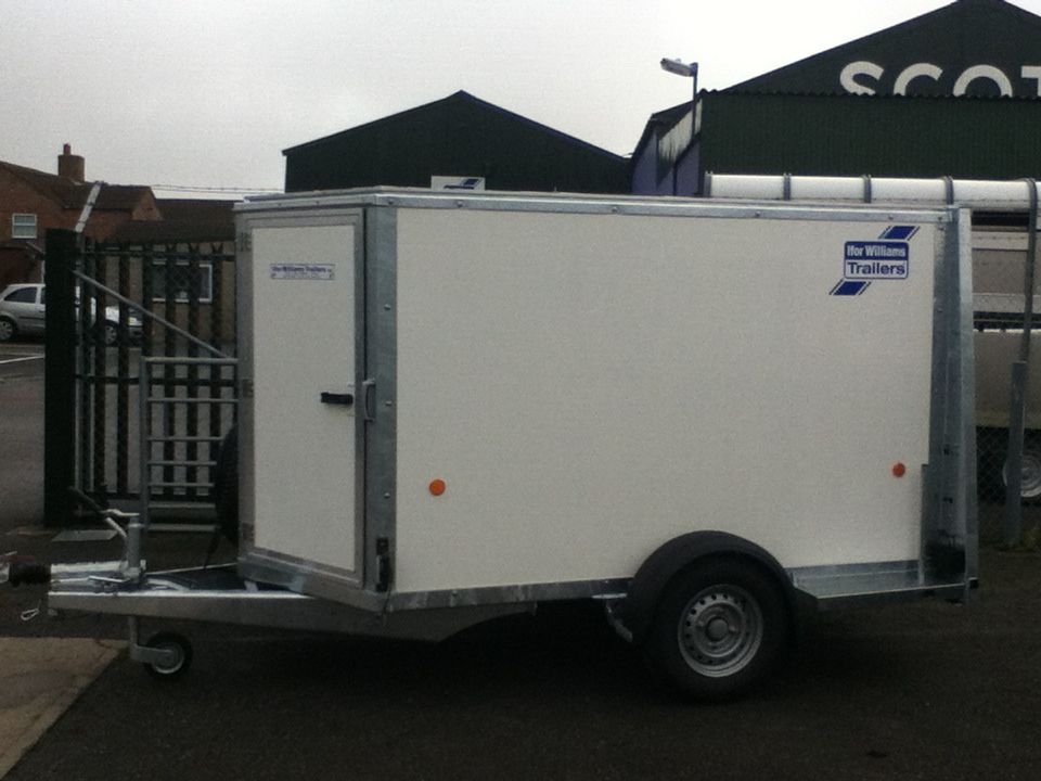

Hi all
Since the open day in July then there has been a ittle work adding lamps and things to the layout, but nothing more.
The big happening has been the arrival of the trailer to transport it in.
It is now at the supplier having the rails and the stops fitted to allow the modules to travel flat and secure.
It has opening doors rather than a roller shutter at the rear, so it gives more height in the doorway.
Once this is done there will be a trial fit and the applications made for Rushden and EurospoorThumpUp
The only problem at the moment is that I don't have space to park itBlushing Blushing Blushing

Mike,
Looks good!
You hauling that with your BMW? LOL
How do you protect your lamp masts, cantary, etc? Do you have something in place, or just careful handling?

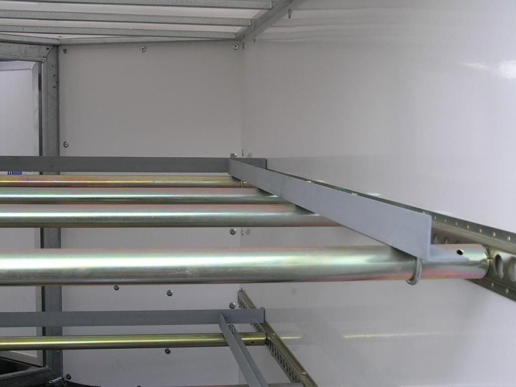

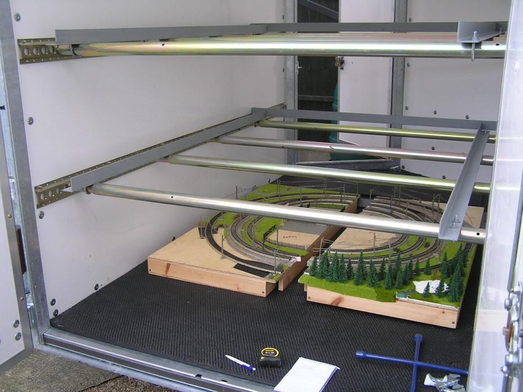

Hi all
It's been a while but in the time I have bought a trailer and finally last weekend brought it homeBigGrin
I have had some work done inside to secure the modules well.
As can be seen from the pcictures the two main modules will be slid in on the racking. The modules will then be bolted to the side frames to make them secure.
All I have to do now is get the modules in one by one and drill through the wood and metal.
The smaller modules will be screwed to framework on the base of the trailer.
The plan is then to surround the boards with upholstery foam. This will also be used in the building boxes to keep them separate and away from damage.
So guess who's going to be this Christmas holiday timeWink The first show is April in Rushden. Tick tock......LOL

Hi Mike,
Looks a very neat and tidy job. ThumpUp
You will need to check the trailer tyre pressures when running with very little weight on board so as not to have the trailer bouncing around when moving, talking from experience here, the Firebirds trailer when empty really "dances" about, this was helped a lot by reducing tyre pressures.

Hi Ian and Marco
ThanksThumpUp and thanks for the tip IanWink
The trailer is an Ivor Williams trailer - quite a popular make in the UK and bought through one of their local agents. This agent then adapted the inside to my requirements with all the racking.
The racking long grey bars are adjustable for width and held to the cross poles by exhaust clampsWink
The front brace is bolted across the trailer so I can't push the modules in too far. However the bars are removable should I need to fetch a new freezer/washing machine/sofa etcRazz

Mike,
I just wanted to say that the trailer looks excellent, very professional, ThumpUp ThumpUp ThumpUp
I think you should publish your intended shows early so we can book space in our diaries, we want to be there to help support your display. Any news from Eurospoor? It would be awesome if you could display there...........

Hi all
My first show is now close - 26th April in Rushden. The weather has been a little damp and windy over recent weeks so no work got done on preparing the trailerThumbDown ThumbDown .
Finally last week the weather broke and I was able to get the main modules in and drill them for fixing to the rails.
I also managed to plan how to fit (the majority) of building boxes in to the trailer.
The next few pictures were taken at the Brighton Toy museum, under the Railway station. was pleased to see the M* product well represented.
There were also a number of Dublo models and layouts. So just for Ian555;
cheers

Hi Mike,
Wow, very nice ! Thanks for sharing the trailer and museum pics. ThumpUp
You are living my dream. Just what I want, a nice layout that I can take along to shows.
Marco

Hi Mike,
It looks really good how you have managed to get your layout into the trailer. Very professional way to do things. Also thank you for posting the photos from museum ThumpUp . I really like how well that old Swiss HS model was made back in those days (1936?). I have a Märklin AC compatible 3-rail analog Liliput Swiss Ae 4/6. So it is easy to see when comparing it to that old Märklin model it has many nice details from the real prototype. And it is 78 years old...
Janne
