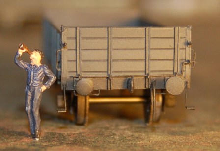

Looking at the wagon, the left hand buffer is rounded, the right hand one is not. My buffers started life as 0.5mm styrene punched out with a sharpened brass tube. 1mm styrene rod was glued on for the shafts. Once the glue had set, I put them in my cordless drill and shaped two buffers into rounded ones with a file. These were then glued onto the wagon.
Signal brackets were also attached, sourced from my box of pre made parts. The lock for the door was also made up and attached.
The brakehouse is not only for decoration(although it looks cool), so the brakes were next up. Brake blocks were again pulled from my little box of parts, and wire brake rods and styrene hangers were attached to them. because I can, I modelled the brake rigging as well, again using styrene and brass wire.
Note the absence of air brake equipment, which was not deemed neccesary on these wagons. Once everything is bacck up the right way, this is the view you get.
That just leaves a few final few details to do, and then it's time again for some airbrushing.

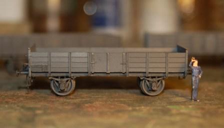

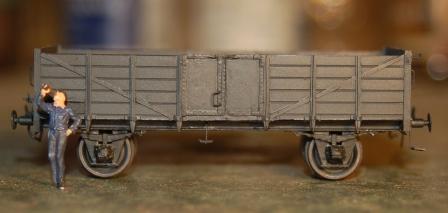

Following on from the last post, details were added. All the usual stuff, hand grabs, stirrup steps and the like. Having a brakeman's hut, one corner required a more elaborate step, the bottom two steps soldered from nickel silver strip and brass wire. The top step is styrene, and sits on one of the buffers.
And that leaves the wagon finished and ready for painting.

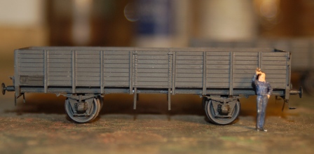

When the luggage trolley recieved it's primer coat, the wagon recieved a coat of grey. This weekend the underframe was done in black, and on the following days small details were touched up. The roof also got a sand colour. The area didn't warrant an airbrushing session, so it has been done by hand. This is the result, ready for a coat of varnish.
Between painting I have started an exiting new project, more will follow soon.

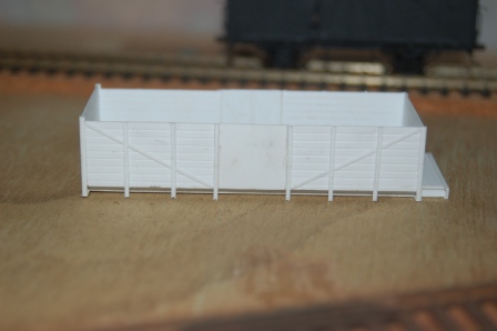

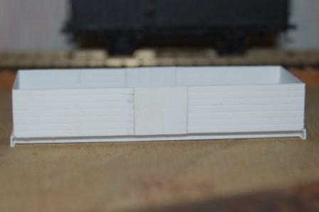

I've been busy over the last week, but here is the story of the next coal wagon. It will be the last 10 ton one for now, being built for the Noord-Brabant Duitsche Spoorweg Maatschappij (North Brabant-German Railway Co), NBDS for short. The class has the running numbers 35816-35846, built in 1873 by Werkspoor.
The usual method was followed, and this is the result of the weekend's modelling;
The basic body is complete and runnable, ready for detailing.
Buffers were also made up. These take two days to make, as the glue has to dry fully before continueing.
Discs of styrene are punched using a punch made from a brass tube. A short length of 1mm styrene rod is glued to this.
Once the glue is dry the shank of the buffer is held in the cordless drill, and using a file the burrs are taken off, and every second one is filed round, which is easy to do with a reasonably sharp file and the cordelss drill going. This method is pretty quick and easy to do. As buffers are another of those standard parts, more are made than will be needed, which speeds up the building of later wagons
That's all for now, more will follow soon.

Tuesday saw the rest of the details being added. some from my box of bits, and some made to suit, finishing the build of the wagon, done in just four days.
Some details on the end of the wagon;

As mentioned before, it's time for another little break. This involves more styrene, in the form of another two coal wagons.
Like most others, the various Dutch railway companies started switching to heavier wagons after a while. The next step up from a wagon with a 10 ton capacity was a 15 ton capacity. These were given the classification GL and numbers in the 40000 range. The first is one from the series 41167-41176 built by the Nederlandsche Rhijnspoorweg Maatschappij(NRS) in their own workshops in 1887. The other wagon is from the larger series 41861-42159 built for the SS in 1901.
Both were started at the same time, being built when I didn't feel like picking up a soldering iron. All the usual methods were followed, resulting in the basic bodies:
First up is the NRS wagon. More or less a stretched out 10 ton wagon.
This wagon had me looking from the frame to the drawing and back a couple of times, because the thing is almost two metres longer than a 10t wagon, while the wheelbase was more or less the same, resluting in a lot of overhang on the ends which is not common on the little 10t wagons. I also managed to find a photo of this wagon, which makes the details a bit quicker to make.
The other wagon;
This one's a bit younger, and looks a bit sturdier and more modern as a result. It is a fair bit wider than the others as well as having removable sides, so instead of channels, the sides are held together by steel with a T-section, which was easily made from a bit of 1x0.25 mm and 0.5x0.25mm styrene. Having steel doors, rivet strips were made and glued, which the other wagon recieved as well. My rivet strips are made from 0.75x0.25mm styrene into which the rivets are punched with a scriber. It's a tedious job, but the results do pay off.
Both wagons have an almost identical running gear, being the more modern W1 type axlebox from my DIY resin castings and 15 ton springs, which are longer than 10 ton ones. W-irons are the more modern trapezium shaped ones found under most four wheeled goods wagons on your layouts. The only diffrence between the two wagons are the spring hangers, which are the HSM type on the older wagon, as the wagon became property of the HSM once the NRS was split up between the HSM and the SS. The SS wagon, of course has the SS type spring hanger.
Unfortunately you'll have to imagine this for now, as I didn't make any photos.
Details are next up, but that will be for another posting.

On the wagon front, progress has continued. A good bit of work has been done on the NS 5301 has also been done, but that is for later.
Detailing was relatively easy, as I had a photo to work off, and I have a more detailed drawing of the other wagon. This eliminates hours of searching for simular wagons to build up a plausible guess as to how the wagons looked. Fortunately most details on these wagons were more or less standard, and the SS went on a widespread standardisation program in 1902 for it's older wagons, making my life a lot easier.
And this is how the dressed up wagons look:
First up the NRS wagon
And a view of the end
Looking at the door details, and the suspension. These W irons are a lot easier and quicker to make than the open ones. Note how the springs are a bit longer for these heavier wagons.
And the younger SS wagon
The end again
Something that hasn't recieved much attention, although all the wagons have it; interior planking
Now it's off to the paint shops again...

I got around to painting the three coal wagons this weekend, nothing unusual except for the varnish being slightly unwilling to co-operate, but I won that fight
First up the last 10 ton wagon:
Next up is the medium weight category. On the left we have the older NRS wagon, and on the other side the considerably wider SS wagon.
The NRS wagon from the side:
And the SS wagon also posing for the camera.

The same old process was followed, with the diffrence that the ends of the underframes were made out of 3.2mm channel, which fits nicely over the 2.5mm channel used for the solebars. The use of steel channel was introduced on more modern wagons, a result of the continual increase of the weight of trains being hauled. This wagon also has a brakeman's hut, which will sit on the extension of the frame.
The trickiest part of this wagon was the doors, which have been pressed into a flat pyramid shape for extra strength. This was mimiced by scoring grooves in the backs of the doors with a hobby knife, getting deeper in the middle. The result is not very visible in white styrene, but that will change after painting.
The other wagon was a case of more of the same;

That worker is a troublesome one actually, he's the workshops foreman but I never see him doing anything else but drink....
I use an airbrush to do most of my painting, but touch ups are done by hand because it is quicker and just as good for small details. using an airbrush gives a way better result than an paintbrush and the coat is nice and thin so you don't lose any detail.
I draw up my own decals on a program called Inkscape. I have the appropriate fonts for rolling stock and locomotives, and the symbols are drawn up pretty easily as well. It has a built in trace function which is very useful for making builder's plates and the like. The only downside is that the program is not very good at drawing shapes to given dimensions like the CAD programs I sometimes work with are. I have thought of a way around that, although I have not got around to doing it yet.

Something has happend in the workshops as well(besides drinking beer
It mostly consists of adding rivet strips to the doors, and filling up some empty space on the youngest wagon with a brakeman's hut.
The brakeman's hut in detail.
And the HSM wagon
As you have probably noticed by now, the next step will be adding some wheels, but that is still in the future.
