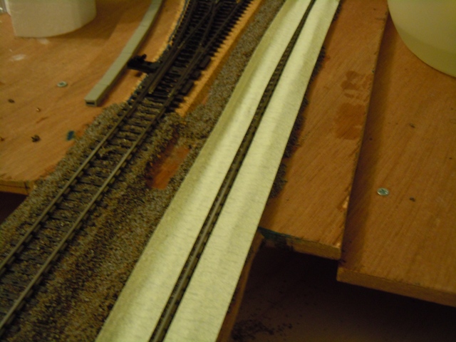

Thanks all for all the encouragements!
Originally Posted by: Caralain Go to Quoted Post
Hi Rinus:
Nice job on the ballasting. By experience I know it takes a pretty long time to finish this task, but you will be rewarded by how fine your tracks will look at the end of this process.
I am just curious: do you have any problem with the studs of the third rail? When applying the glue, ( I personally use an eye dropper), there is always a small layer of glue that drys on top of the studs, despite all the precautions I can take. This thin film doesn't allow a perfect contact for the loco slider, and I have to clean the studs with alcohol or I use an hobby knife and scratch gently each stud. What is your experience with the studs and the ballasting process?
Keep the good work.
Pierre
Hi Pierre,
I see what you mean. I prefer cleaning the studs with alcohol or a cleaner with the help of a towel. Using harder materials usually scraps the coating away and makes the metal visible.
Rinus

Rinus,
excellent job,
a hint or two: for faster results.
I use a toothbrush to get rid of exess ballasting and use purely a spraygun to do the ballasting, 50% woodglue, 50% water, 2 or 3 drops of detergent (per liter).
the end results are without cork underlay: the track after many years gets a bit rusty and the middle contact tongues are slightly oxidiced (shouldn't happen with the stainless steel connectors).
with cork underlay: the excess glue is absorbed by the cork and the track connecter, tongues are as new.
regards.,
A spraygun? Never tried, but it seems wothwhile to give it a try.
Instead of a toothbrush I use four brushes:
1. one large and stiff one to spread the ballast
2. one small and stiff to profile the ballast bed profile
3. one medium soft one to clear the sleapers
4. small soft one to free the inner rail
To prevent rust, I avoid water and replace it with pure alcohol. same for the glue. instead of water based woodglue I use a primer, which you usually put on walls before plastering them (sooy I dont knwo the exact english word for it, but in dutch its called 'voorstrijk'Blushing ).
Rinus

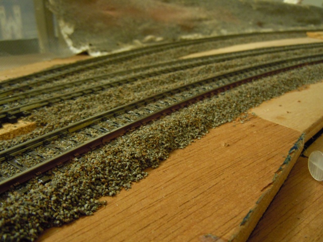

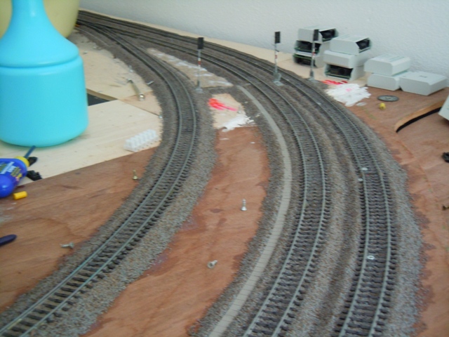

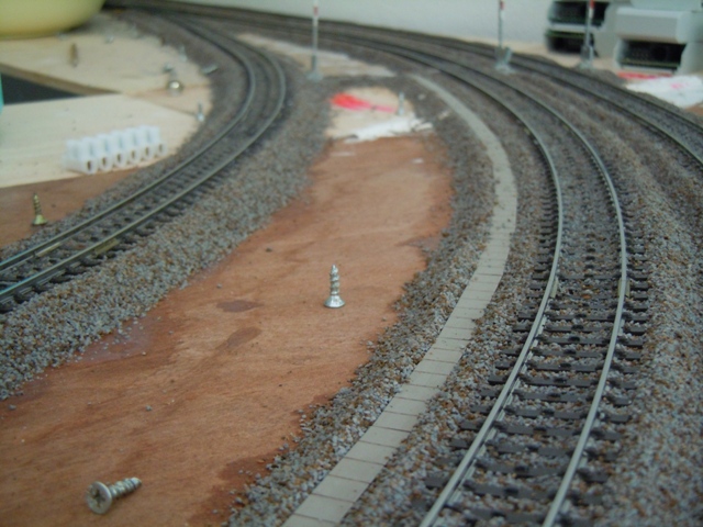

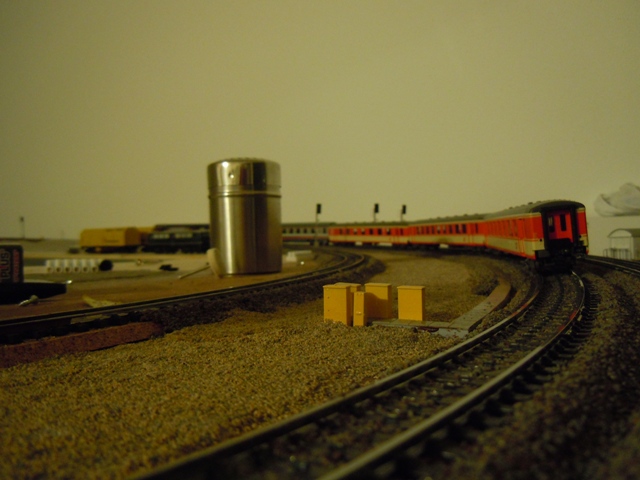

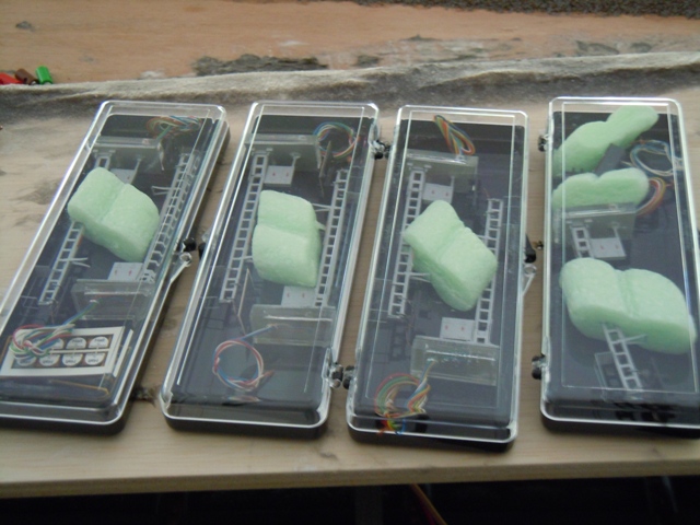

My friends the ballasting is done! I've become a different person in the procesBigGrin .
to be honest I still have to do the switches and some sections in the station. but thats no big deal. I plan to do the airbrusching of the tracks next weekend. I've been practicing on the cable gutters and the platform sides.
I also received a shipment of signals! Love from Krois. This included the platform sides (lasercut) as well.
Still struggling to get the puko's cleaned. I've decided to use the rail gum. downside is it will remove the dark color of the puko's and make them shiney any tips here?Confused

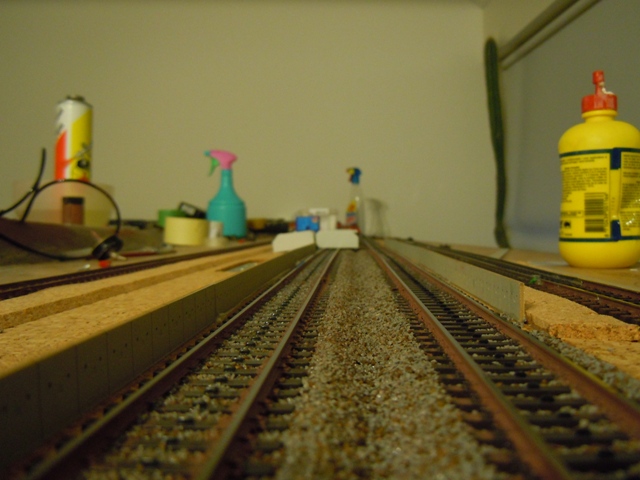

Enough words, some pictures!
# 1 Station. One side is kept free, I'll instal the platform first and ballast the remains later.
# 2 Notice the concrete cable gutters! They are from Auhagen

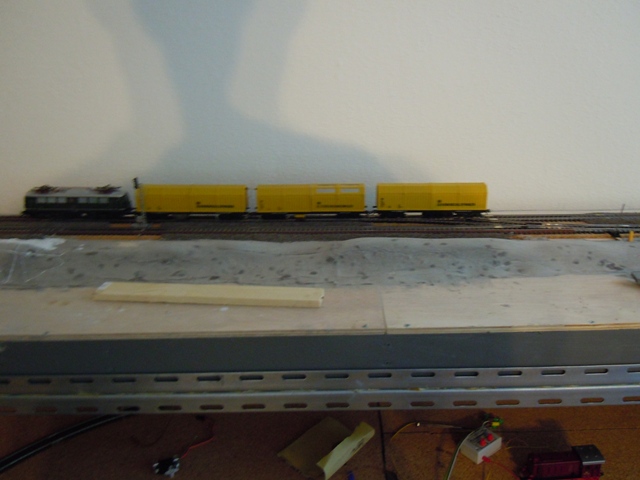

# 3 Signals. Intermediate sections is still drying. Its a footpath, made of fine buff and light gray from Woodman.

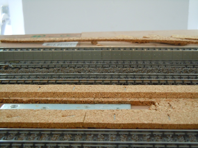

# 4 Platform sides. These are from the Krois Lasercut series. Extremely cheap and good looking. I airbrushed them with concrete color.

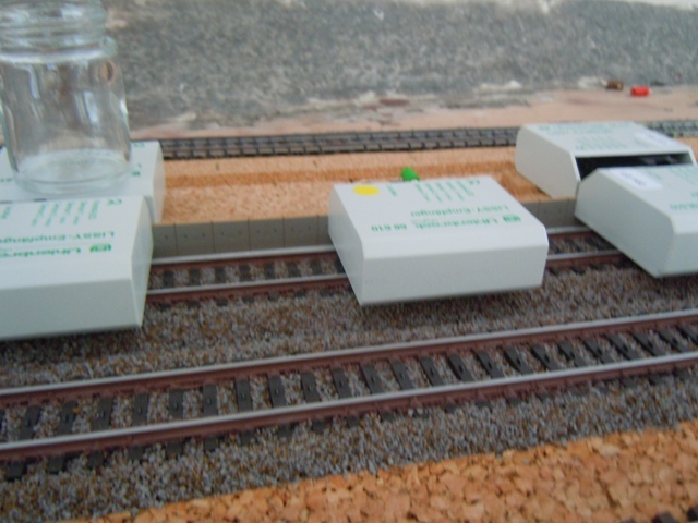

# 5 Signals. I bought the rest of the ÖBB signals too. I'll install tmen after airbrushing the tracks. They are from Krois, handmade and all metal. equiped with LED's. Expensive? Nope, just around 20-30 euro each.
Enjoy reading, and don't forget to post a tip on how to clean the puko's after ballasting if you have a good one! ThumpUp ThumpUp
Rinus

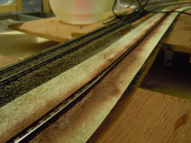

Last week I've been airbrushing the rail. I applied a rust color. due to some internet problems I couldn't post them earlier.
First I covered the 3rd rail and ballast with tape
Apply spray
Result
After the painting was done, I started with installing the platform walls. These are from lasercut carton. I airbrusghed them in concrete color.
Rinus

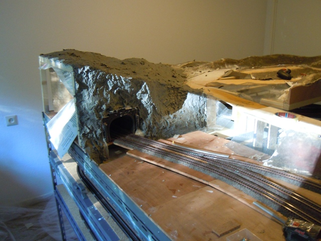

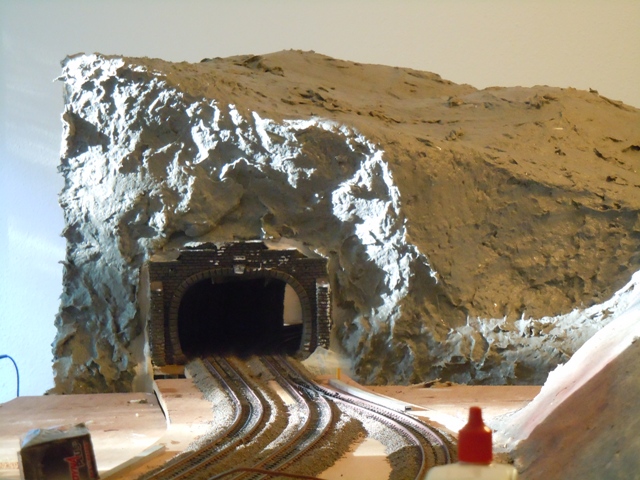

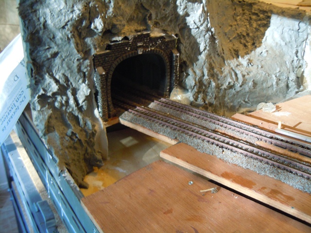

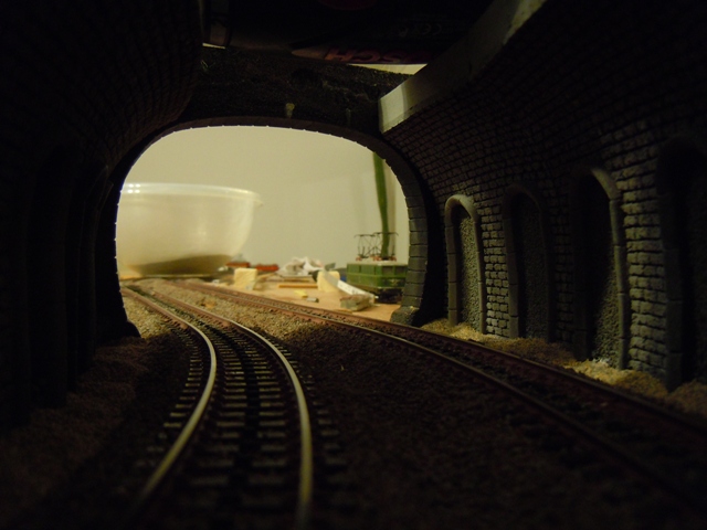

Today's progress...
I've been working on the tunnel. I used the entrance from my old lay-out. Combined with some styropor tunnel walls from Noch.
I installed also some signal/switch boxes. I airbrushed them dark yellow. Nice accent amidst all the brown surroundings.
Next week I plan to build a moutain around it.
Rinus

Nice work, Rinus. I really like the tunnel liners a-lot. I made my own but I must say that these
are so great looking. Are they by Noch? Cheers,PeterThumpUp Smile

Signal boxes ? who sells them ?

The control boxes are from Auhagen.
http://www.auhagen-shop.de/prod...ucts--control-boxes.html
They come in a set with cable ducks. They cost around 8 Euro.

I spray both sides. Thats four sides per track. Quite a work actually.
Rinus

I think airbrush is a preferd option above painting. Airbrush applies a much thinner layer of paint. with a pensil you will lose most of the details. I'd also advise you to use a water based paint. Its easier to remove afterwards.
I've bought a Badger 150 with a fine needle and nozzle. A line of 5 mm can easily be achieved. Nevertheless its important to protect the surrounding ballast with tape. Its quite difficult to make a straight line and mistakes are easily made.

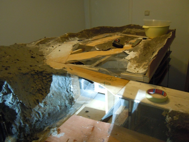

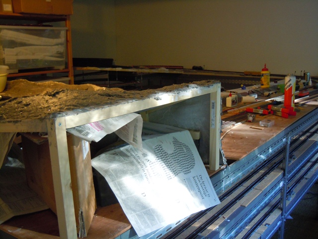

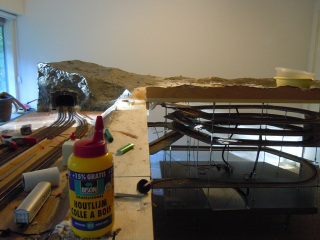

Hello my friends,
Yesterday I had a liitle help while constructing the mountain around the tunnel exit. As a result we were able to complete it in a day!
We started building a woorden frame, after that we attached the meshwire and plaster cloth. The moutain was finished with a thick layer of paper-mache. This will need to dry out for some weeks.
Some pictures of the results!
Frontview seen from the station. The way leads to the future village.
Here I plan to construct a small water dam, with a lake behind it.
Out of the tunnel exit, a bridge is planned, to span the rivver.
Interior of the mountain.
We also have a new visitor. The Lux tird rail cleaner! I bought this to deal with the glue on the puk's after ballasting. A more detailed review will follow. No chance to test it propperly yet. Looking good, istn't it this Lux cleaning train: vacuum cleaner, grinding and third rail cleaner. Maybe I'll buy a polishing wagong to complete it. BigGrin
Hope you enjoy.
Rinus
thanks 2 users liked this useful post by Rinus

Long time since my last post. Problems with Windos 8 and a new computer kept me from posting pictures.
However I took my old PC and used the operetunity to conect it with my lay-out! Cool
Much hase been done:
- completed weathering the track
- filled the main platform with plaster
- installed some more signals
- installed the Lissy sensors
- started works on the small river dam
- completed balasting
- started working with Rocrail (seperate post will follow)
Unfortunately this did not went without problems. A small signal was destroyed by my clumsyness during vacuum cleaning the lay-out. Also the plaster works left their traces on the platform walls. I had to airbrush them again. Mad
Some pictures:
