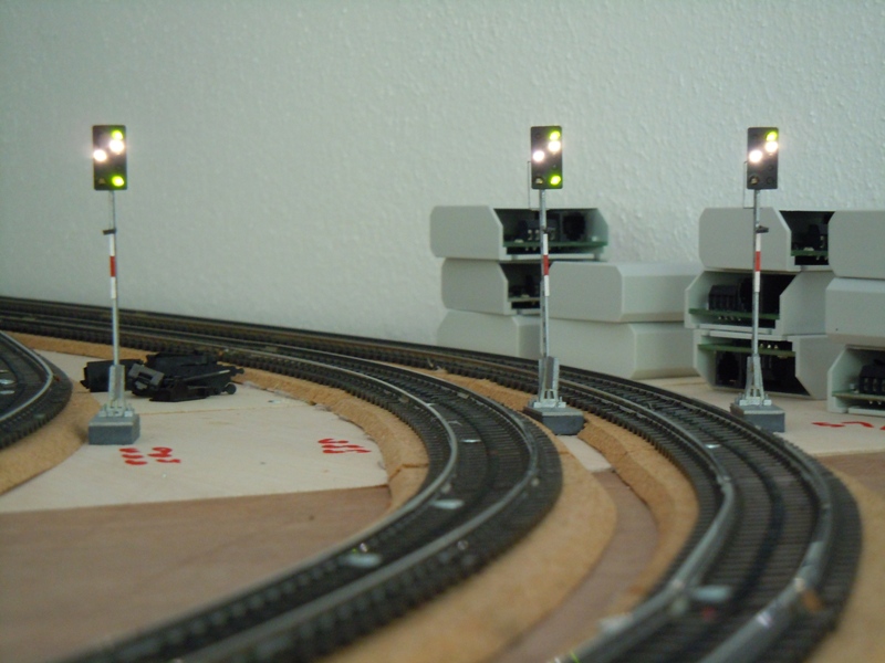

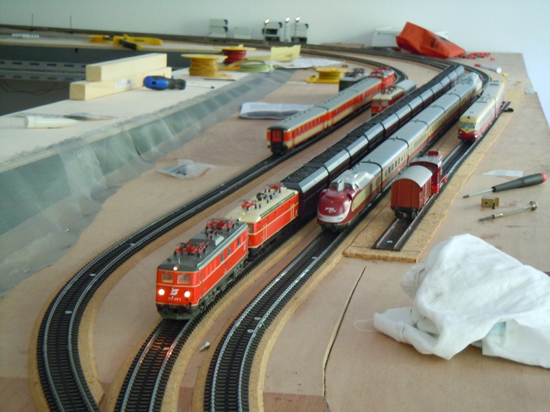

Hi guys!
Testing goes well and I allowed myself to start working on the upper works!
On top of the helix I want to create a forrested area with some water, a few buidlings and a road on which my faller car system busses can take their route.
Some pictures!

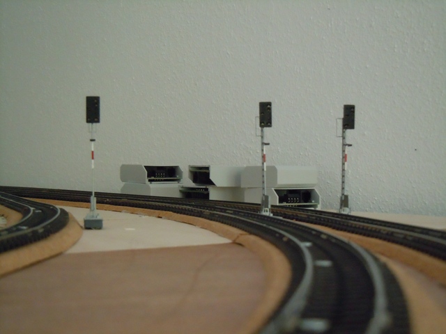

And what do you think of my Signals? They are hand made from Krois Modell. All metall.
Hope you enjoyed.
Rinus

Hi Rinus, the layout is looking quite grand. The signals are very profi. Cheers,PeterThumpUp Smile
Hi Peter!
Yes not looking too bad arn't they? Looking forward to see them working. Perhaps next week.
There is very little space between the tracks so I had to cut some cork bedding away.
Rinus

Thanks John! It al seems to fit in nicely.
More than enough room. I can house 22 3,5 meter combinations in the hidden yard. At present I've got only 14 , so there is some room for investments BigGrin
I'm now testing with a double Rh 1012 and the ACME EC89 set. Looks awesome. Only the Rh 1670 is having trouble negotiating the 3,5% climbs when I attach more than one coach. I hope some new tires will do, otherwise its quite useless.
Also some of my sound loco's with ESU decoder drive suberb with sound off, but restart every few meters when sound is switched on. Must be some CV value Cursing Cursing Confused Confused
Do you have a link of this other guys lay-out? Need some inspiration on the scenery.

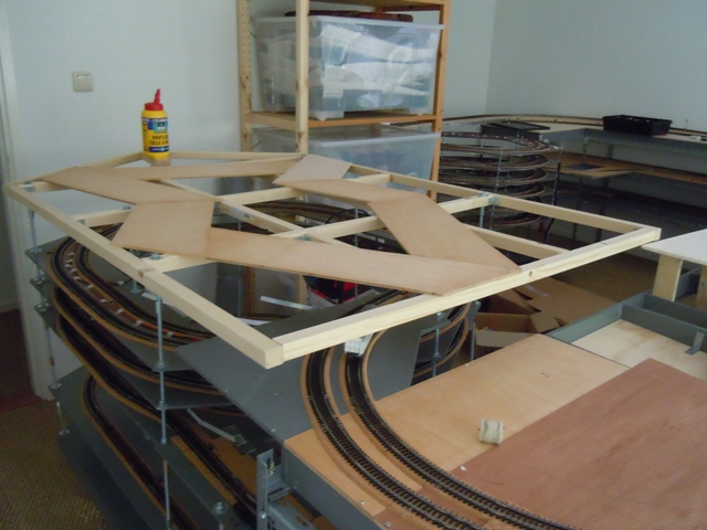

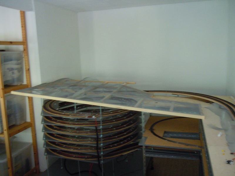

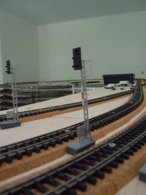

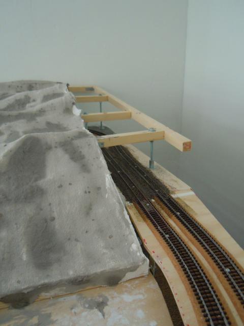

Sorry for the delay guys. I had to deal with some massive problems with my house. Huge short-cut in our electricity caused a lot of problems.
Nevertheless, I've done some work on the lay-out:
I connected the signals. This was a bit challanging since Krois had not provided me with a manual ThumbDown ThumbDown . With the help of an email and some trail and error I got them working! They are looking very good. I'll definatelly order some more.
The ones I have now have several functions: stop, slow with 60 km/h, safe, shunting.
Furthermore, I set my sights on forming the landscape on both the helix 1 and 2. I've built a wooden frame and added metal meshwhire on top of it. I'll complete it with plaster cloth this week.
And of course there was some driving! Smile
More will follow this week!

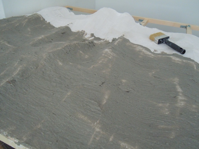

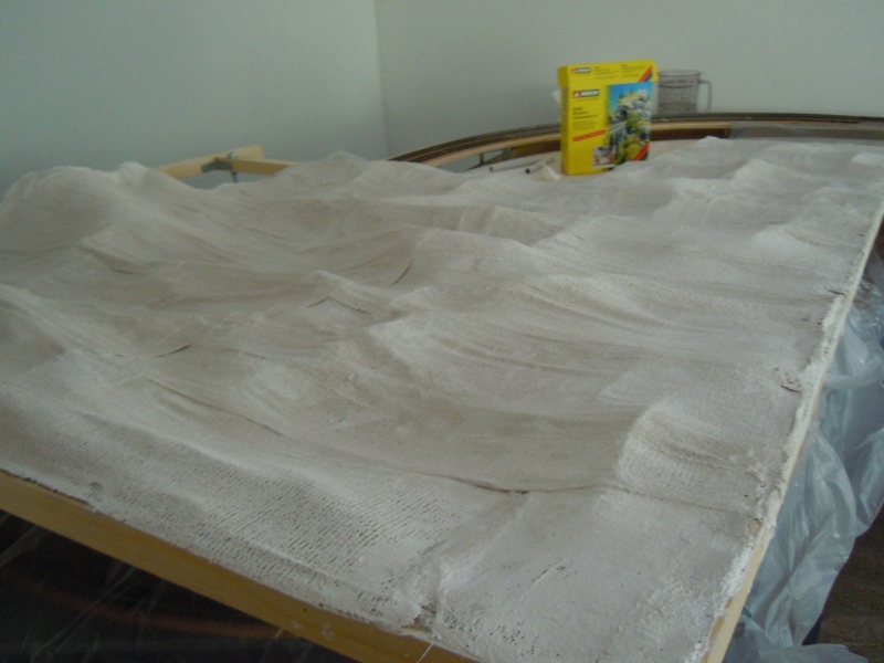

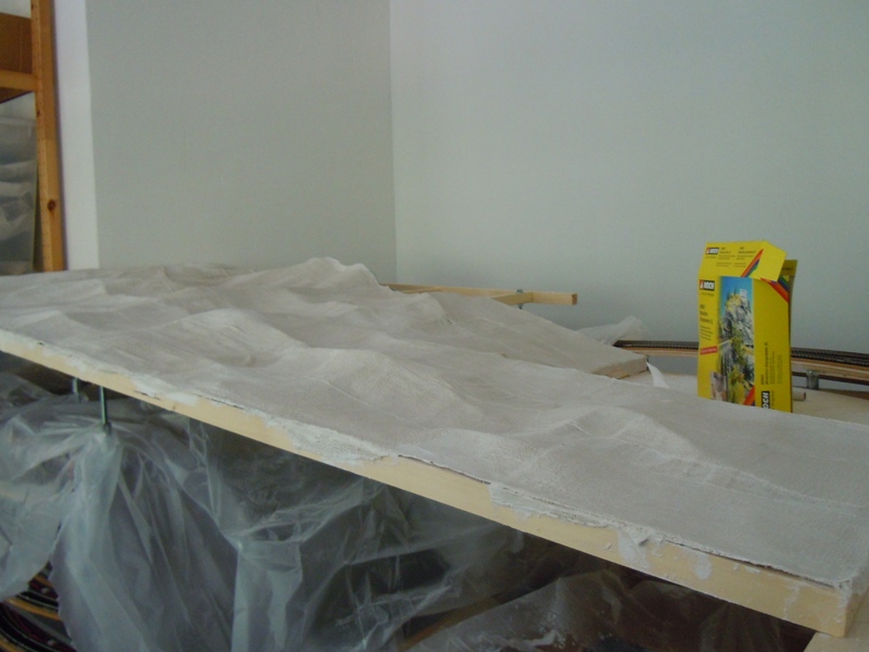

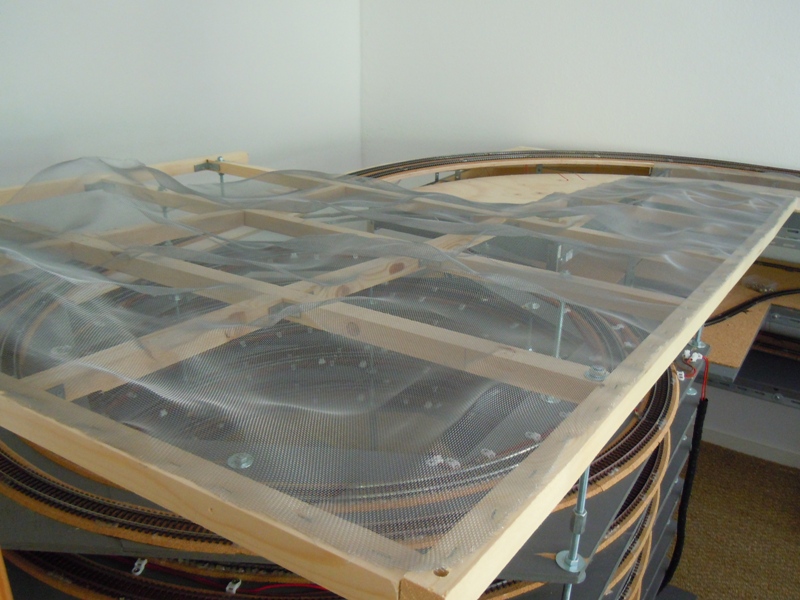

Today I spend some time putting plaster cloth on the framework.
I also prepared a bucket of paper-mache, paper pieces or pulp bound with glue, to give the surface more strengh. I'll paste that on top of the platser cloth tomorrow, since the paper-mache needs some time to get ready. I choose paper-mache instead of plaster due to its weight. Its also more flexible, which is very helpfull for my lay-out consists out fo modules. Plaster would be damaged to easily I think.
I'll show the results tomorrow.
Rinus
Offline Rinus

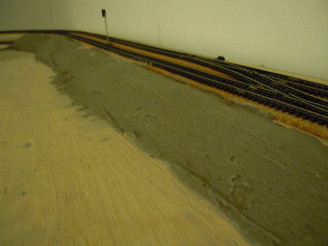

#224 Posted : 26 July 2012 21:36:52(UTC)
Rinus
Joined: 20/02/2005(UTC)
Posts: 1,573

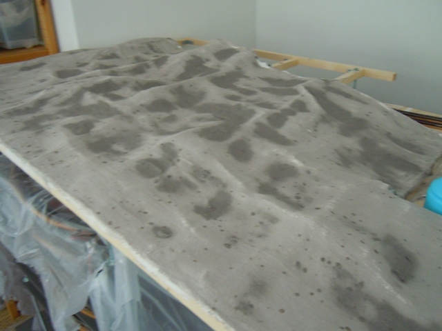

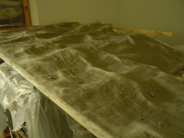

Today I continued with the paper mache, prepared yesterday.
Looking tasteful, isn't it?
I applied it in a thick layer over the plaster cloth.
This moon surfaced landscape was the result!
Tried the same without laying a plaster cloth foundation first. It was a lot mor difficult, since the meshwire lacked the strenght and the adhesive aspecst to be combined well with the paper mache.
Sorry for the low quality pictures. Its rather dark here now. I'm very interested how long it takes to dry.
Rinus

Hi my friends,
Thank you all for the encouragements. Did some more work testerday and this morning.
It took some time to get the right mix for the paper mache sorted out, but I think I've got it now. In the last batch I used 3 packages of wallparer glue and some hands of cement to be mixed with 1 bucket of paper/water. It looks very tasty again! Like oatmeal. Razz
I might add a second layer to the first batch, as this was mixed in a proportion of 1 pakage of glue to 1 bucket of paper/water. This took more time to dry and also resulted in a much thiner substance.
Its also to be recomended not to aply the paper mache directly on mesh wire. I prefer to lay down a layer of plaster cloth first.
I've no experience how it will react to paint. However being paper based, I presume it will do fine.
3rd batch
2nd batch
1st batch
For the scenery part I had this in mind. I want to imitate the St Jodok curve, which is a famous spot on the Brenner line.
I also ballasted a part which will be later transformed into a tunnel exit. Allthough I did some prackicing first, I'm not very experienced in this yet, and i found it very nerve racking!OhMyGod
Rinus

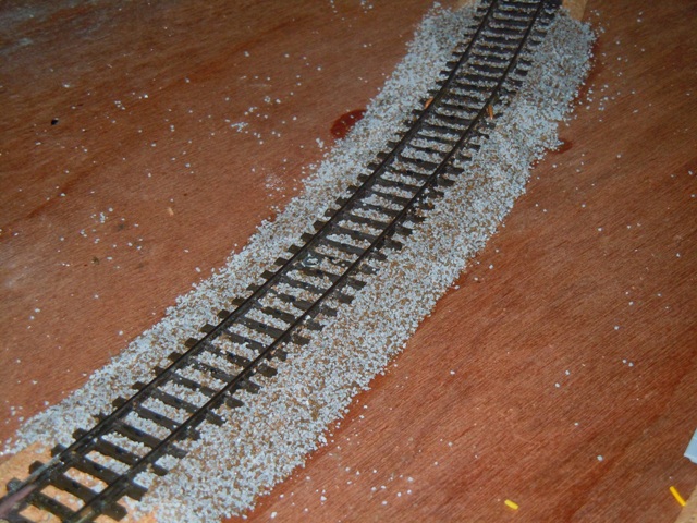

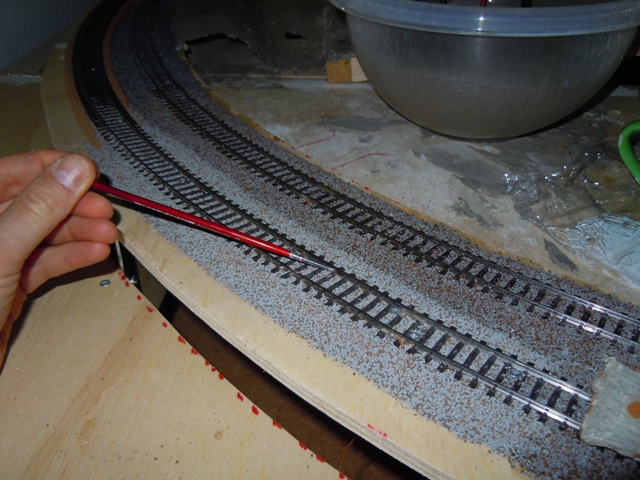

Making some progress with the ballasting. Planning to do 30 cm every evening.
It took some time to get going.
Im now using a mix of Woodlands:
medium grey (3x)
medium brown (1X)
fine brown (1x)
fine gray (1x)
As a wetting agent I use a mix of pure alcohol (Drool ) + some soap aplied with a plant sprayer. I prefer alcohol above water to prevent rust
Instead of wood glue I use primer, use as a pre-treatment before painting a wall in your house. Again this contains no water. Its also told to remain flexible. I aplie this to the ballast pipette.
afterwards I'm planning to airbrush the rails with rust color.
Some pictures of the first results.
rinus

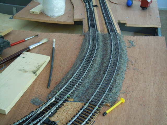

Still ballasting my friends!
Planning to buy a airbrush pistol this weekend. Need to weather the rail and cable channels before I can proceed.
So I might as well post a detailed step by step!
The tools!
After spreading out the ballast with the brushes, take some time to get the sleepers and inner rail free of ballast.
Apply the wetting agent it with alcohol and a drop of soap. It's got to get very wet.
After using the wetting agent, the color gets a lot darker . There for set a marker to mark the line between the section which is dry and the section which is in process. Its hard to see the difference otherwise.
Glue! Mix it with alcohol and aply in smal drops. First the inner rail and then the outer sections.
The result after 24h of drying.
Rinus

It looks very Profi, Rinus. Of course, ballast has dark as well as lighter colored rocks in it.
PeterThumpUp Smile

Looks great, Rinus! And it will look even better after you weather it with the airbush. By the way, what are your plans for catenary (or did I miss that elsewhere in this thread Blushing)?
Marty

Nice job on the ballasting. By experience I know it takes a pretty long time to finish this task, but you will be rewarded by how fine your tracks will look at the end of this process.
I am just curious: do you have any problem with the studs of the third rail? When applying the glue, ( I personally use an eye dropper), there is always a small layer of glue that drys on top of the studs, despite all the precautions I can take. This thin film doesn't allow a perfect contact for the loco slider, and I have to clean the studs with alcohol or I use an hobby knife and scratch gently each stud. What is your experience with the studs and the ballasting process?
Keep the good work.
Pierre

a hint or two: for faster results.
I use a toothbrush to get rid of exess ballasting and use purely a spraygun to do the ballasting, 50% woodglue, 50% water, 2 or 3 drops of detergent (per liter).
the end results are without cork underlay: the track after many years gets a bit rusty and the middle contact tongues are slightly oxidiced (shouldn't happen with the stainless steel connectors).
with cork underlay: the excess glue is absorbed by the cork and the track connecter, tongues are as new.
regards.,
