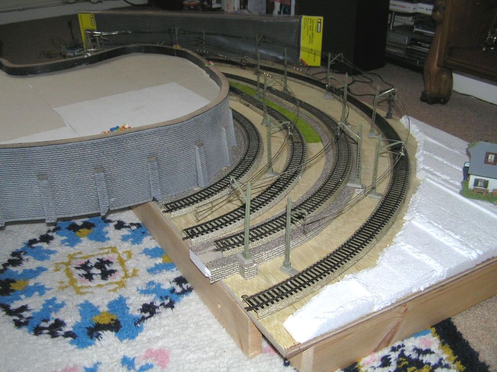

Nice organised wiring, thanks for the pics. I notice you use D computer plugs, 9 ,15 or 21.
I also notice your use of the Marklin connector pieces (the older ones), for which you have allowed ample room for plugging/unplugging.
I made the mistake on my layout of putting the connector strips (newer type) too close together, and as a result, have too little space to use all the connectors available. I am unable to shift them, because of touching fixed current connector pieces between modules (all 8).
HO Scale - Märklin digital DB ep III, C Track - other 2 rail HO scale models (US - N&W and Australia - Queensland) - English LNER/BR Hornby Dublo 3-rail - a few clockwork items O gauge Märklin and Hornby.

After all the discussion on the plugs to use between modules in another thread of mine, I tried other options but found the D plug to be the best. I have 9 pin for the outer track live and earths; the rest go through a 21 pin D plug.
I have found the 7209 a very useful piece for gathering auxilary live and earths together and linking the circuits.
