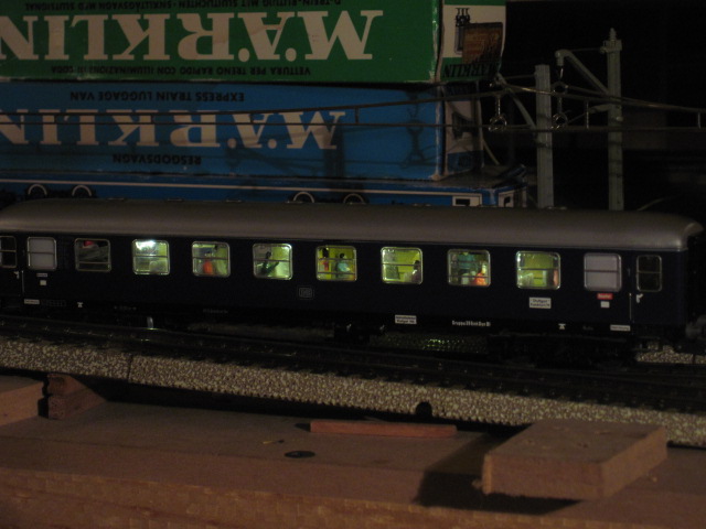

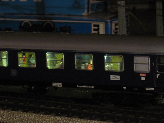

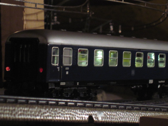

Done, i have installed one insulated 7077 and of course it works ok, not much work really to do the insulation..at the end it has turned to be far more "elegant" since i ordered also from trainaidsa some accw feeders, i have planned to mount four 7077 for each car to have more even lightning. Now to work and in the afternoon i think i will complete at least one car and take some shots to show the results.

ok, always there is more work than you thought, but, here is the first coach....
coach1
coach2
coach3
Tomorrow i will do my speisewagen.and i will be out of leds...Mad burnt some in the whole process...
